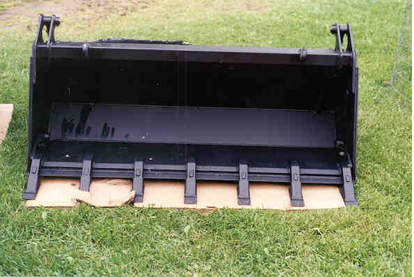

I paid $1,370 for my 4in1 bucket which included all hydraulic hoses. See pic attached.
...Bob
   / 4 in 1 bucket for 430 loader #6
Did it come with those teeth or did you add them?
   / 4 in 1 bucket for 430 loader #7
No....bucket is stand alone. Toothbar was extra. I believe I paid $266.
...Bob
