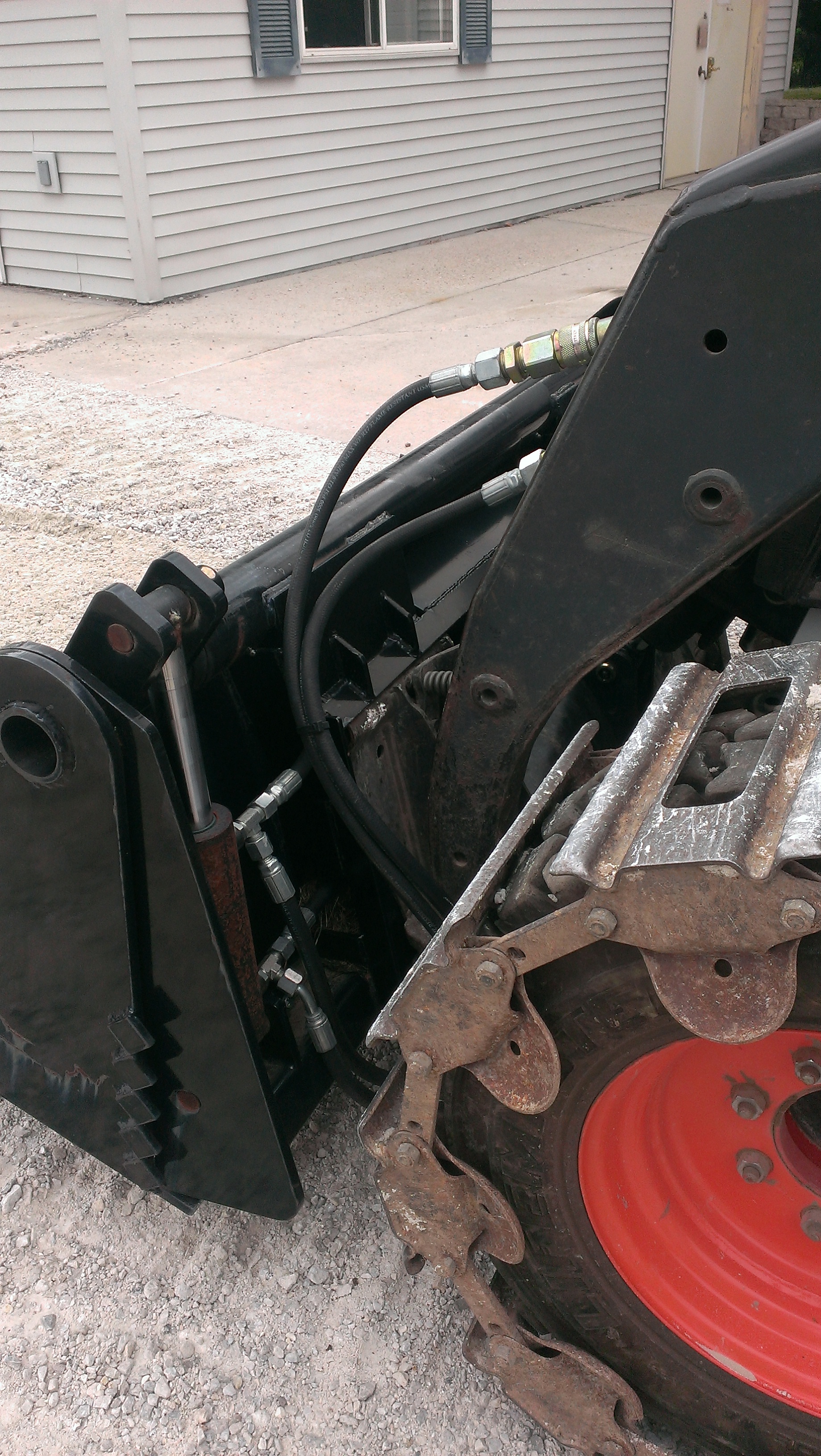

So, what is everybody's thoughts on how to route these hoses. Cause the way it is now is not going to last long. In the short term I am leaning towards just rotating the t on the bucket, such that they face up. Then I need to figure out a way to keep the coupler from sticking out so far.

I would do that, rotate the tees up and shorten the steel tube that holds the quick couplers.

At first glance I thought that would work. Issues is the hose need to connect at the pivot point. When they are up higher and the bucket tips forward. there really out there in the wind. I am leaning towards a 90 on the end of the hoses right at the couplers. Then mount a loop that the hoses would go through on the outer side of the lift arms. then I just have to figure out how to get them to fold up when the bucket is curled all the way back, and not get pinched between, bucket and lift arms. The other issue I have is I need to slow it down. I got a real good deal on the bucket, so...... this isn't bothering me too much yet. Thanks for the response
