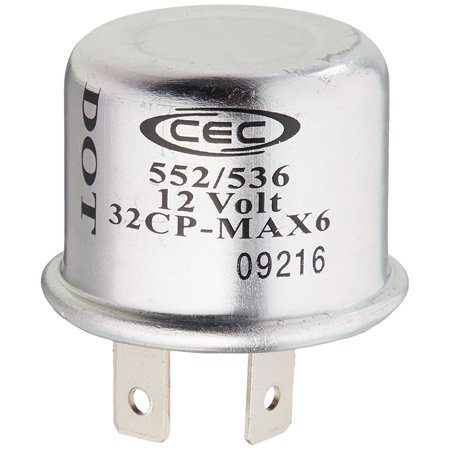

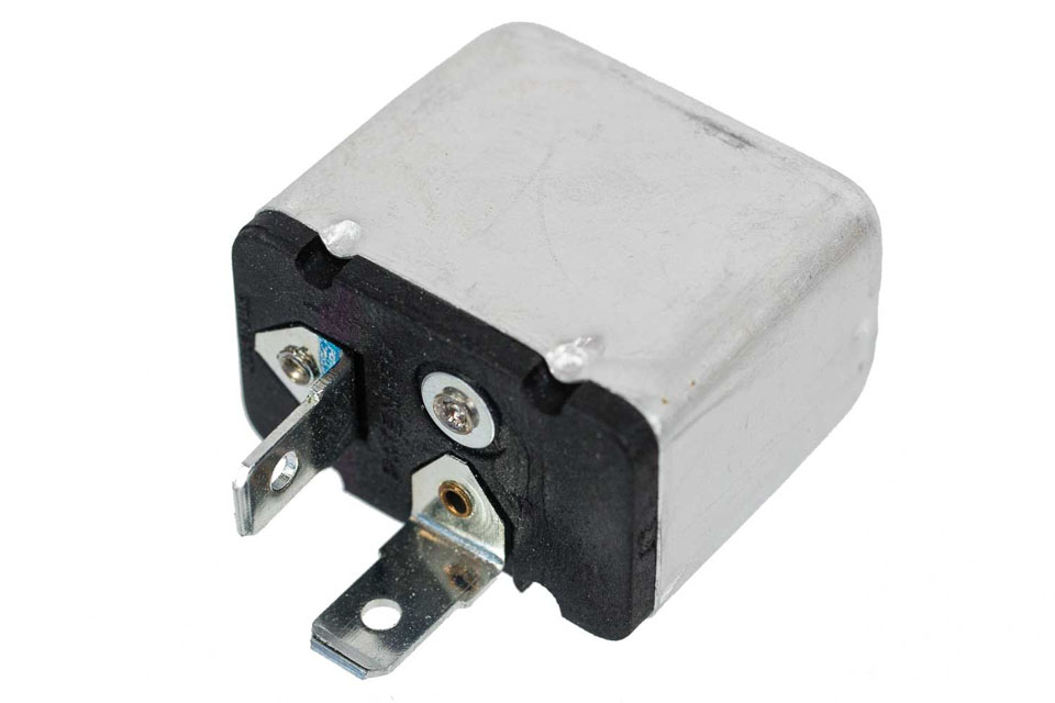

2006 JD110TLB- my 4 way flashers light but do not flash and turn signals do not work- wondering if a flasher could be the problem and where it is located. thanks
   / 4 way flashers and turn signals #2
If your recall vehicles made prior to 1986, the flasher=relay is a metal round can under the dash. After 1986 till early 2000, it was a metal narrow rectangle box in the fuse relay box. Bet your machine uses one of those too. Today, vehicles just use the block block 3 leg Omron rely.
Any flasher over 3-pin is for LED arrangement.
