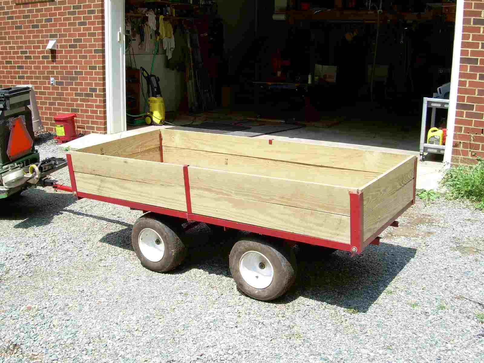

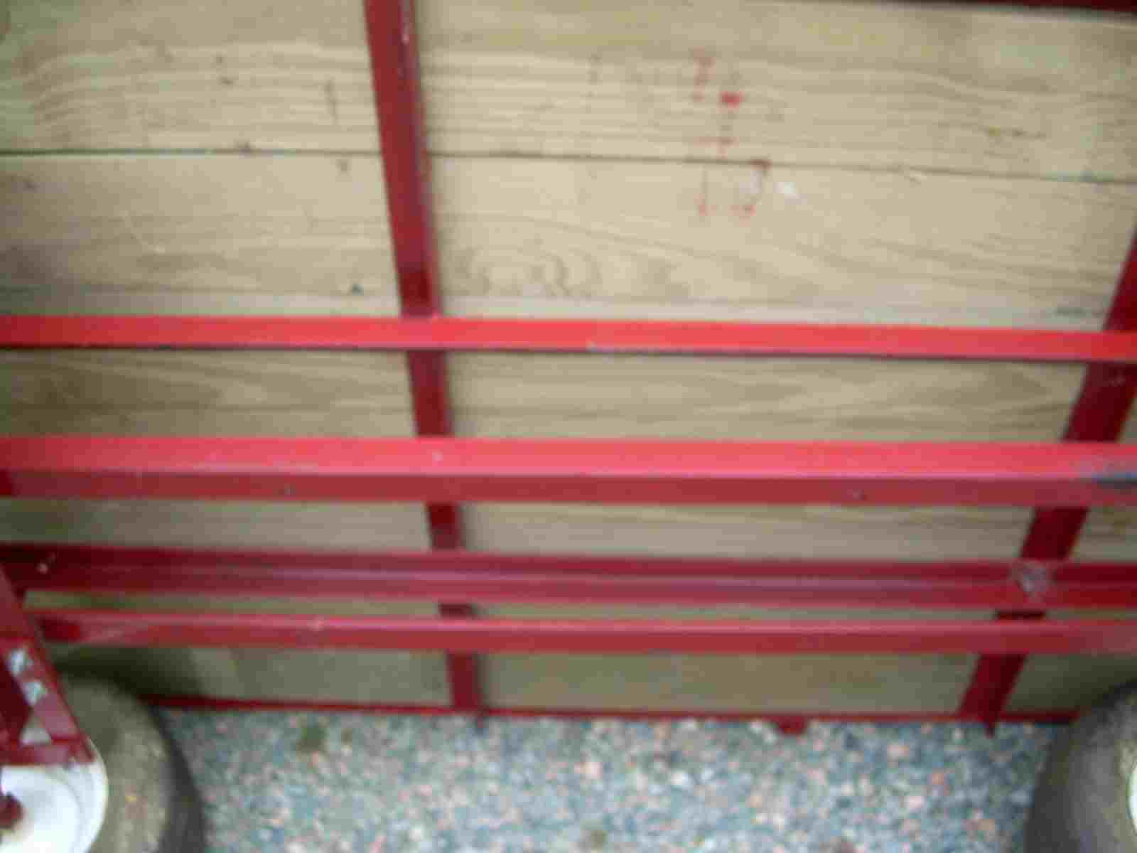

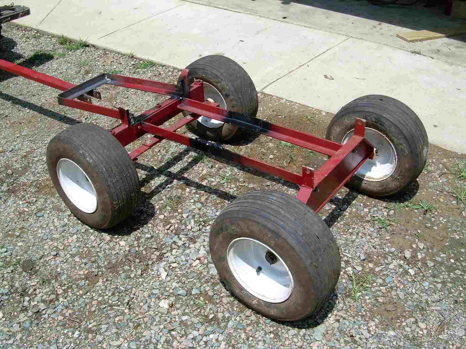

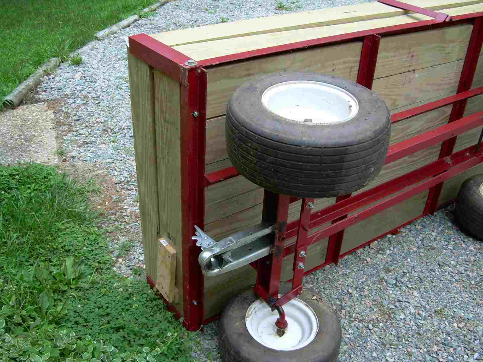

I purchased a 4 wheel trailer from Northern Handyman a few years back and found that it really did not work for me. I found it was very difficult to back up. I tried taking off the tongue and welding a trailer hitch to it. (see picture). I put this too close and the trailer would hit the PT on turns. I also welded it so the steering would not turn.
I decided to shorten the undercarriage, thus bringing the front wheels about 20 inches back. I did this by cutting about 20 inches out of the frame, and then welding the two sections back together.
I took the sections that I cut out and welded them to the front of the front axle assembly, and then welded the tongue to that.

I want to put another attachment on the front when I am moving the trailer around. Maybe a bucket to load the trailer or haul more fire wood.
I am not sure if what I made is strong enough. I am tempted to strengthen the tow bar and the front of the trailer. I should probably load the trailer full of logs and tow it around the property and see what bends or breaks and add metal to that.
