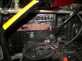

Shifter braket:
Up front on the left side about 8" from the 4x4 shifter is a access plate just behind the bell housing. The top two bolts are 2.5" apart, and right in line with the shifter making it just perfect for a bracket.
As you can see I made a bracket for the switch , I used a 1"x1/8"x9" flat steel and bent it at 1" from the end, and drilled hole to fit the soft switch, the other end I drilled two slotted holes for adjustment of the bracket.
I used the dash switch that is fused protected for the power to the light and from the light to the 4x4 button to ground.
I am using the switch as a ground brake that way if you damage the button it will only go to ground, and the light will come on, and not blow a fuse..
