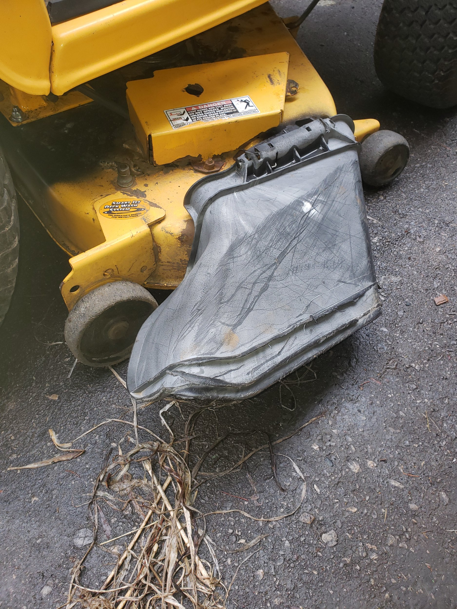

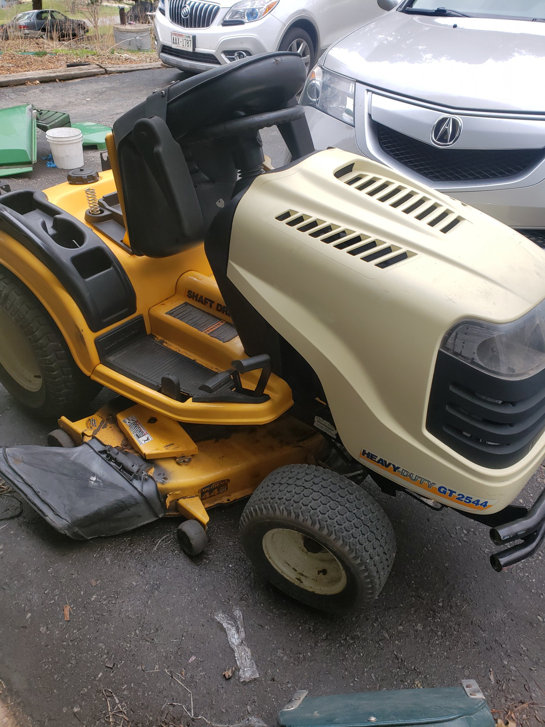

On my GT2544, I have a 44 inch (3 blade) deck. The front "wheels" on the deck are worn down and shot. I cross referenced them, and came up with 5" diameter wheels..I was skeptical, so just ordered 1 of them, and put it on..it seems SO LARGE compared to the one on the other side. I know it's worn down, but it doesn't look like the old one was ever 5 inch diam. Can anyone confirm what the correct wheel size is?

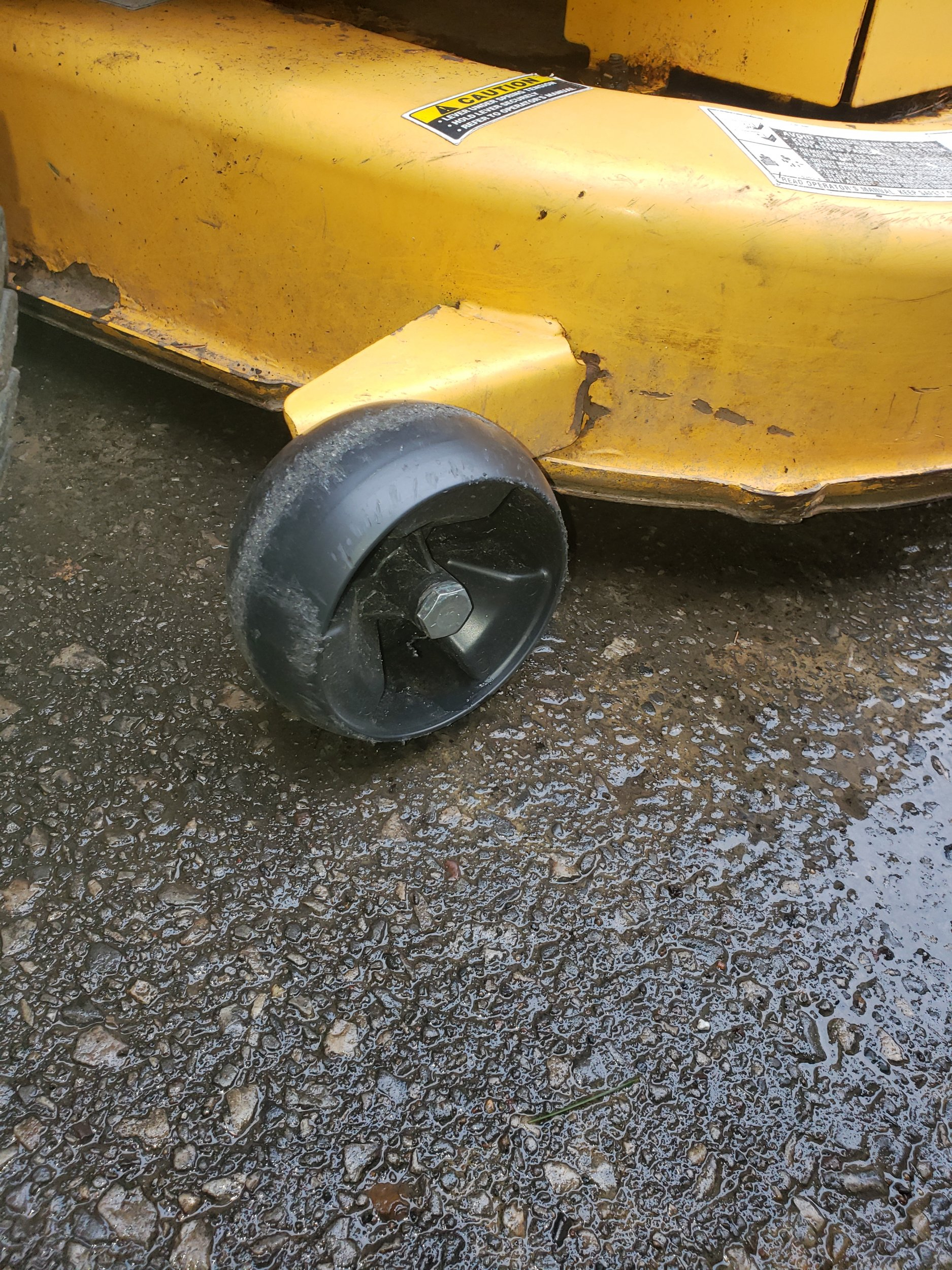

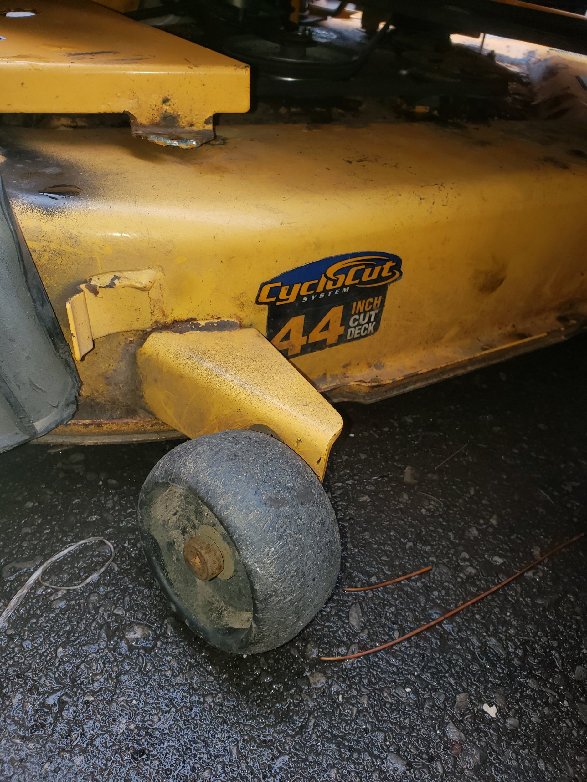

Yeah it's a 44 inch deck. But the front wheels are definitely NOT 5 inch. The back wheels are 5 inch, but I measured one of the old ones I am replacing and it's closer to 3.75" or 4" in diameter. Here's a few photos:
20220423_112045.jpg as you can see from this image the rear 5 inch wheel IS larger than the original front wheel
20220423_112011.jpg this image shows a new 5 inch front wheel I THOUGHT was correct, but it's TOO large!
20220423_111957.jpg old wheel that measures roughly 4" in Diam.

yep, I have and everywhere I look it says they are 5 inch "roller wheels" and I bought 1 to check and the 5 inch are just too large for the front of the deck..the old original one that I show in the photo is around 3.25" and I can't imagine it is just from wear and tear that it was originally a 5 inch.
