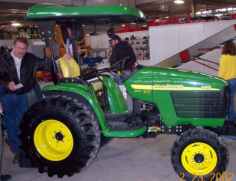

Are the 6 unused holes tapered on the inverse side of the wheel, for wheel reversal?
   / 4000/4310/4410 rear wheel bolts - please respond #32
No. The flat holes are flat on both sides. The lug holes in use are tapered on the inside also to allow for reverse mounting of the rims. The rear wheels are mounted backwards (valve stem on the inside) in the pictures I posted earlier. The front wheels have to be mounted in the narrower position to clear the front anti-scalp wheels on the deck.
   / 4000/4310/4410 rear wheel bolts - please respond #33
My 4310 has over 20 hours now with taper bolts and I constantly monitor my bolts. I have no movement yet. I have thought if I have a loose bolt I will use blue locktite. I have done some major loader work and box bladeing on top of mowing about 3 acres. I hope this thing holds together.
