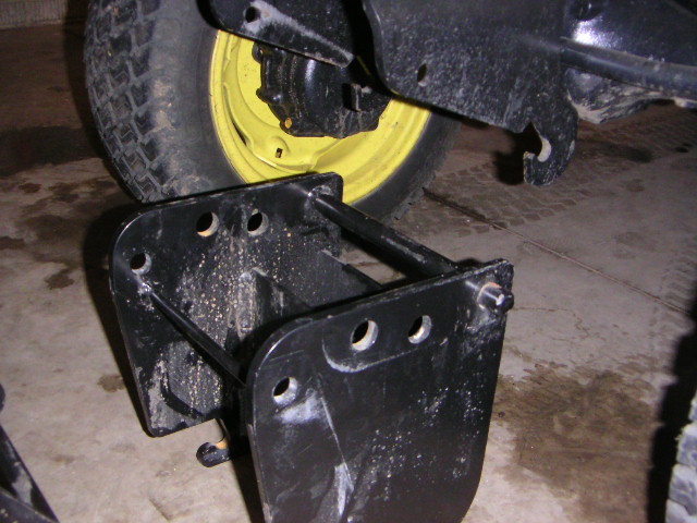

Here are pics of both attaching parts... For those who have them... do you have one or both?? The pic on the left is the quick tach attaching part. The pic on the right is the "combo" attaching part which accommodates both mower and front hitch. Thanks!
   / 4000 series/2520 snowblower help?? #26
I have both, as I said without both you have to remove the bracket on the left and replace it with the MMM front bracket which looks somwhat like the bracket on the right BUT with a bolt pattern for the tractor. The bracket on the right eliminates the unbolting problem.

I have thiis set up pn my 2320 but now that winter may finally be over I have removed the 47 blower and installed the front end loader I find the stand for teh loader hits the combo bracket and made it a little difficult to latch the locks on the FEL. I installed the bracket for the mower and found I had to readhust the front mount for the mower to tighten up the link from the mount to the mower. Also the bracket for the mower caused an even tighter fight for the stand for the FEL. Actually to get the bracket in place for the mower I had to partially remove the FEL (lower the stand part way to the ground). I installed combo bracket and everything else myself when I bought the 47 blower last fall, maybe I did something a bit wrong and now the stand for the FEL touches the combo bracket and the mower bracket that mounts in the combo bracket.
Is anyone else running into this trouble with the front attaching kit and combo bracket in place and the stand for the FEL hitting the brackets, making the install of the FEL a little more difficult?
