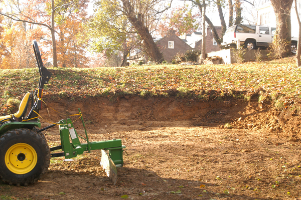

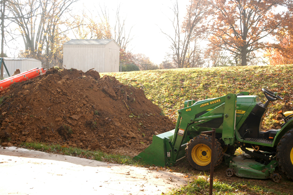

I have a 4010 with the 410 loader and back blade and m/m/m too. 146 hours. I have more loader time then mowing. This little work horse has not yet given me a spec of trouble. I just finshed digging out my back yard for a garage (see pics). I would call the dealer and get it in to the shop this is not right at all. I am sure the folks here will point you in the right directions. I am green (no pun) when it comes to the workings of a tractor, I am just a guy that sets in the seat wish I knew more. Good luck.
Roger
