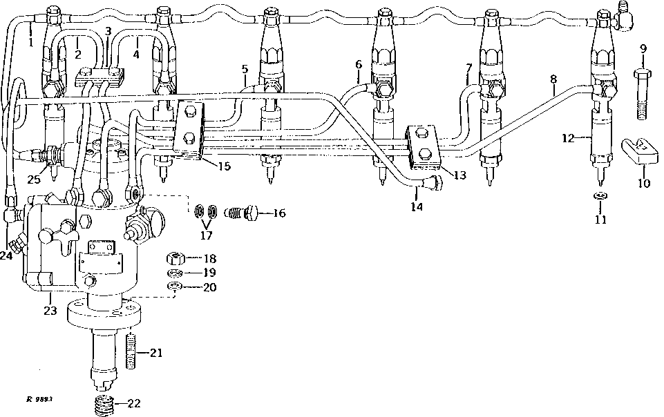

I've got a late 60's (earlier model with dash controls) 4020 Diesel. We've had water pump and cooling issues and manually make it idle at about 900 RPM minimum to ensure cooling.
Does anyone know what the idle speed SHOULD be for this tractor? It normally idles about 600 RPM.

I no longer have a 4020 op manual, but I think 800 will be very, very close to spec. 600 is low, I'm quite sure.

800 rpm is spec for these engines. Are you overheating when idling? That seems unusual. Are you trying to run something with hydraulics or pto at idle? Have you had the radiator checked out? Radiators can clog internally and not allow the proper coolant flow. I assume you have replaced thermostats?

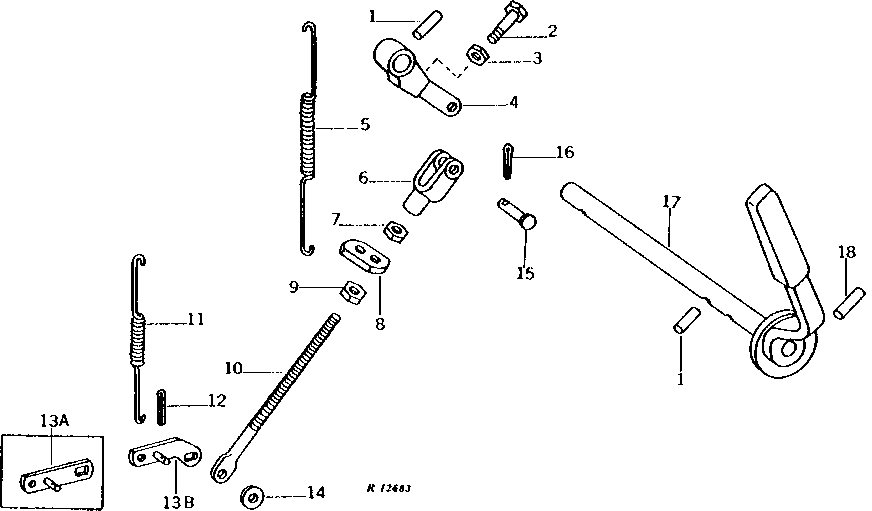

Anyone know how to adjust idle?
Also, the PTO doesn't stop when it's off. It sort of freewheels with enough force to turn a Kuhn style 9ft hay rake sometimes (slowly) and also an auger.

A 4020 diesel has two thermostats.
IIRC, idle adjustment is made at the injection pump.
PTO brake adjustment is dependent on transmission type; SyncroRange tractors may be just a linkage adjustment. Or the internal PTO brake may be shot. I never fussed with a Powershift.

The angled screw on the injection pump is the one to adjust the idle speed.(beside #24 in picture) It takes a 5/16" wrench to loosen jam nut and adjust. Screw it in to raise idle speed. If you have a powershift transmission, check the linkage under the dash. Remove the kick panel between your legs and look in the lower left side. Lever#13a or b in drawing usually gets loose or worn where it attaches the control valve. It uses a 7/16" wrench to tighten it.
