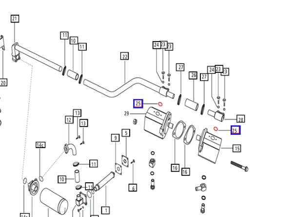

I have a 4035 HST that started having weak hydraulic issues. I was unloading some landscaping blocks with my qd pallet forks and the FEL would barely pick up the pallet of blocks. I quickly did some math and the FEL should have easily lifted the load. Once those were unloaded I was grading my gravel drive and I noticed as the box blade got full the tractor would bog down. I had to feather the heck out of the pedal to finish the drive. Parked the tractor and finished some other projects. Went to use the tractor a few days later and the FEL will raise but is very slow. Same with 3 point. Hooked brush hog up and it will not lift the cutter off the ground. I was close to a service so I went ahead and changed both hydraulic filters and refilled the tractor with new fluid. I also pulled the hydraulic / transmission strainer. I noticed there were some pretty big pieces of metal in the strainer. Still same problem, very weak hydraulics. Im at the conclusion that I have a trashed hydraulic pump. The question is which one? Part 15 or 29? 15 is labeled as PUMP Gear 8cc / Rev. and is $193.90 through my dealer. 29 is labeled as TANDEM Pump - Hyd and is $327.80. Hate to buy the wrong one and end up having to buy the other.
Anyone know which pump is which? My local dealer is not very helpful and the dealer I bought the tractor from no longer sells mahindra.

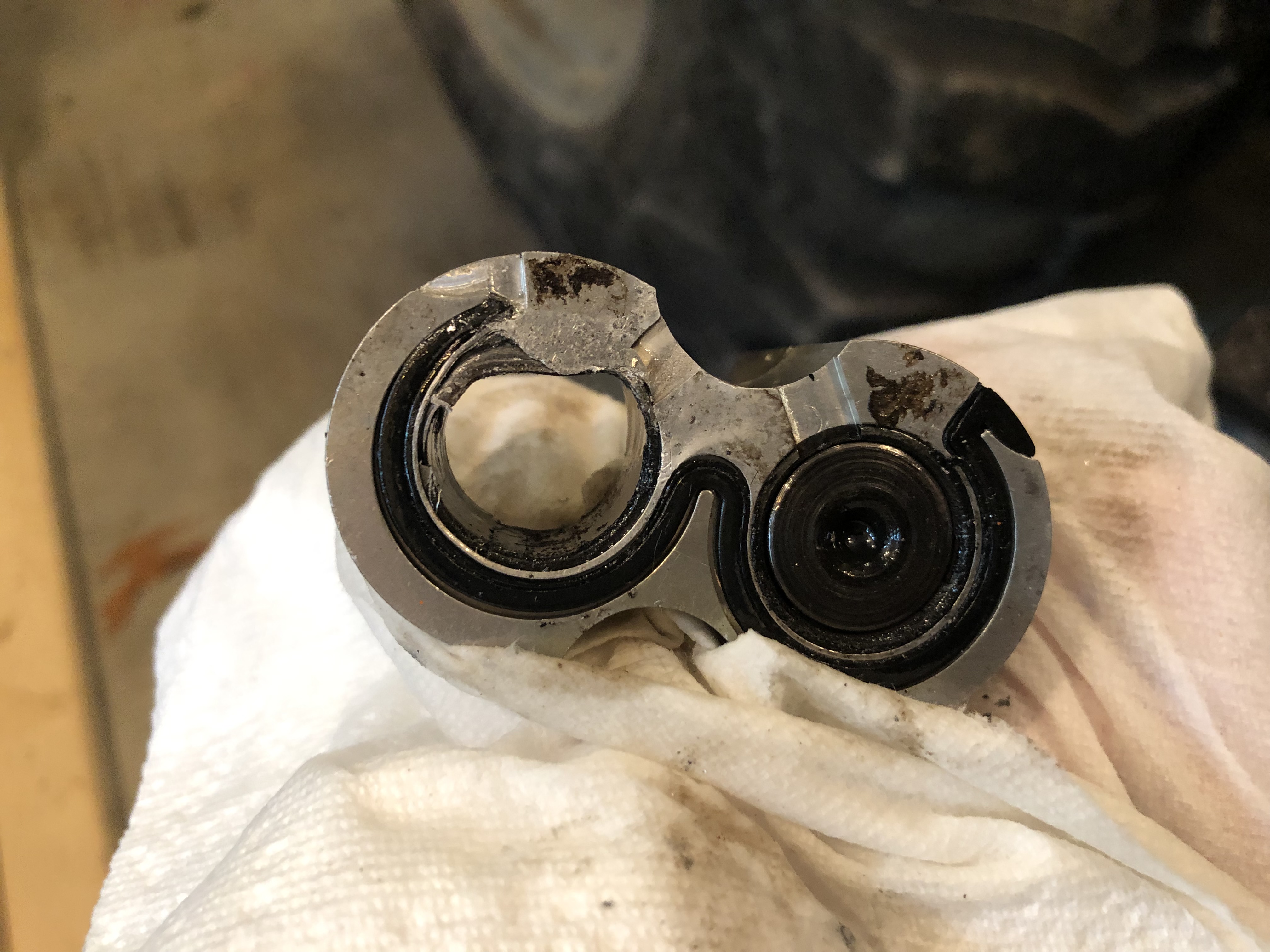

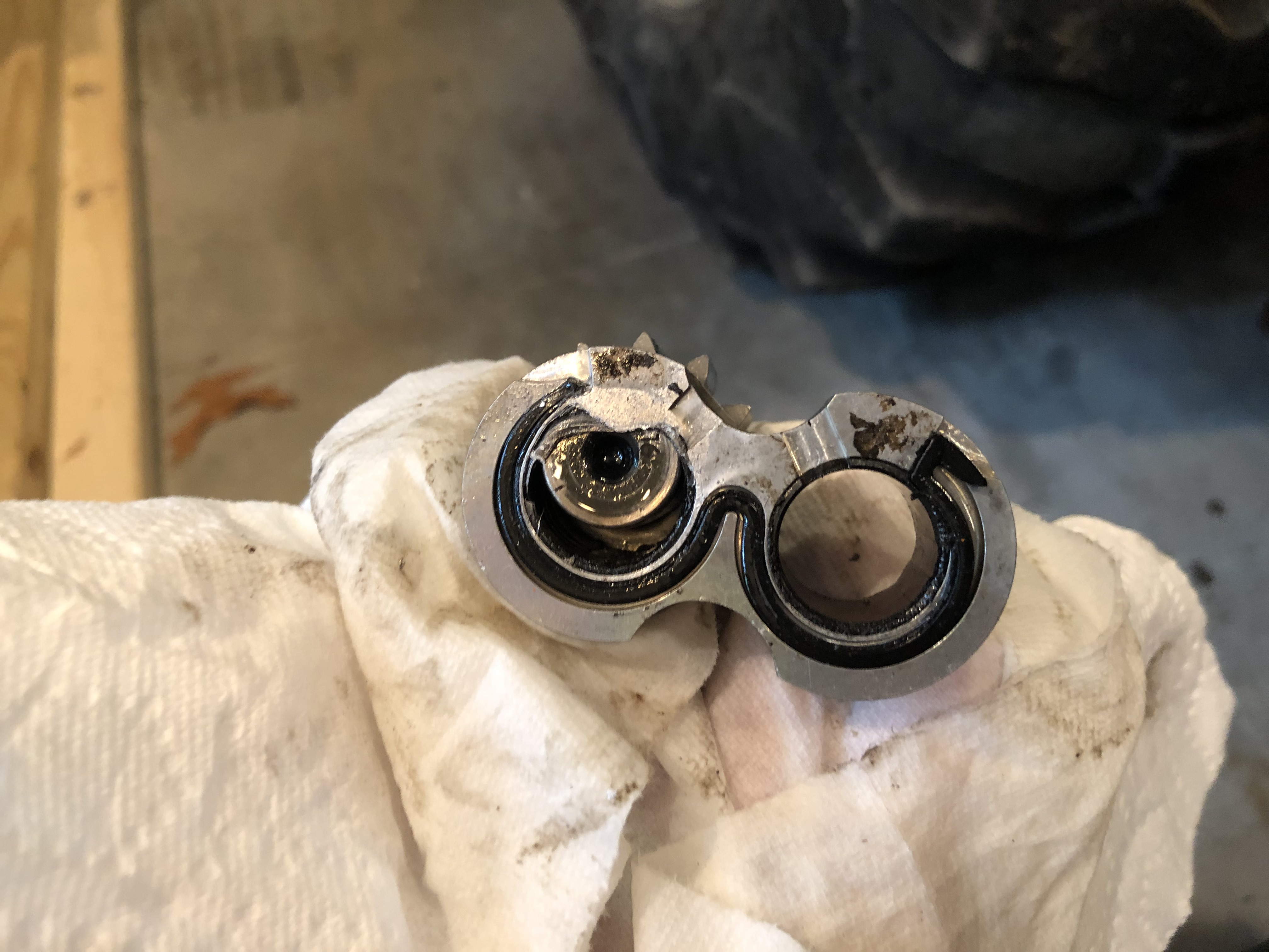

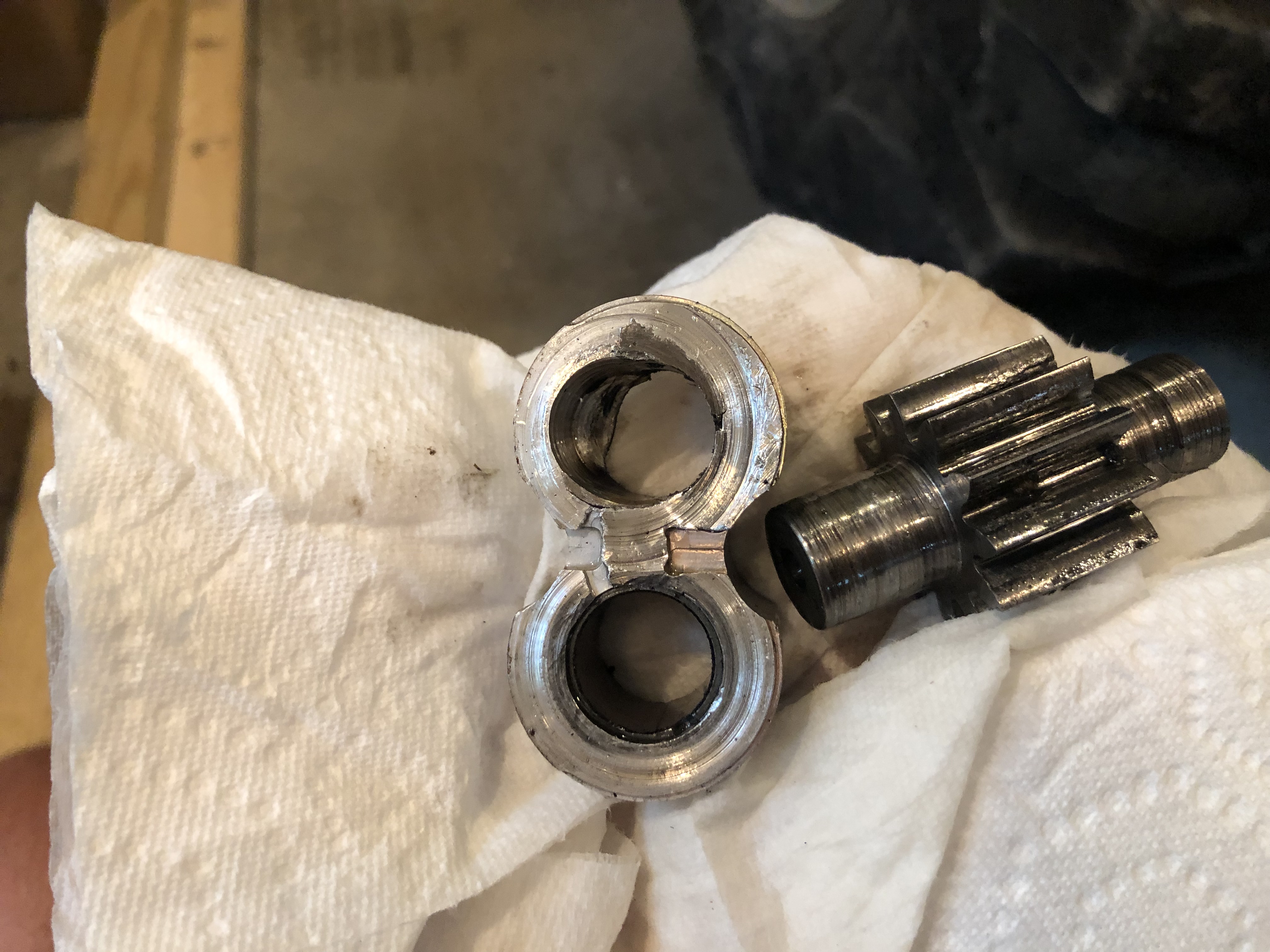

Well, before I saw the last 2 posts I had already taken the hydraulic pumps off. I have to give it to Mahindra here. I had them off in less than 20 min. 4 bolts to hold the inlet lines on and 2 banjo bolts for the supply lines. Then 2 long bolts that sandwich the 2 pumps together on the spline drive assembly. As I guessed, the high volume pump has a trashed bearing. The stupid thing is they are aluminum. It will only get picked up by a filter, not a magnetic plug. I guess now I know where all the metal shavings came from in the strainer.
I found a used pump for about 50% off a new one. Problem is I also need all the gaskets and O-rings. Would like it back together sooner than later so I can have my garage back. Oh well, off to the parts store.
