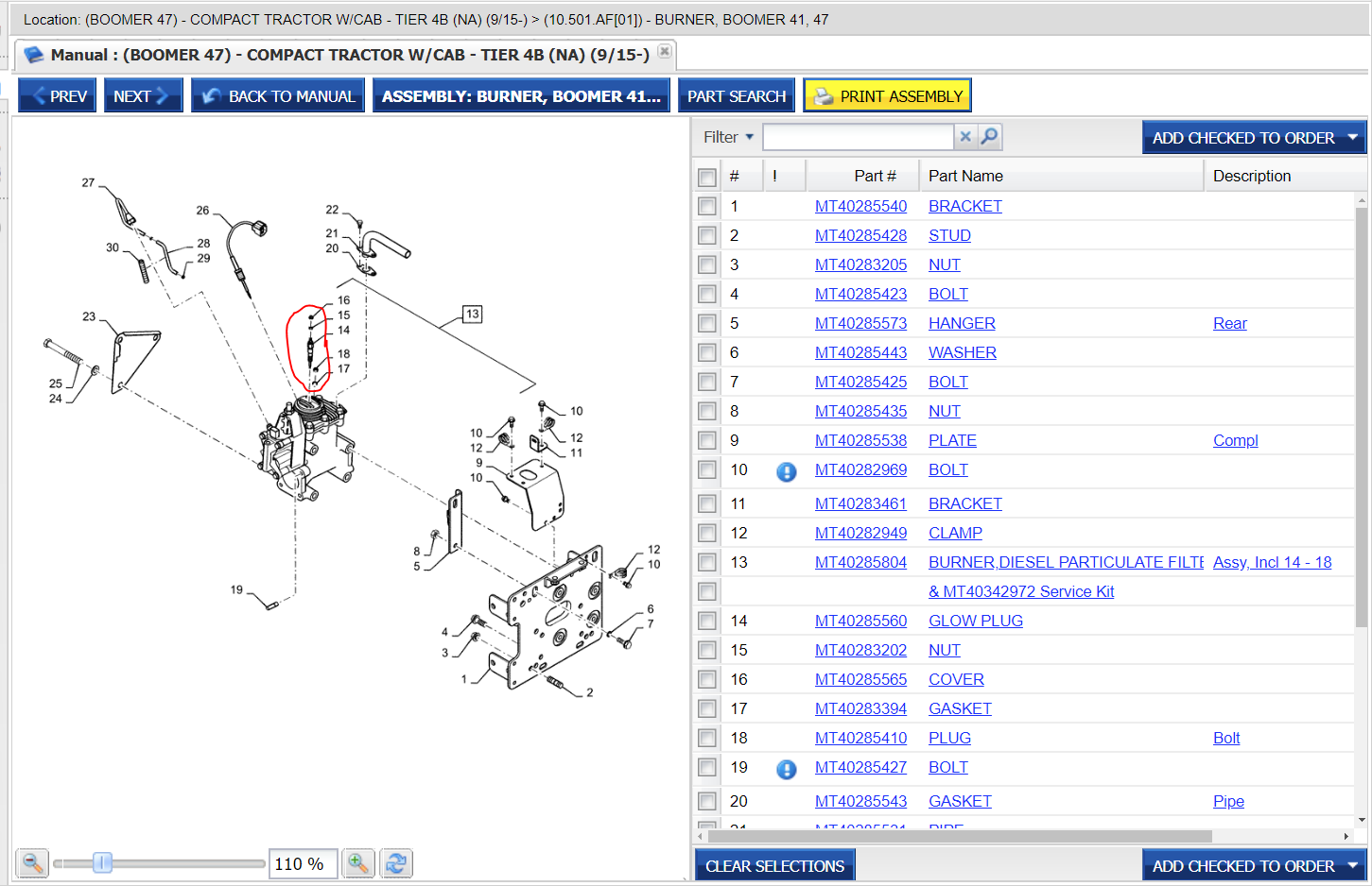

Posting in LS as boomer talk in NH forum seems limited. I am having regen issues, with flashing indicators not covered in the OMM manual. The dpf temperature light will come on and off as it tries to enter regen mode. The DPF regen light stays on, and intermittently when the templight goes out the engine warning light flashes. The regen light is always on, and never flashes, and no limp mode. I have ran it this way for a couple hours but I decided to shut it down for now. See video: Boomer 47 regen - YouTube

Anyways as an update for posterity, it was a loose glow plug on the DPF burner, causing an intermittent electrical ground. I suspected it was a problem with the burner, and the light was flashing because it wasn't kicking on. My guess is I was working it hard enough that the soot load wasn't accumulating fast enough to warrant limp mode yet.

Thank you for posting your problem about your tractor. I too had the same problem and found this forum it helped me to resolve my problem. I was able to take the hood off to get to the glow plug and tighten the plug. It fixed the problem and when I started it up it went through a full regen with no issues.

Just had it start acting up again 6 yrs later. A little bit of righty tighty to the glow plug and the regen completed.
