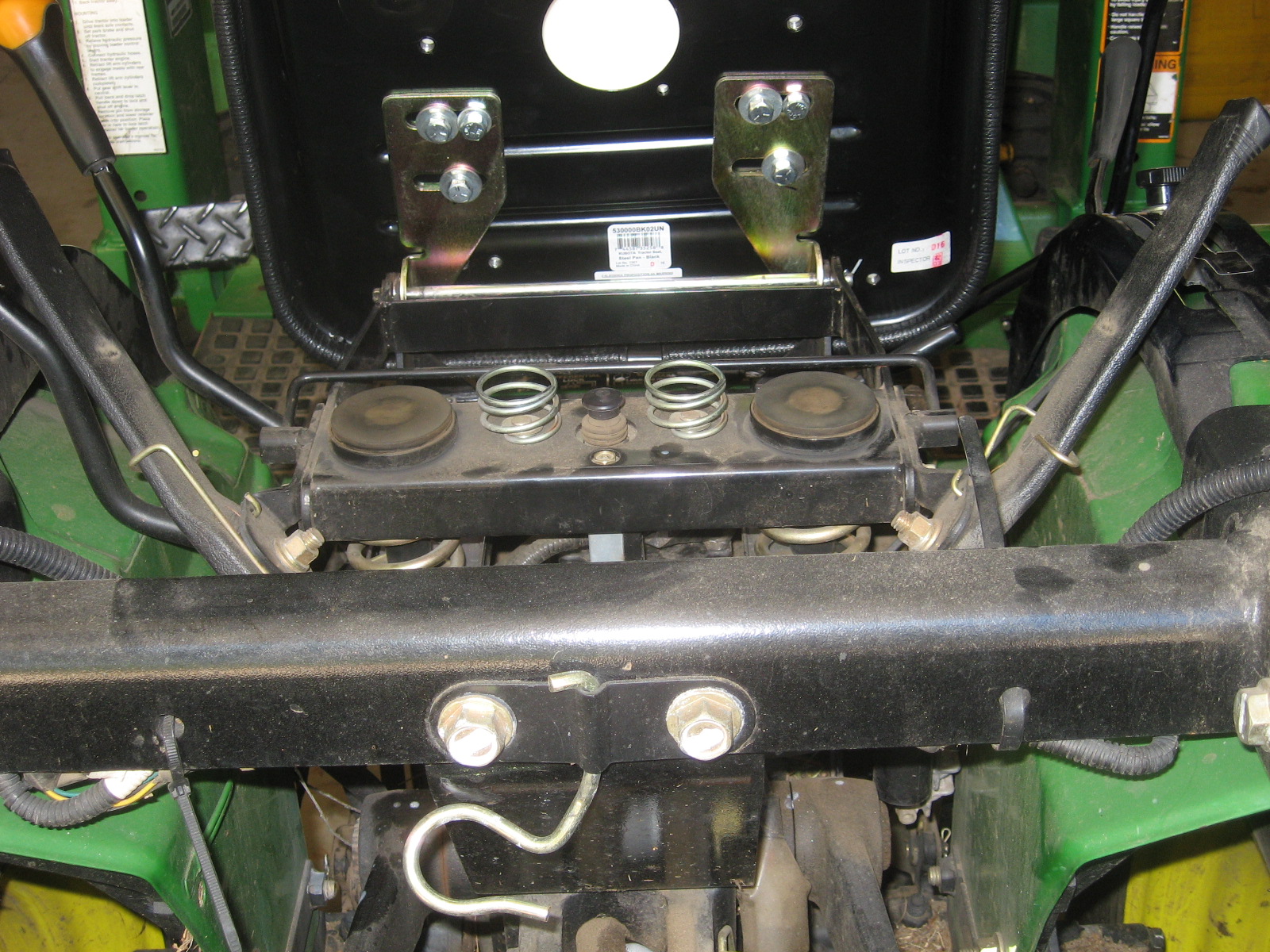

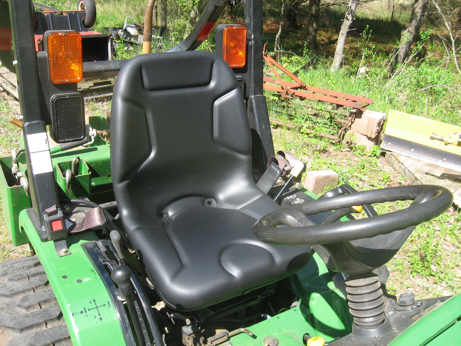

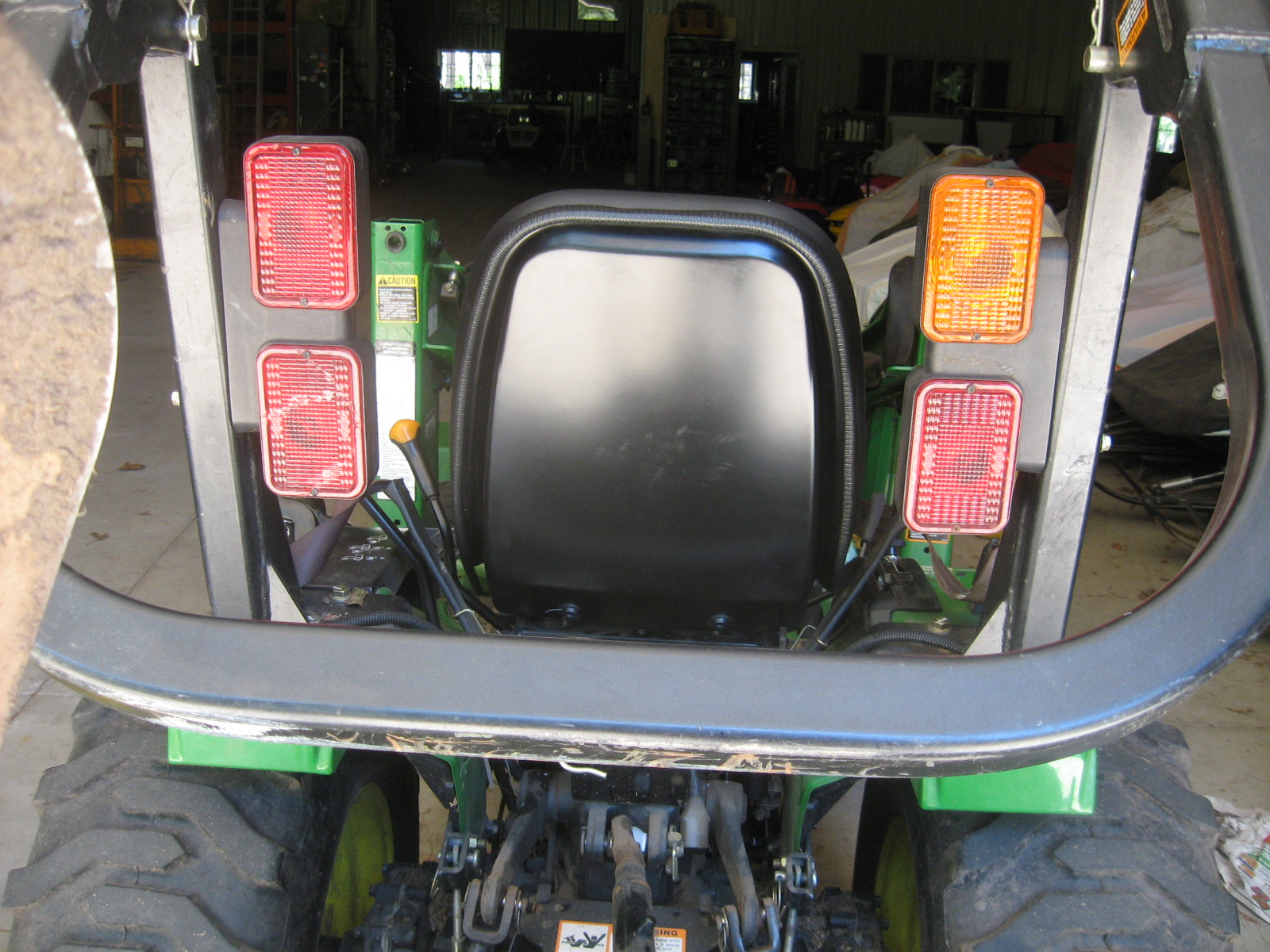

After 16 years it was time for a new seat and I wanted one with a metal seat base; a lot of the replacements out there aren't. Tried a few combos and this one worked successfully. Manufacture details are in the pics for both the seat and the low profile flip-up brackets. Thought it might save someone else the trial & error.
It's a tad taller in back than the OE, and the front has a longer lip that extends downward. I'm tall and have the seat track positioned almost to the rear of its adjustment. In this position if you flip the seat forward (like to keep rain, snow, ashes off the seat when not occupied), it doesn't quite rest against the steering wheel. Within 2 inches.

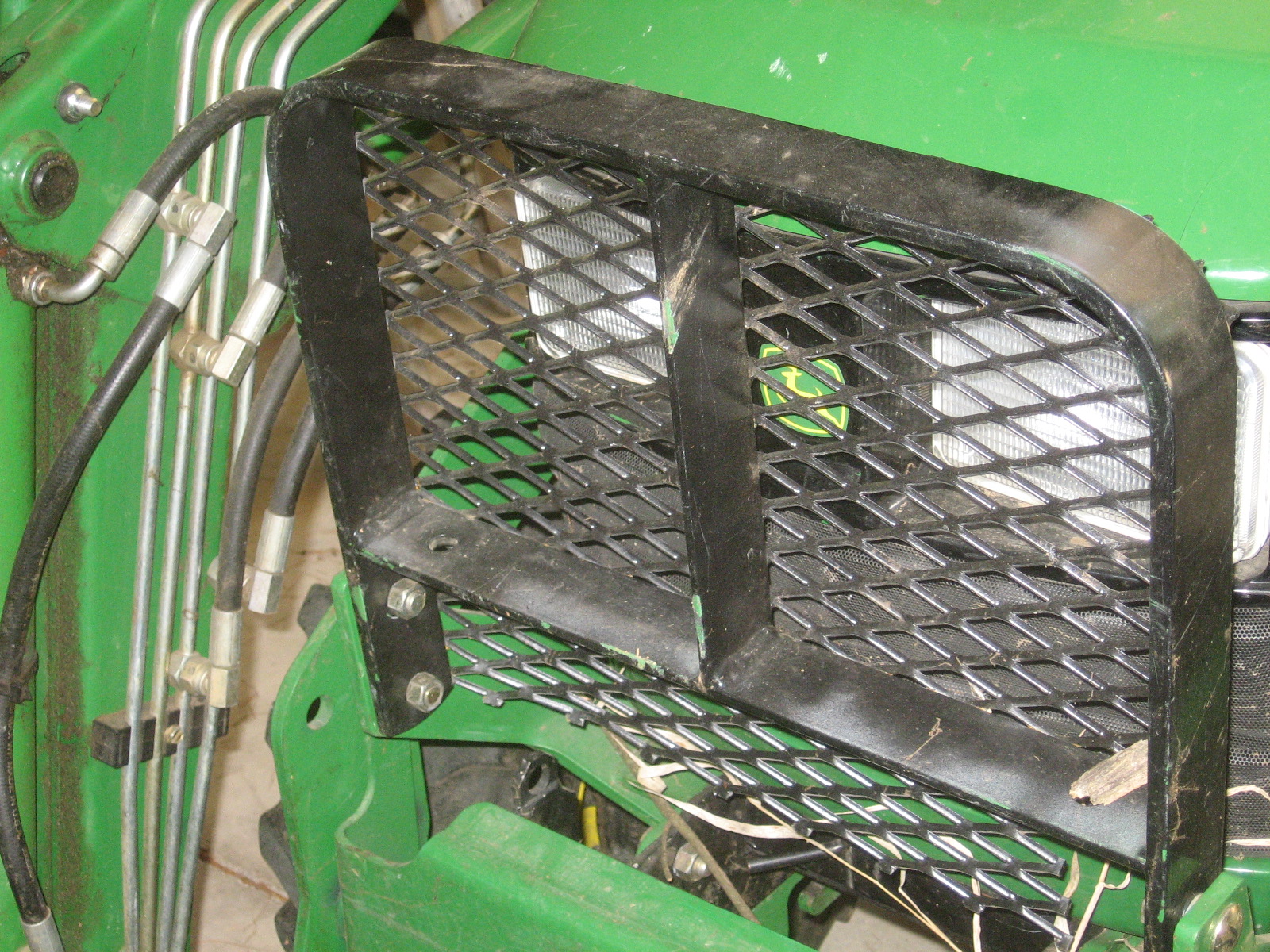

As it ages the tractor is becoming less green/yellow and more black. In addition to the seat I welded in some mesh to protect the headlight assemblies and black paint was available. Getting to be stealthy....
