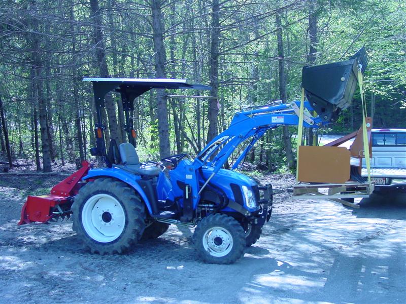

Mount some hooks on top of your bucket, get some short straps or chains and lift your 48" box blade with your 48" bucket.
   / 42 inch box blades - who else makes them? #4
awl51:
Welcome to TBN :D! I suggest you fill out your profile. You might be able to use a wider BB and not limit yourself to your bucket size. Jay :)
   / 42 inch box blades - who else makes them? #5
How about cutting down a 48" to a 42"? Maybe that could work out for you, if you have to use a 42".

If you cut down a 48" you could cut it on one side, covering at least one wheel and allowing you to get right up to the foundation on one side. I would think that would be more useful than a standard 42".
