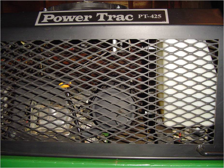

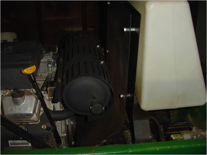

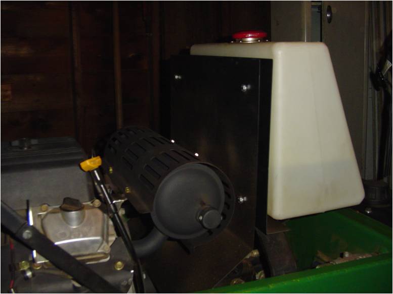

Just thought I'd post some pics of a mod I made last month. Bottom line, I'm really happy, but in hindsite, I really think it was fine the way it was. I mostly did this to satisfy my own curiosity.
-Kris

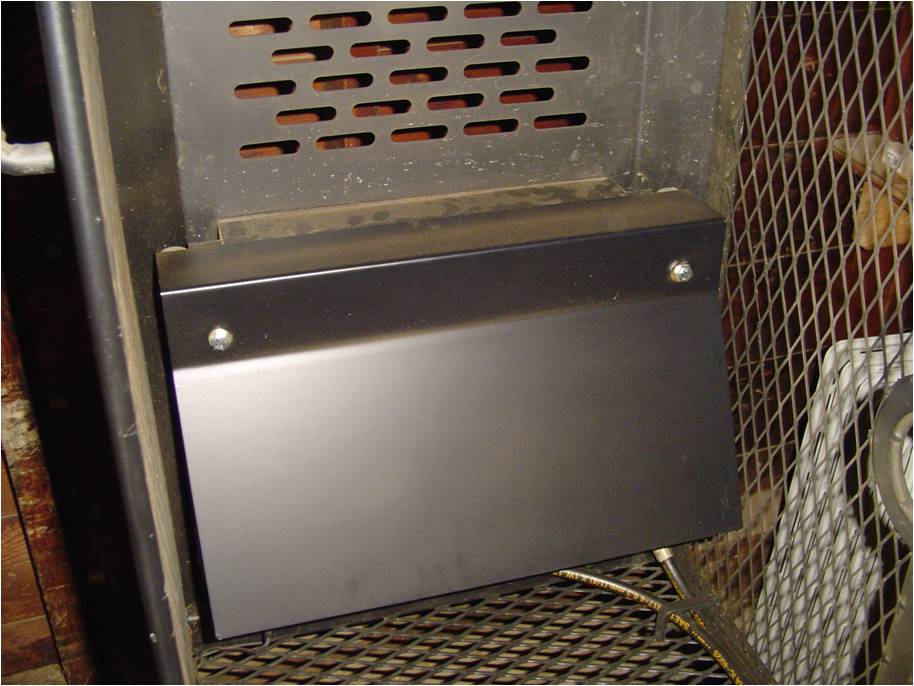

Hey Tim, the purpose of that shield is two fold...it enables the hydraulic cooler fan to only pull in air from outside the engine compartment cooling the oil as effeciently as possible and it also directs the air generated from the engines blower housing over the muffler and out the holes in the top of the cage. The first heat shield also has a bend under the muffler Shielding everything forward from heat and directing air to the backside of the muffler. there is no more run on. I do like the sound better but I cant say for sure wether its quieter.

The battery is located underneath the muffler and heat shield, similar to where it is i believe on the pt 180... im not sure where it is on the 422.

Didn't even know about it. As far as clearance between the cooler and the heat shield, on picture 2 you can see if you look carefully how its angled down to just above the air cleaner cover. At its mounting point its only 2" away...I mounted it with 2" threaded couplers that threaded to the existing oil cooler mounting bolts then simply bolted the shield to the coupler.
