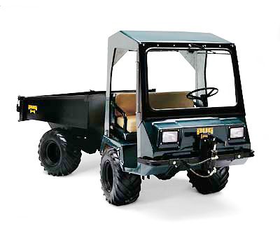

When I got my PT, I gave my Pug -- not a dog, but an articulated little tractor close to the size of the PT but with a bench seat and a stakebed -- to a friend.
He left it outside. Rain got into the ignition switch (one similar to PT's). They were sitting around having some brews one afternoon and the Pug started cranking over, trying to start.
They thought it was haunted. He disconnected the battery and it took some time before they figured out why it was doing that.

Did you post pictures of that before? A Jacobson, perhaps? If not, I'm sure a lot of folks would like to see it. ;)
Nope, no pics. I shoulda taken some. I did a google search and found that the PUG was manufactured by Bruce Manufacturing in Bruce WI. I also saw some posts at an antique tractor site about them and that the poster had been trying unsuccessfully to find pictures.
Most of them were 4WD tho mine was 2WD as it was originally purchased as a groundskeeping machine for the local college. Mine came with a cab and doors but I took those off immediately. IIRC the engine was a Wisconsin.
The best thing was the bench seat that carried two adults comfortably. In one of my early posts after buying a PT I asked what the rest of you do to carry a second person and got that GREAT pic of a PT with a saddle on the mini-hoe (wish I'd copied that pic Charlie Iliff posted but it's no longer there).
Phil
/ 425 Starter Problem Info. #7
Is this the PUG you are talking about.
