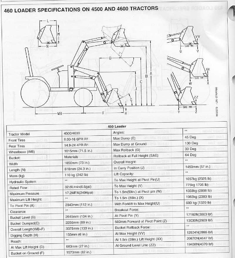

I have been able to locate most specs for these loaders at the Deere site. Does anyone know the digging depth?
I usually fire off questions, without searching first, but I have looked everywhere; its probably right in front of me...

The digging depth for a 430 loader on a JD 4300 is approx.
6" depending on tire size.

I posted this before, but here it is again. This is the full spec sheet for the 460 loader. It shows a digging depth of 6" also.

I see you have the 430, but the sheet you posted is the 460, are the specs very differant?

The owners manual covers both the 430 and 460 loaders. I don't have a spec sheet for the 430 here right now, but here are the specs that I found for the 430 on the JD configurator:
430 Loader (For 990, 4300-4400 and 4310-4410 Tractors)
61" (1550 mm) Materials Bucket
Quik-Tatch Parking
Quik-Change Attachment
Mounting Frame
Hood Guard
Specifications Meet ASAES301.3
Specifications for 4300-4400
and 4310-4410 Tractors:
Lift Capacity - 1258 Lbs.
(572 kg)
Breakout @ Pivot - 3299 Lbs.
(14676N)
Lift Height - 101.4" (2575 mm)
Rollback Angle - 30 Degrees
Dump Angle - 45 Degrees
Specifications for 990 Tractor:
Lift Capacity - 1102 Lbs.
(500 kg)
Breakout @ Pivot - 3285 Lbs.
(14610N)
Lift Height - 101.9"
(2585 mm)
