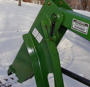

I purchased a 430 loader for my 4400. The first time i used it was today, and as soon as you lift any weight with it the back posts of the loader come right off the two square mounting tubes. Is it possible the dealer has the two side mounts reversed or are they the same? The loader goes on fine it just won't stay on once you lift any weight. Didn't get in touch with the dealer yet but he is about 90 miles away, so i would like to avoid bringing it in for service and repair it myself if possible. Also would anyone know the wrench size of the 4 bolts that hold the loader mounts on?

There is definately a left and a right to the brackets. Here is a picture of the mount on my 4300. There is a lug on the back side of the square tube which centers the loader post side to side. This lug should be located between the forked ends of the loader post when the loader is mounted properly. Something must be incorrectly installed or way out of adjustment for the loader to come off like that. Hope this helps.

I said I would post a pic, and am doing so. The two pics will compliment the one already posted.
One is of the frame post that stays with the tractor, and the other is of the latch that has to be in the hole in the slot, locking the front plate to the weight bar. If any of this is confusing to you, and you have the loader manual, by all means get help from the dealer who may or may not know (depending on his experience and knowledge, or that of the person assigned to do the setup) how to help you.
Set up correctly, there is NO WAY the loader can come loose from the frame posts.

#9
beenthere,
the picture you sent was very helpful. the posts that stay on the tractor are reversed on mine, the tab that sticks out is angled down not up like yours. i reversed the two sides and everything is fine. the dealer installed them wrong. thank you & everyone else for the help polaris
