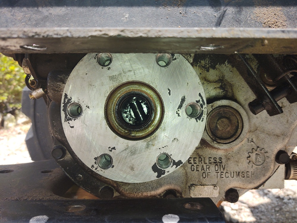

Part II is that I was having dirt dry/crust on the wheel rims so I knew I had a slight leak of hydraulic fluid so now is the time to try to fix it.
I've got the rear of machine off, and obviously, wheel off. I had already done the other side (which probably took me 3-4 hours as I learned the process..... AND figured out the tool requirements) This side only took 'about' an hour now that I had the process and tools figured out.
The target of my attention is the seal you can see where the axle goes through.

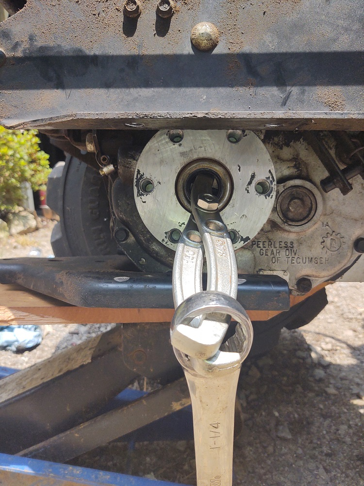

Speaking of tools, one of the things the manual lists specifically for this job is a slide hammer with two fingers to reach inside the seal to yank it out. Guess what I don't have? I DO however, have one of those removes that is a handle with a hook on the end. I forget what it's called....but I FINALLY found it in the deep bowels of my tool chest. It was a failure. Not only was it not budging the seals, it was nicking the flat mating surface between what you see above and the rest of the axle housing. So, I had to contemplate a plan "B".

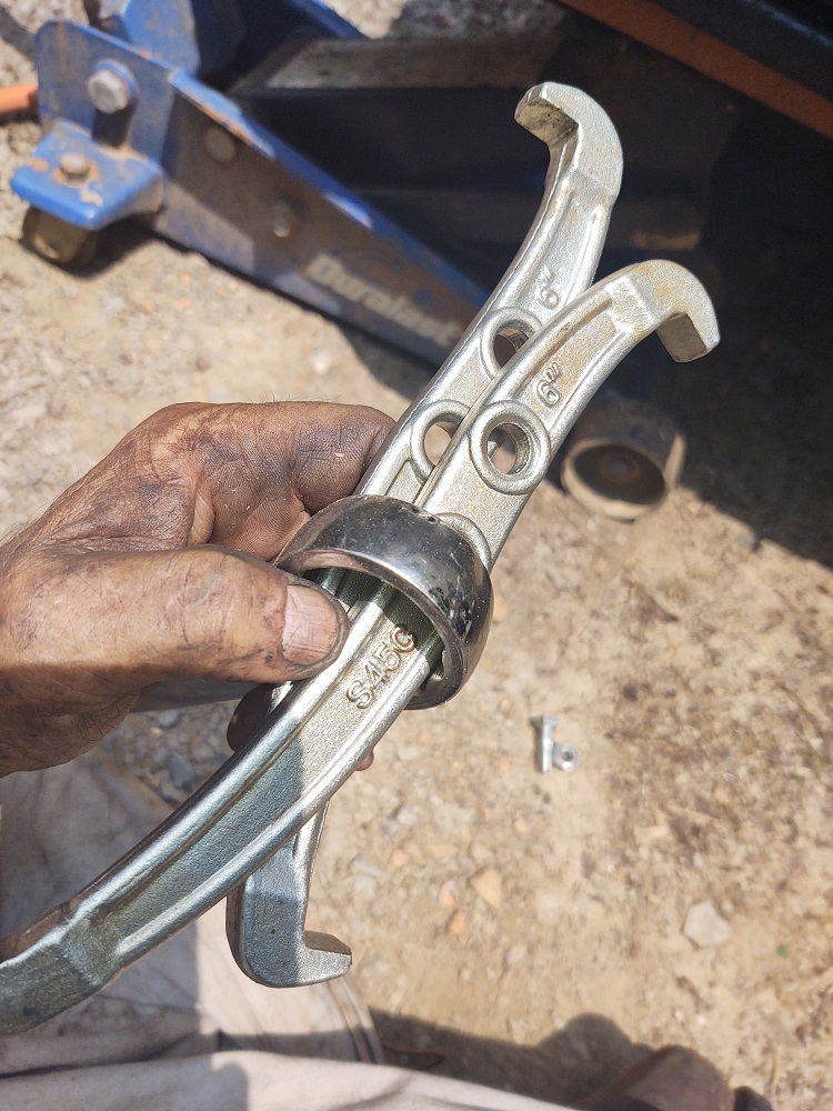

This is plan B. I've got a three prong pully puller. Found it, took two arms off. Grabbed a combo wrench where they'd fit through
Let's see....if I slide it over....nope, won't fit. I've got to wiggle them in one at a time. Now it won't fit inside the seal. I need to remove the bolt and wiggle things so I can get the hooks inside the seal and through the wrench, THEN put the bolt back in. Got it!

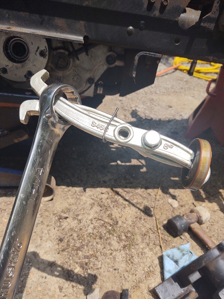

Kind of like this.... then align the hooks on the outside with the wrench and then grab my three pound hammer.
Give it about three whacks and viola! Seal is removed and I've not scarred up the flat surfaces. (spring is part of the seal that I pulled out of the way)
