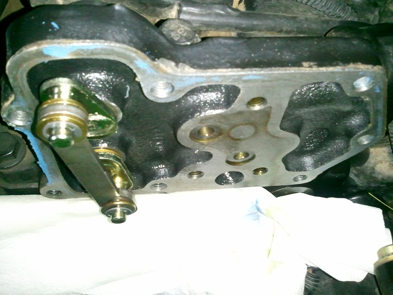

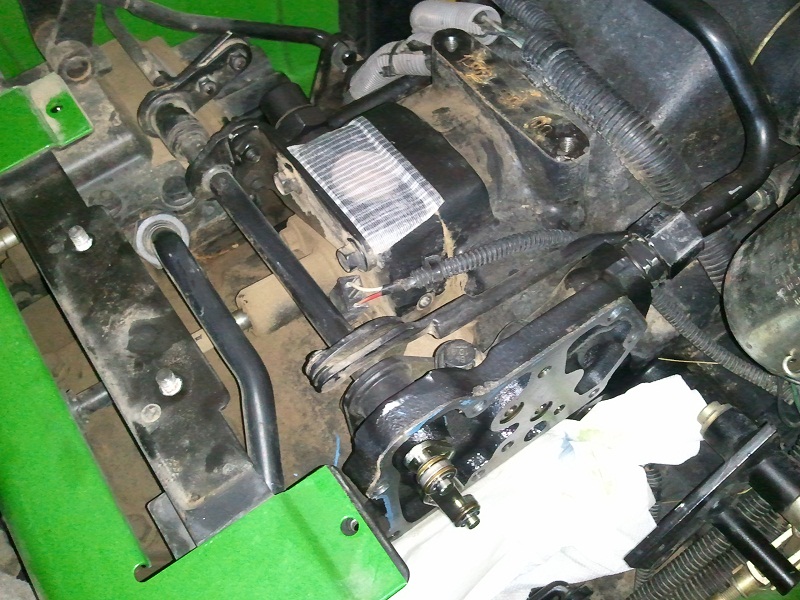

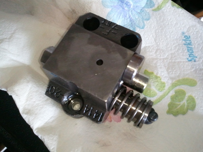

My 2000 Deere 4300, rear 3pt lift quit working altogether, was brush cutting and it wouldn't lift anymore. No noise, no hint of failure, just stopped. My loader, hydro worked good, fluid was ok.
So I started taking the control valve cover off, then the valve, found a mesh screen had lodged itself in the valving.
Luckily I found a similiar post from a while back while searching the forums. Whew.
What do you think I should do? Would like to get it fixed right.
- have the dealer rebuilt it? if so how much?
- pull the screen out and hope theres nothing else in there?
- would this screen damage a seal, I see the price is like $450 for a new one.
Has this happened to anyone else?
Any opinions would be great.

Does your tractor have the high pressure filter? If not, the culprit might be the intake screen. I had mine get too near a gear and it got chewed up. Deere fixed it under warranty. Shop had seen one other at that point. Lucky for me as it entailed opening up the gearcase, hydraulics and cleaning and replacing stuff.
Good luck
