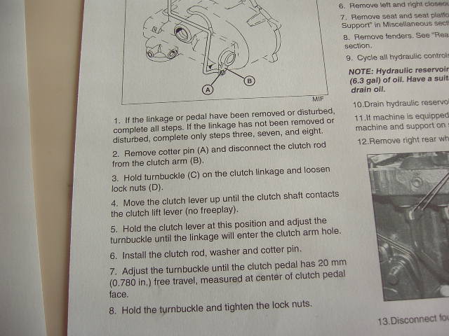

I've got a friend with a 96 4300 4x4.. and the gears are grinding. He was about to split it.. then noticed it is a wet clutch.. and wondered about proper adjustment technique.
Any help I can pass along?

Good Morning
I don't know if this will help, but I made a photo of the clutch adjustment page for my JD 4310. Might be the same might not.
Hope it helps.

Hi
Another photo.

I'll pass them along.
thanks

Thanks Dicker.. that was the ticket!
