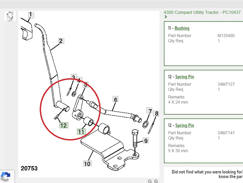

Found a lot of slop in the PTO engaging lever, and need to find out where the slop is located. Appears to be at roll pin #12, but may be enlarged holes in the crank lever (#5 or #2).
Will have to explore.
This 4300 has the mechanical PTO clutch engagement with three positions.. on, neutral (coasting PTO), off (brake applied).

Replaced crank lever #5 and roll pin #12, and no slop now.
