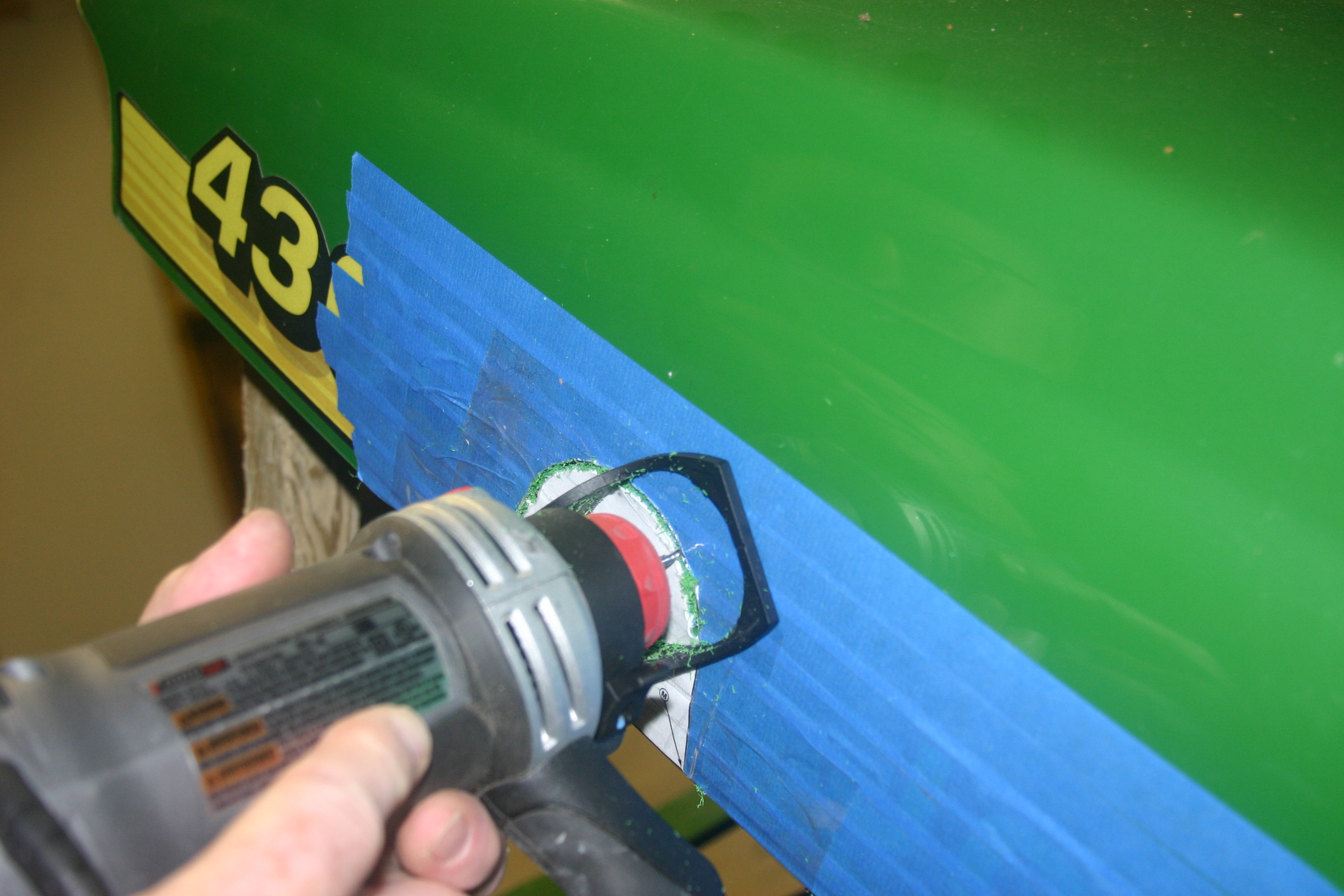

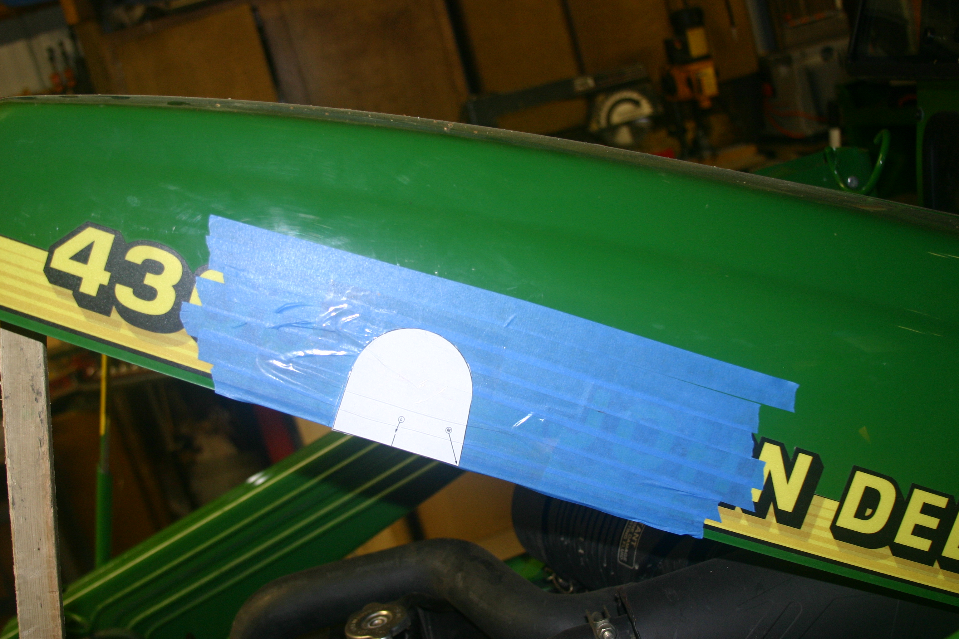

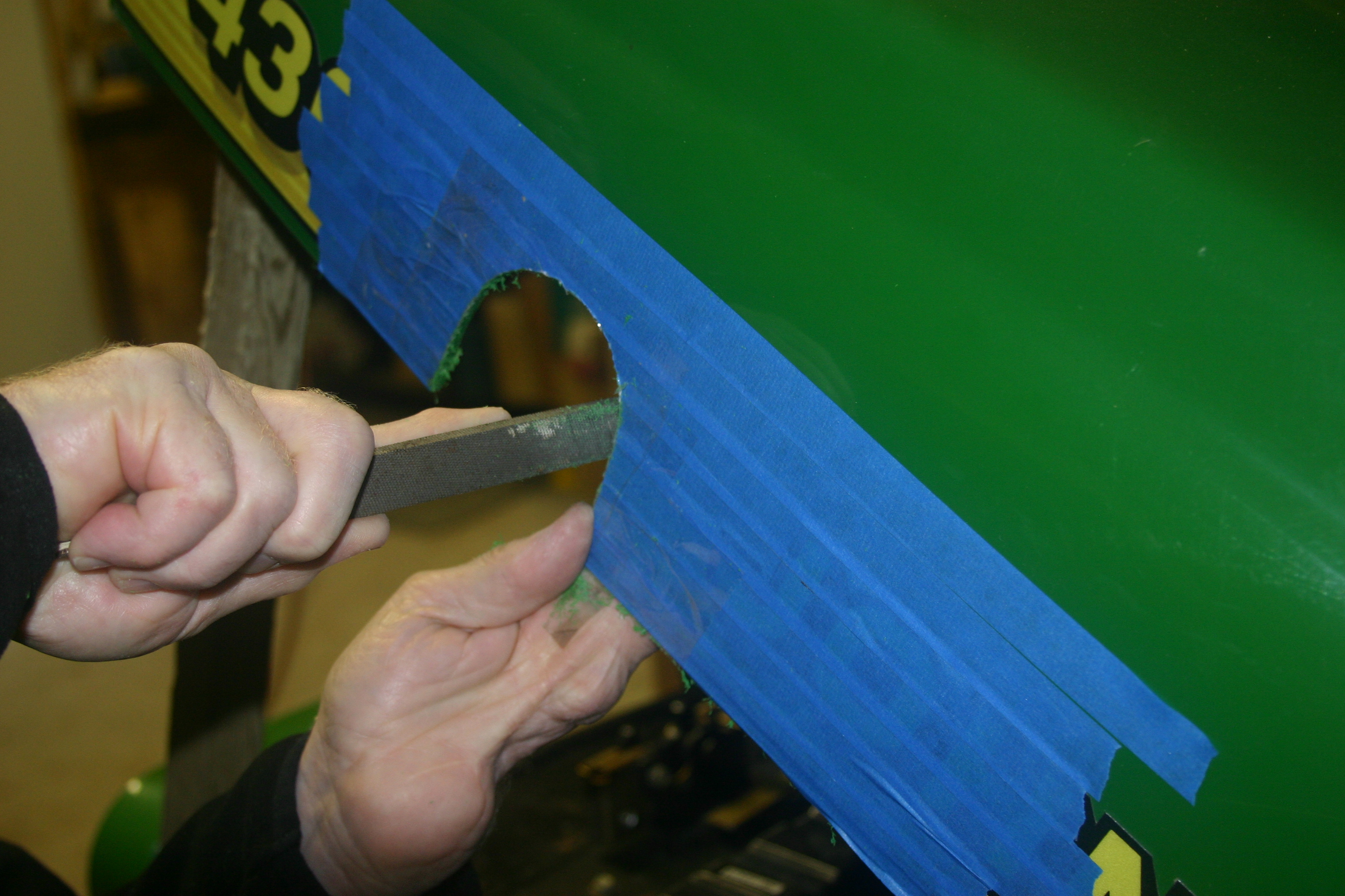

I also upgraded to the top pipe and used the JD attachment. If anybody needs my old pipe, it's yours for cheap.
I hogged out the opening in the hood using a dremel, all by freehand, lifting the hood up and down to check for clearance.
It was all done for the same reasons. I got tired of constantly breathing diesel exhaust. Now its very rare to ever get a whiff of it. I'm not concerned about limbs and obstacles hitting the pipe, after all, it's right there in front of me where I can see if something's going to hit it.
