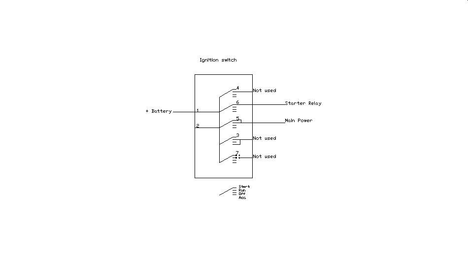

I am looking for a wiring diagram for my JD 4300. I want to find out what the "Aux" switch position does and how to use it, and/or find a way to get an ON voltage output for such things a radio and a sprayer pump, Cellphone, etc.
I also want to know the layout of the "fuse-Relay" panel that has all the connections.
I will appreciate any comments and experience.
Thanks,
Jim
   / 4300 Wiring Diagram #2
I've attached a drawing of the ignition switch. If you have any questions let me know.
