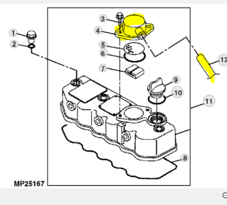

Ok sorry first time in forum. Originally I had a leaky axel seal and replaced it. Filled with new fluid after and the steering and bucket controls were really shaky so I was bleeding the air out like in the book just by turning wheel back and forth and lifting and lowering bucket and rock shaft. When I had the bucket all the way raised and was bringing it back down it started leaking as I described. I will attach picture of the line the fluid was coming out of as soon as I get over to the tractor. Thanks for responding.

So that痴 where I got confused because it痴 not leaking from an actual hydraulic line it痴 some sort of overflow drain line as best as I can tell it starts close to the air intake next to an oil plug of some sort and ends close to the right front tire
/ 4310 ehydro hydraulic problem
D433B94B-563D-44D7-AEB6-0419B359FCA5.jpeg0E44E9E5-2A17-40C3-876A-FE9FB1FFD65C.jpegD433B94B-563D-44D7-AEB6-0419B359FCA5.jpeg0E44E9E5-2A17-40C3-876A-FE9FB1FFD65C.jpeg
All right I think that’s the pics of the drain line that is in question and where it starts

Looking at jdparts, I suspect the line is oil tube key #4..key#2 is a breather.
Is there a chance the hyd. oil was over-filled?

The line looks like the vent line from the valve cover. I suspect the pump seal is bad and it's pumping hydraulic oil into your engine, and pushing it out the breather on top of the valve cover.

I agree with Zeb's conclusion for being a vent tube... hard to connect oil puking from that with the OP saying it happened when lowering the FEL down from full up.
OP..."After I lifted the bucket to the top, the tractor started releasing all of the hydraulic fluid out of a hose on the engine it seems."

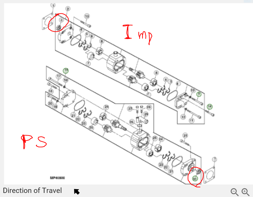

Is there a separate pump for steering on this manual?
#16
Yeah there are two pumps that are connected
#17
So the question now is if it was pumping hydraulic fluid into the engine will I have bigger problems than the pump seal
#18
so there are two hydraulic pumps, front and back, mounted on left side of engine. Is that the same as the charge pump? And then there is a hydrostatic pump as well? Which of these am I inspecting for a blown pump seal?
/ 4310 ehydro hydraulic problem #19
The two pumps are; one for power steering, and one for implements (loader, SVCs, three point hitch) In drawing from JD parts, seals are circled. They come in seal kit, P/N LVA10948. Imp = implement pump, PS = power steering pump.
Check your engine oil level, pump(s) are leaking into engine, oil level will go up and hydraulic oil level will go down.
