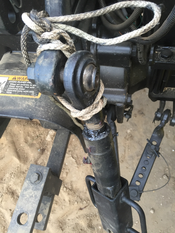

3-Point Hitch 4310 lift arm pin broken/stuck
   / 4310 lift arm pin broken/stuck #11
Now you have let two days gone by that Deere would have had your part tomorrow... :D
   / 4310 lift arm pin broken/stuck #12

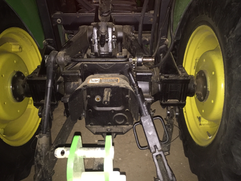

O.K. back to the original question of "how to remove this pin " from the rockshaft arm. 1-remove the nut. 2-hit the bottom of the rockshaft arm directly below the pin you want to remove with a normal sized hammer(a couple good violent hits) and it will pop right out. the "shock" from the hammer will unseat this tapered pin from the arm. you will not need to hit the pin nor use heat. more time consuming way is a two jaw puller on the nut side....tighten the puller and whack with a hammer---------------good luck:):thumbsup:
#13
Thanks everyone for your advise. Broken pin is out and new pin ordered. Ended up taking my little sledge and gave the lift arm a few good hard hits right on the front of the arm and the shock popped the pin right out.
