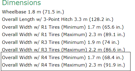

I bought a 4320 compact this weekend but wont pick the tractor up until next weekend. I'm planning to load the rear tires and had considered widening the rear tires. Does anyone know the stock width of the 4320 compact with R4 tires? Is the easiest way to widen these tires just switch sides? if so what is width with them switched around? I want to make sure it will still fit on the trailer. Thanks for the help.

Operators manual shows R4's narrow at 68.4"
And max width at 91.9"
Changing dimensions can be found in this operators manual.
OMLVU19619_E9

Thanks, it didn't seem that wide. I guess it is the R4 tires. I hate to widen it up much more or I won't be cutting my tracks with a 6' bush hog or blade.
