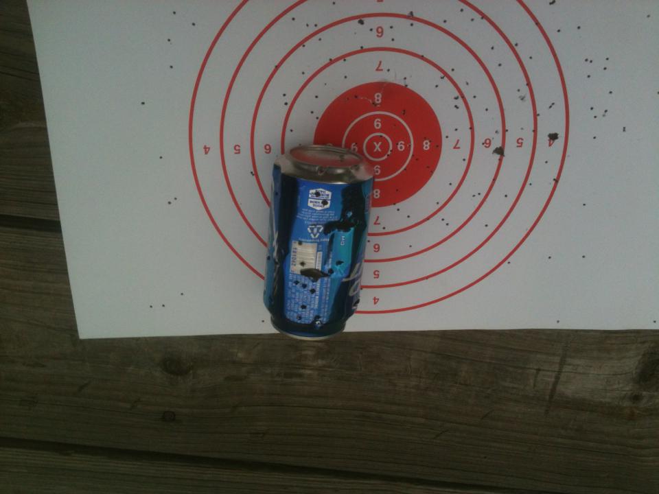

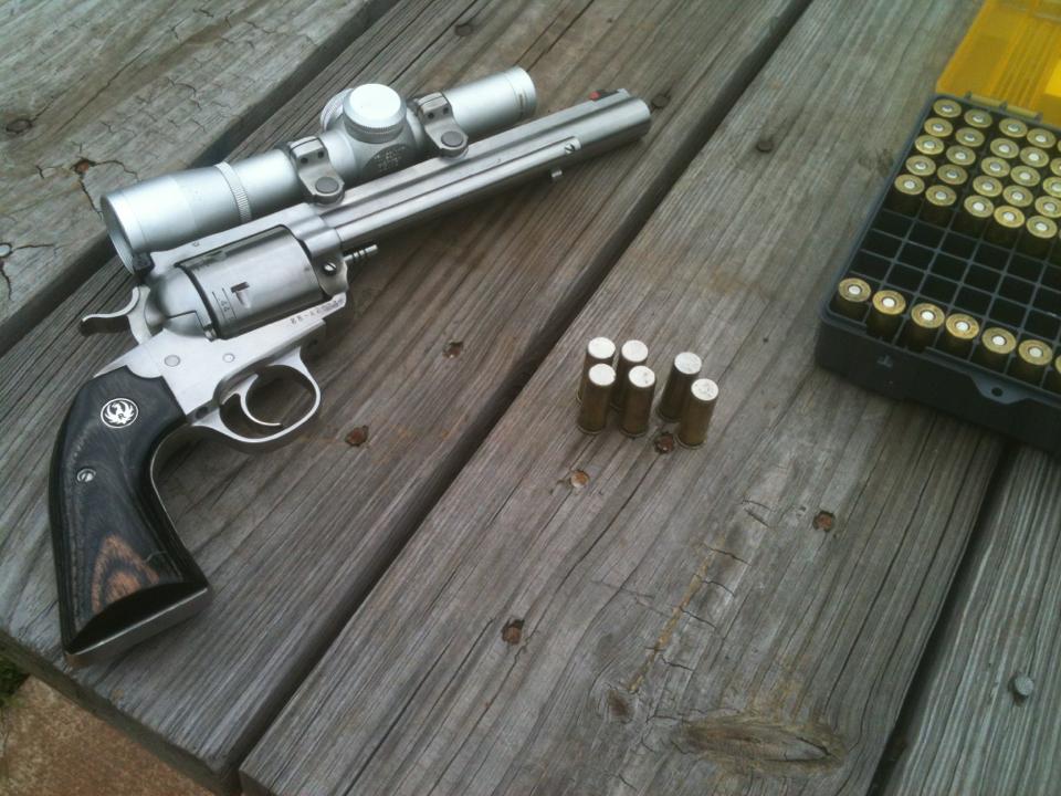

I played a bit to create shot load for 44 Magnum.
This one uses #9 shot and 6.5 grains of Unique. The shells is enclosed by wad of modelling clay and between Unique and the shot there is a felt divider.
Target and the can was shot at from 6 feet, the idea was to have a load to use on rats, snakes, mice - you got the idea.

I had a .357 and my partner had a .44 mag. We loaded the shells in .38 cases and .44 special cases respectively. I used 5 gr. of 700X with a CCI (empty) shotshell loaded with half 12 shot and half 9 shot.
http://www.natchezss.com/product.cfm?contentID=productDetail&prodID=SP8780
The loads worked great on those rats. One shot and done.
Some advice. The scope is not going to do you any good when tracking a scurrying rat in a small space.
The recoil from a .44, even a light load, is enough to expel the clay/shot out of the unfired rounds. It can jam the cylinder.
We had to crimp the plastic shotshells just until they reached the non-breaking point. That also means we had to trim the cases to an exact and equal length to make the crimps consistent. Even then, some shotshells would break.
Not so much of a problem the way you have it set up.

I used to use the plastic shot shell casings when preparing shotshells for .44 and .357. They worked well and never broke one. I used the same crimp setting that I did for jacketed bullets.
   / 44 Magnum shot load
Thank you, gentlemen :)
I actually crimped the shells, hard to see, but I took out the seating part of the die and pushed the shell in all the way to round up the edges a bit.

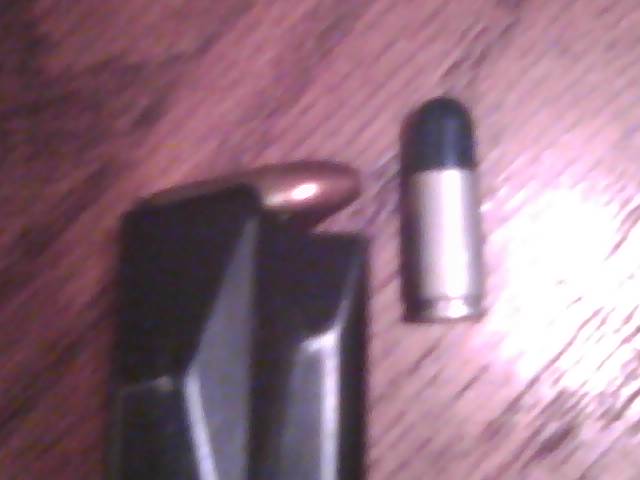

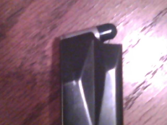

Before I walk out the front or back door I always chamber a 9 mm shot that I use for snakes. Now I don't shoot the snakes when I am in my woodpiles or checking on my creeks only when they are to close to the house and my family. Rattle snakes don't bother to much, it is the Copperheads that I don't want to step on out in the woods.0829130010a.jpg0829130011.jpg

I would be concerned about the clay fouling the grooves\lands.

Robert: The clay hardens up in a day or two and it is not sticky anymore, flies straight out. I was more concern about the abrasion in the barrel, but after testing the clay - it is kindergarten grade, tastes quite good :) - there is no grit in it.
Gunny: That was my inspiration, but I never had no luck cutting the styrofoam to work for me.
