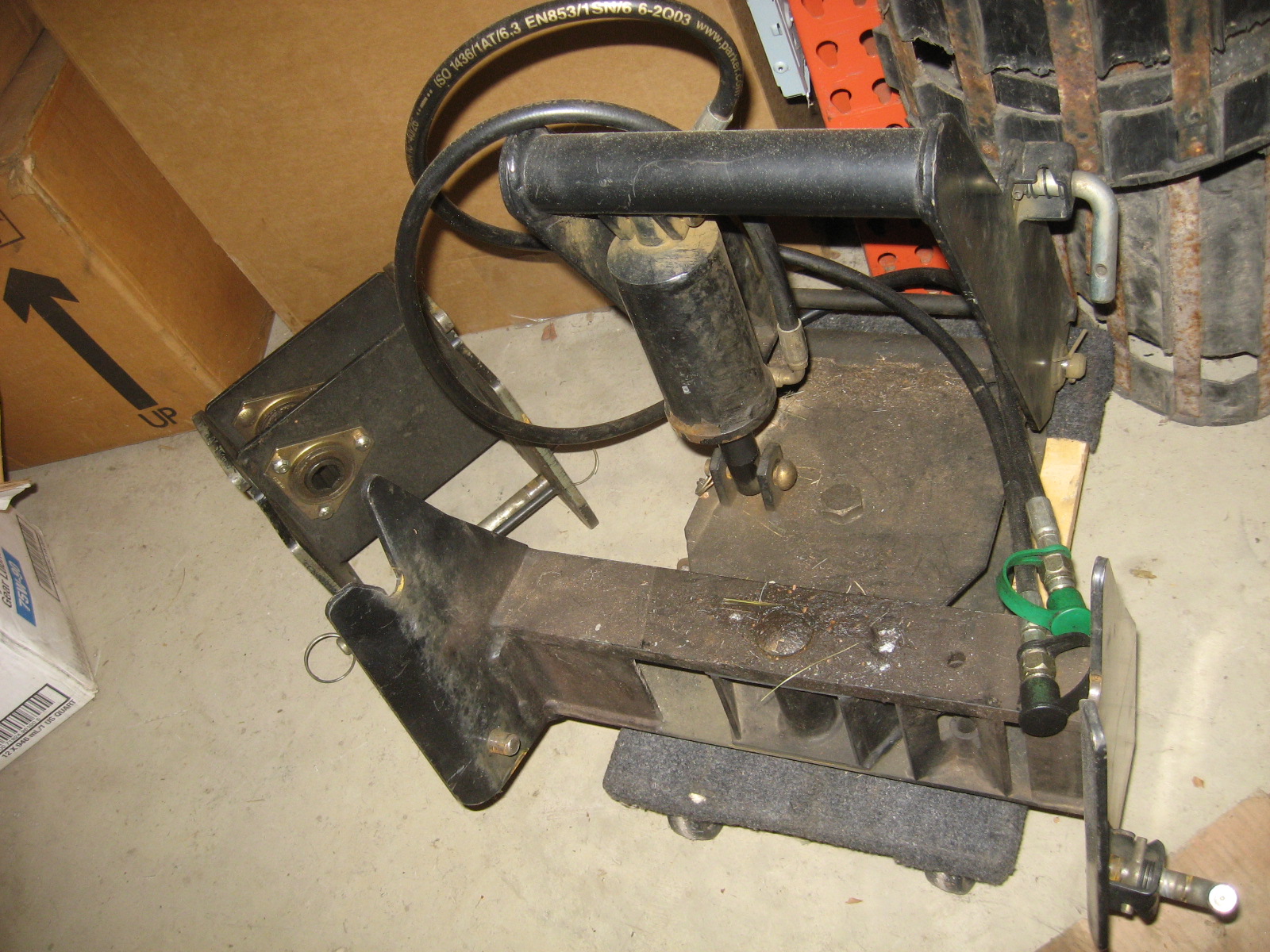

I have located a good condition 47 snow blower from an X series tractor. I want to retrofit it to my 4110. I am aware there are several different mounts for this snow blower. Anyone have the width of the quick mount or the length of the long drive shaft ? I have a small fabrication shop and can modify to fit. Just curious before driving to pick this unit up if these two items are the only problems to deal with.
   / 47" Snow Blower from an X series mount to a 4110 #2

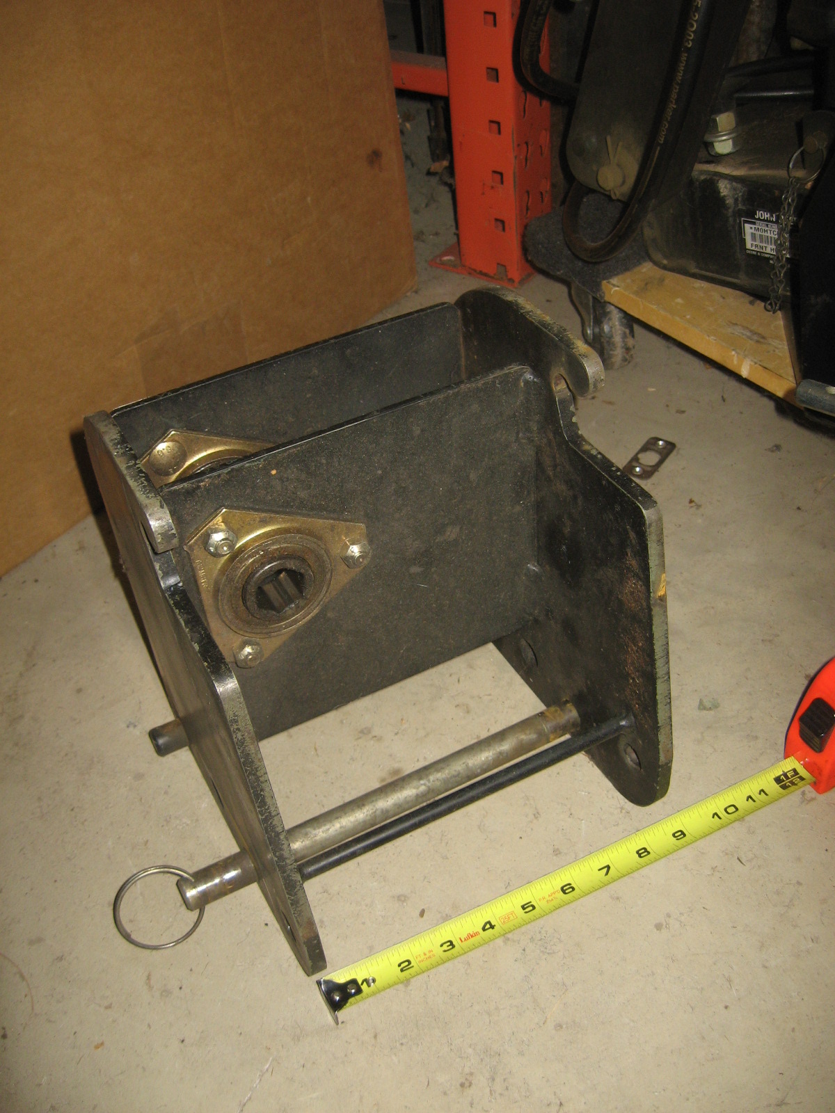

Drive shaft is 59 & 1/2 inches. Bearing carrier is 9 in wide, 11 in tall, 8 3/8 in deep. So the width of the quick attach is just over 9 inches to allow it to slip into the bearing carrier assembly. The bearing carrier assembly attaches to the tractor frame below the grill.

Thanks, ... Looks like an east retro fit. Dimensions are very close for the frame mount.

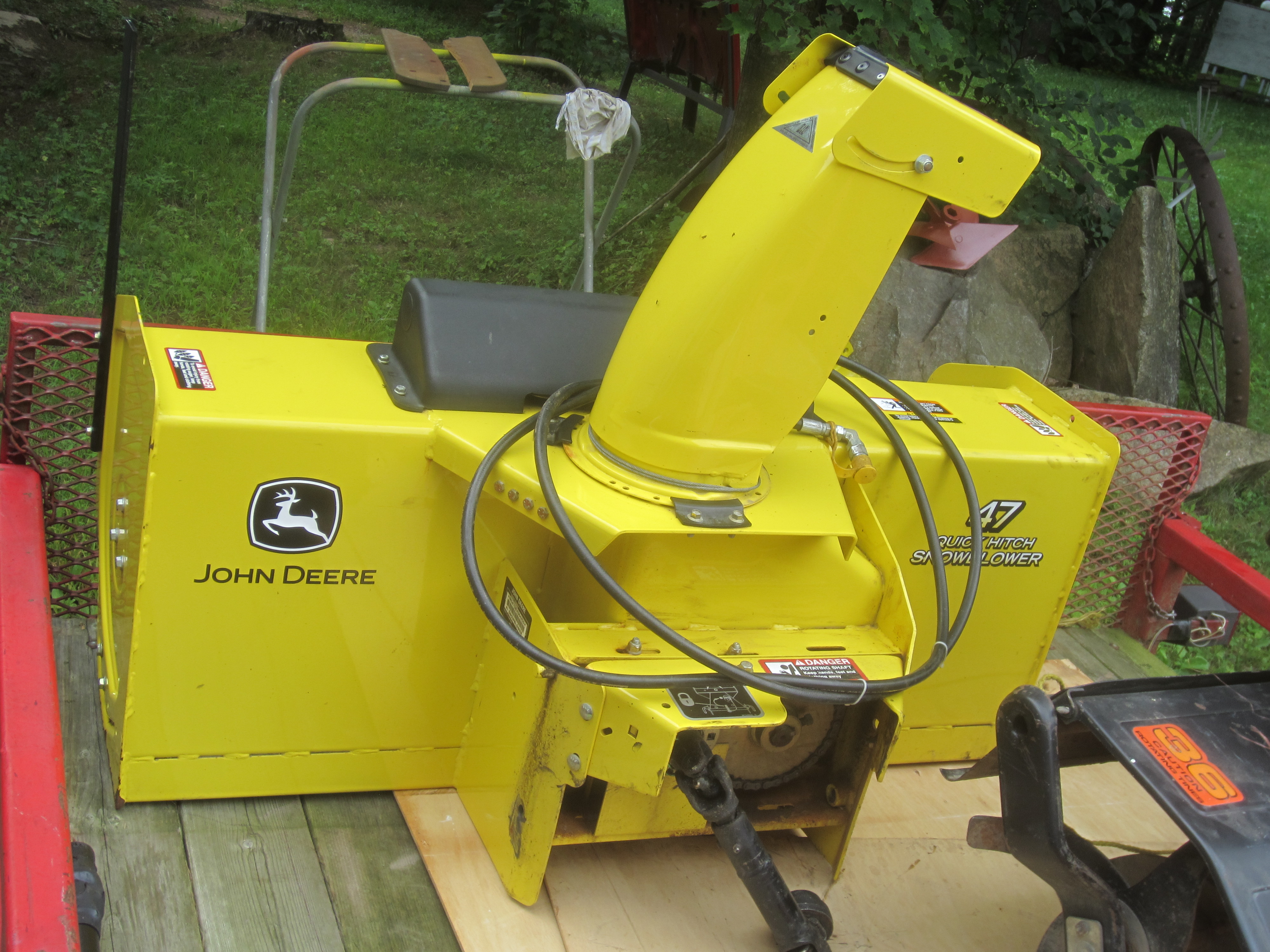

Brought it back today. Complete with quick hitch and drive shafts.IMG_3814.JPG
