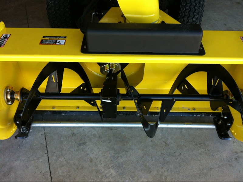

Ok. This may or may not hold up on the gravel driveway. Time will tell. But it's cheap and requires no modification to my expensive new snowblower. It's a 1x48" piece of galvanized pipe attached to the factory skid shoes with grade 8 bolts. Here's a picture.

I'll remove the two bolts when I run this on concrete - should take about 60 seconds. I am guessing that since the weight of the snowblower is spread all across the pipe that the pipe won't wear too awful fast. And I would think that once there's a little snow on the driveway the wear should be minimal. But I guess that's what I'll learn from experimenting. And if it wears too fast, I'll try ABS pipe. I'll post an update after I've tried this.
/ 47" Snowblower Question #15
Pretty good idea. I have a couple of concerns. Is the bolt head recessed into the pipe? My concern is the bolt held wears down and the pipe goes into the blade. My other concern is the pipe digs down into the gravel and feeds stones into your machine.

Yes - recessed into the pipe. About the pipe digging in - I will post an update once I've tried it. But whatever it does it will be less likely to roll stones up over the cutting edge than when riding on the skids. Once the driveway is frozen it may be academic. I will try it both ways and report relative differences.
/ 47" Snowblower Question #18
Interesting idea. Should hold up OK on stone. Post back to let us know how it works out.
