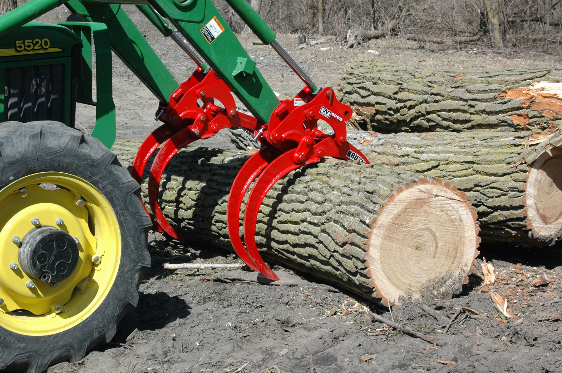

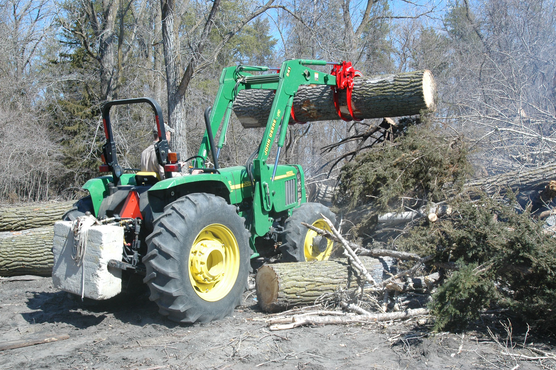

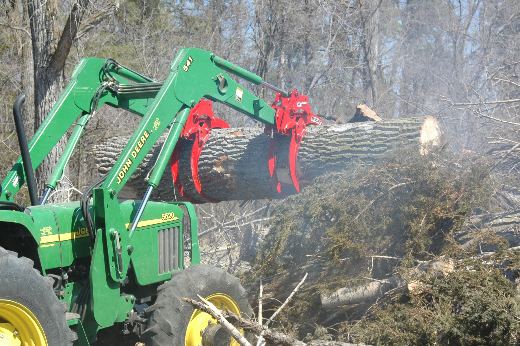

Have not had a chance to operate the grinder yet. Spend quite a bit of time clearing up slash exposing the stumps using the grapple. That is quite the attachment for that job! The loggers pushed over a couple of large pine stumps that I picked up with the grapple and added to my already huge burn piles. Despite having a ballast box fully loaded with portland cement and a set of 8 suitcase weights on top of that, when I curled up the grapple, the rear tires came of the ground. Had to reposition my grip to get it in closer and lower the bb to just above ground level, and I was able to barely get the largest stump down the the burn pile. I no longer have any concerns about the grapple adding to much weight to where my 460 loader would run out of capacity. The stump, with lots of clay still attached, would barely fit with the grapple open all the way (70 inches). :D
