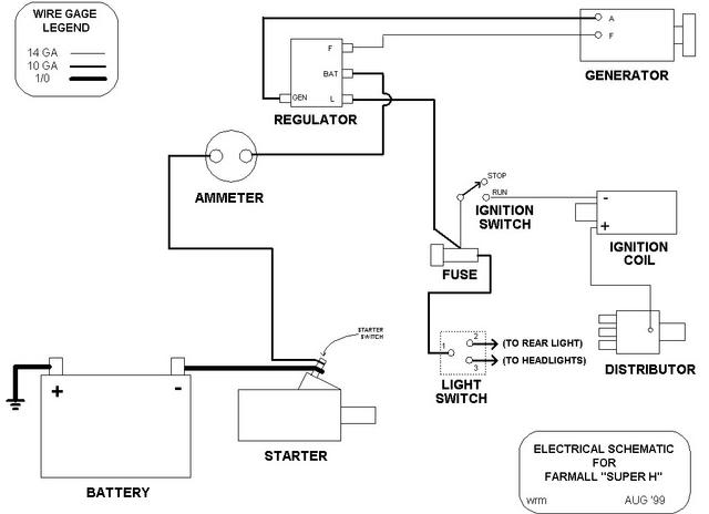

my farmall h generator wont charge it has a wire off and if i touch it on anything it sparks any suggestions

Is it possibly the wire that goes on the connection marked BAT (for battery)..?? If this is the case, if you trace the wire back, it should go back to the ammeter. Current flows through the ammeter, then through a wire to the starter switch battery post, so as to charge the battery. So basically a direct link to the hot side of the battery.
If the connector has come off the end of the wire, crimp a new one on, and reconnect to that post on the regulator, and your charging problem may be solved.
