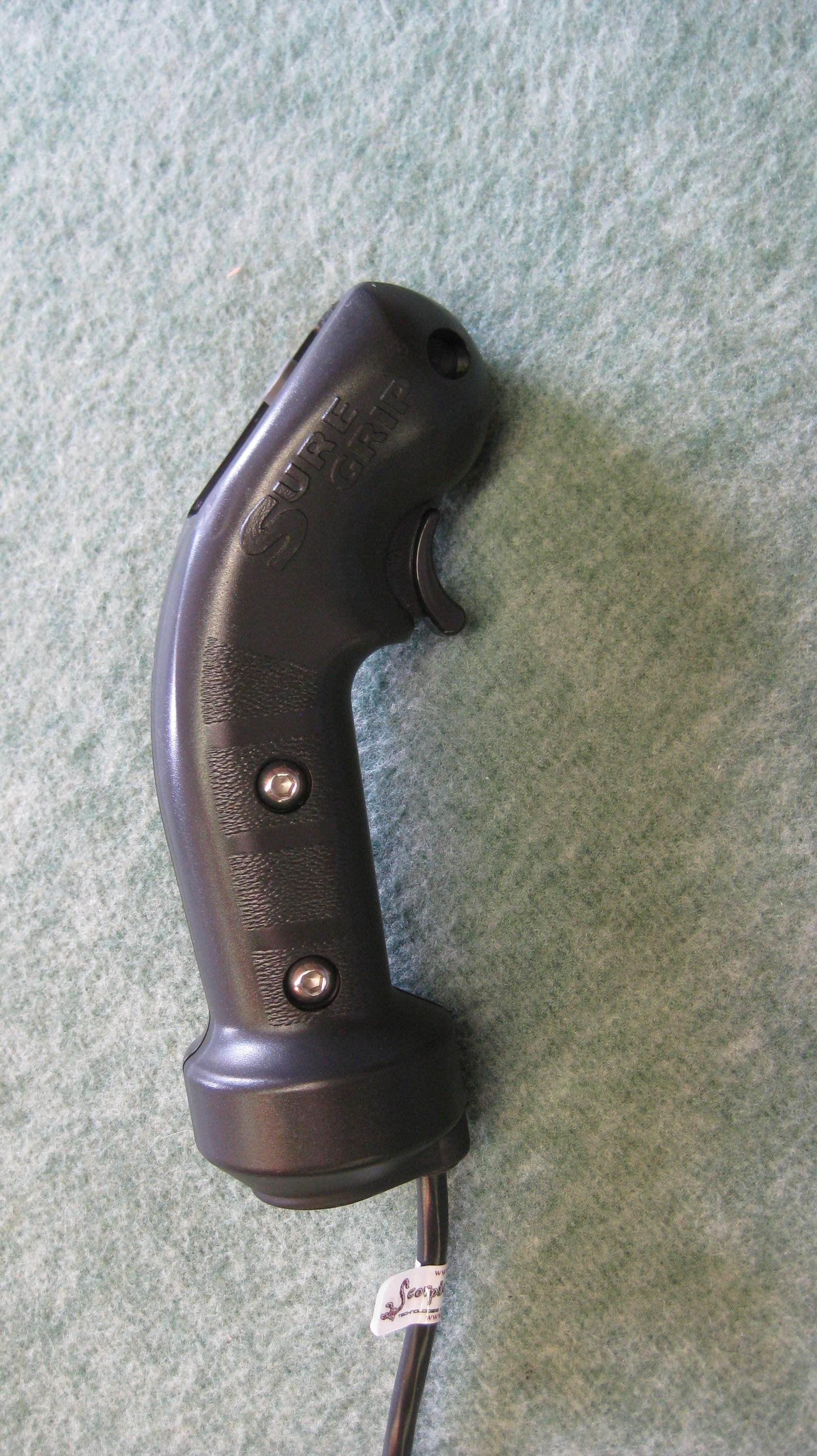

With most cab tractors, diverters are the way to go IMO. No linkage to figure out, just mount a control grip on your existing control lever for controlling the diverter-s. If you want, you can control 4 functions without ever removing your hand from the control lever. :cool:
My little TYM, had holes in the factory loader handle to add three switches, which were covered with a vinyl sticker. It was a bit hard finding momentary pushbutton switches to fit the 7-mm holes, that were small enough to fit in the handle. But did eventually find some on eBay.
They are sitting in a box where I have a set of three stacked diverter valves, they eventually will control. Now all I have to do is find time to put the whole set up together and on the tractor.
