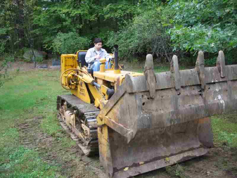

They will not turn your tractor into a bulldozer. With the clam open it's more like having a front blade on the FEL. You will be limited by the strength of the loader arms. What 4n1's are good for are picking things up and spreading material. I have one on my TD6 dozer and it's a great help clearing land.
