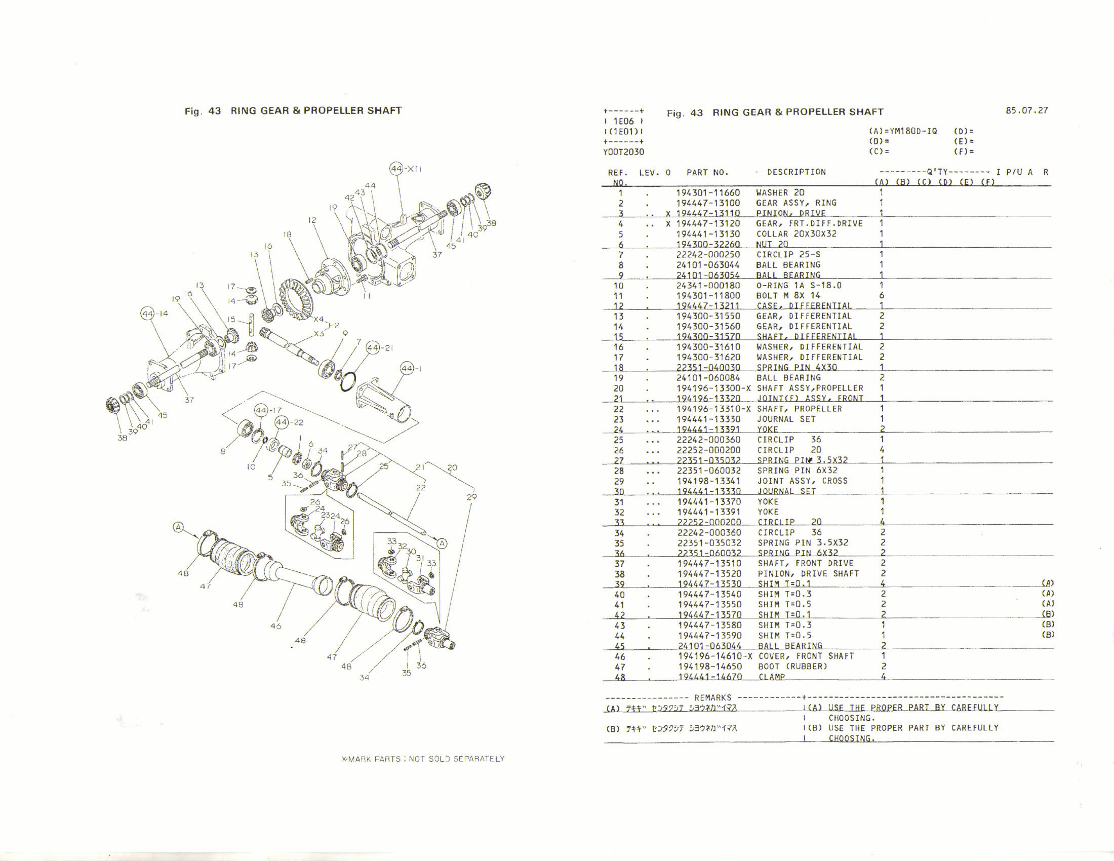

... was plowing this deep-ish 1.5' hard refroze corn snow with the front end loader on the YM 180D; all wheels spinning; front wheels digging in; rear wheels have chains; back wheels floating until they spin, then dig a hole; and the universal roll shear pin (oem?)sold by Hoye T broke again (this is the 4th time Ive replaced the pin). I imagine Im putting too much torque on the front pilot drive shaft, in the spinning. So can this small roll pin be replaced with something else that's less likely to break? I have already replaced the roll pin in a warmer afternoon at -5C on a tarp on my back with the same replacement roll pin; and I added a smaller pin inside the purchased one. Its a pain in the neck and back to replace; remove 2 boot clamps; pull heavy duty hard frozen 1/2 " rubber boot back with FEL bottom brace in the way; remove C clip & safety wire holding C clip snug; remove broken or missing pin this time?; line up;

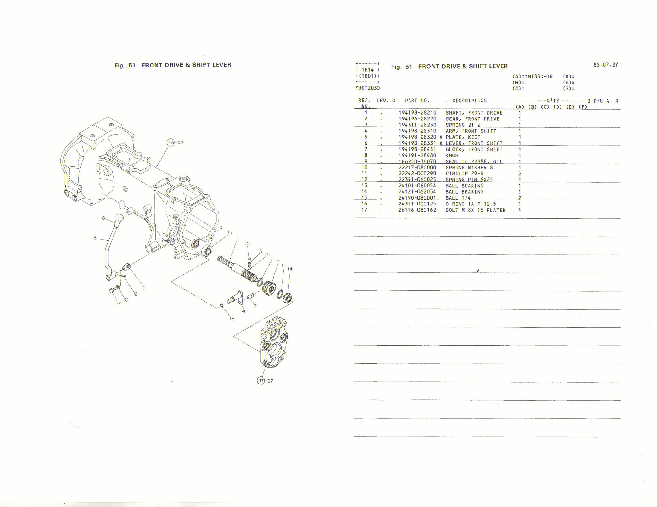

Also not 100& sure exactly how the 4WD engages; but looks like something to do with the propeller shaft sliding forward to engage the front 4WD?; had the front wheels off the ground and blocked to replace the pin but couldn't get the 4WD to catch (engage) while in the air; explanations?

Don't know whether you have the manual or not. Not sure what pins you used. Original were 22351-035032 (3.5x32) and 22351-060032 (6x32) Hoye stocks both piins.

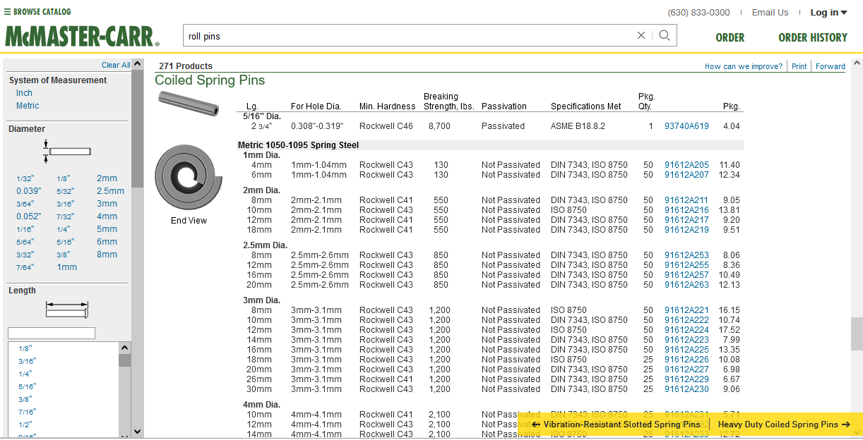

McMaster-Carr has all sizes and strengths for roll-pins. Since it's a Yanmar it's METRIC.
Scroll down the listing to find the right size. At times I can find these locally at an autoparts or hardware store that sells Hillman fasteners too.

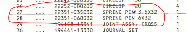

From Winston's posting, the parts manuals says,
6mm x 32mm
3.5mm x 32mm
Such an odd size. they have a 3.1mm too loose and a 4.0 to thick unless you can pound it in there. hmmm

Yes agree, I was thinking stronger would create a bigger problem, but not convinced I have the right pins. The roll pins I was sole are a pipe with a slit in it design not like the jelly role design (lol, for lack of better description) posted by bmaverick above in the McMaster-Car listings; the tractor is in a remote location 500 kms away, so don't have access to the pin or I take a caliper out and measure but remember it being a loose fit when installing.

The sizes are listed in Winston's post from the Parts Manual. No need to measure. ;) That's why I screen captured and posted.
That odd size of 3.5mm diameter isn't common. The best is 3.1mm at M-C.
