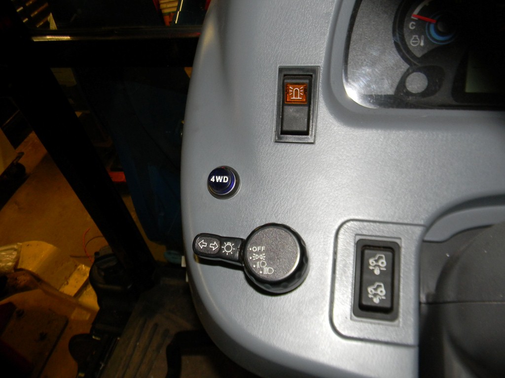

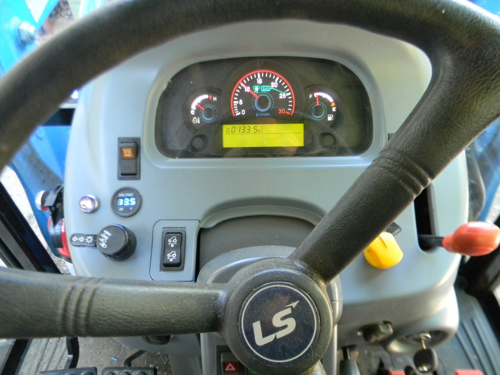

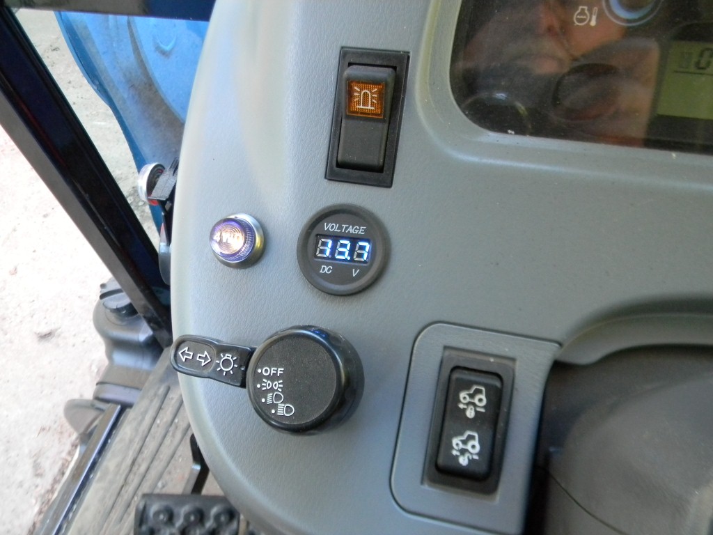

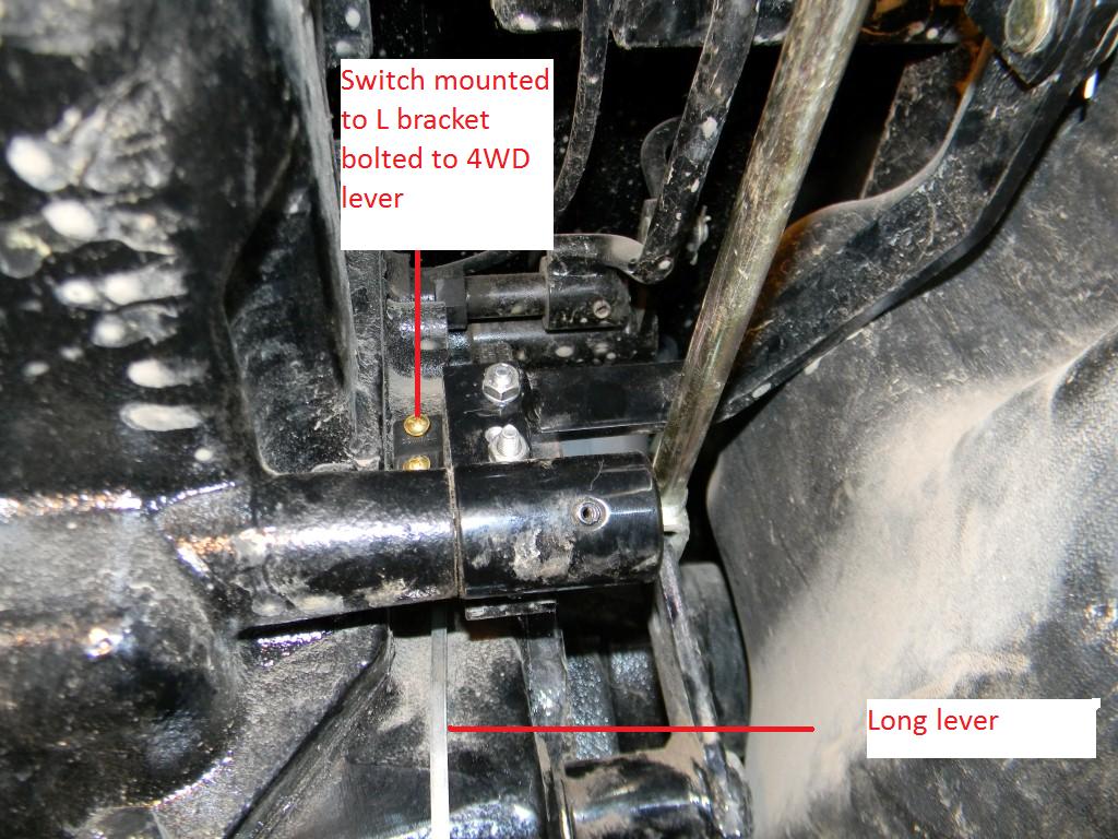

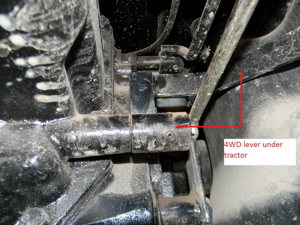

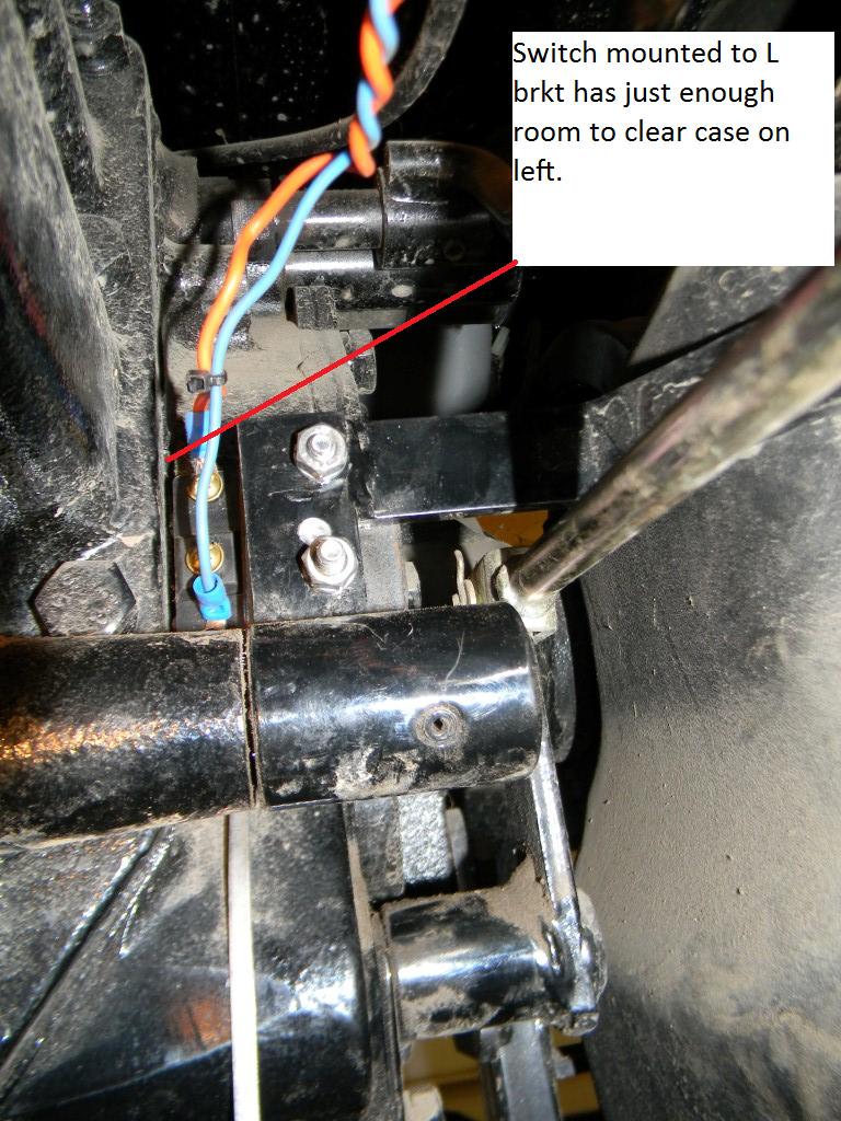

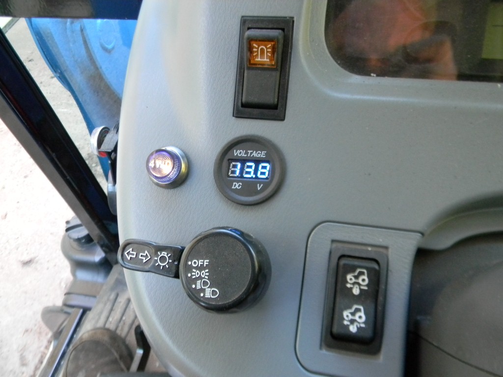

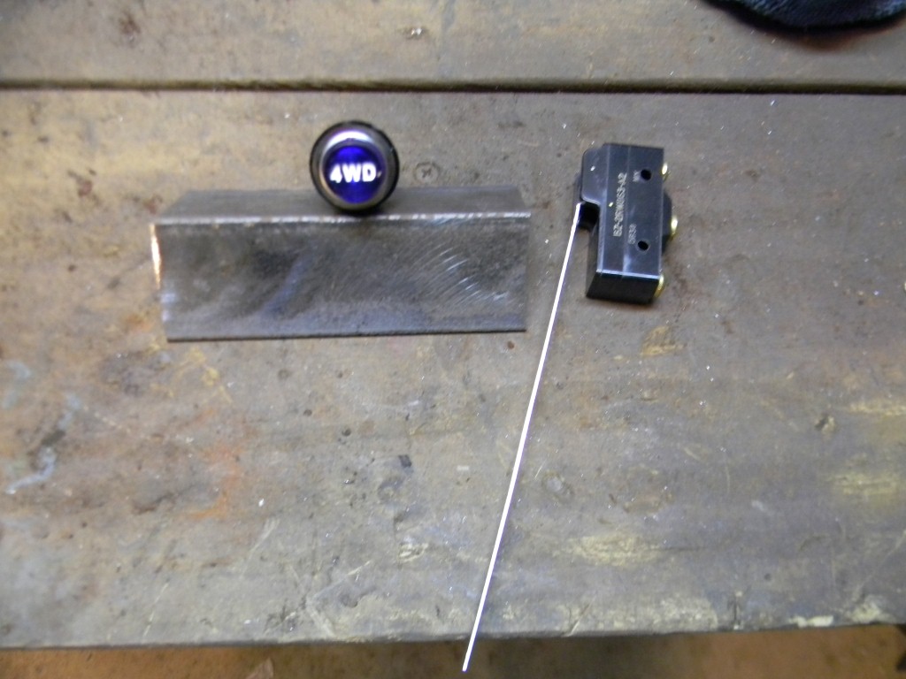

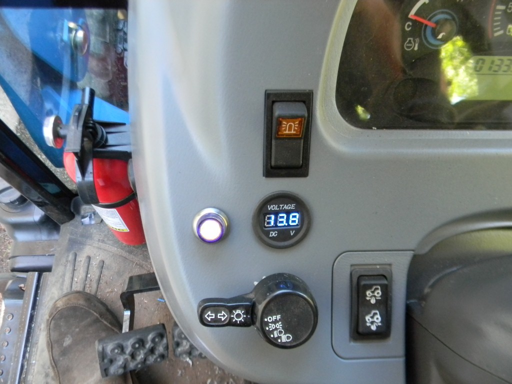

I've been wanting a 4WD indicator and a Voltmeter for my tractor so I ordered the parts last week.
Today I received the rest of my parts and got everything installed. Started with the 4WD indicator. Made a bracket out of angle steel to mount the long lever micro switch. Test fitted everything, drilled and mounted the switch to the bracket under the tractor then drilled the arm that moves when 4WD is engaged and bolted in place. Ran the pair of wires up from the switch through a small hole in the brake pedal rubber boot where it goes through the floor. Removed dash side panels and 4 screws that hold the top section of the dash. Found a couple empty spots large enough for the 4WD light and the Volt meter. Drilled a 3/4" hole for the light and a 1" hole for the meter. There is an empty terminal on the ignition switch the becomes hot with the key on so that is my power source for both. Each has a ground that goes to chassis ground under the dash.
All items bought on fleabay with free shipping.
The Volt meter was $8.99 (is available in different color readout, I chose blue)
4WD light was $26.95 (I wanted it to read 4WD and also available in different colors) any 12V light would have worked just as well at $5-6.00
Long lever micro switch was $8.95
Misc. nuts, bolts, wire, angle
