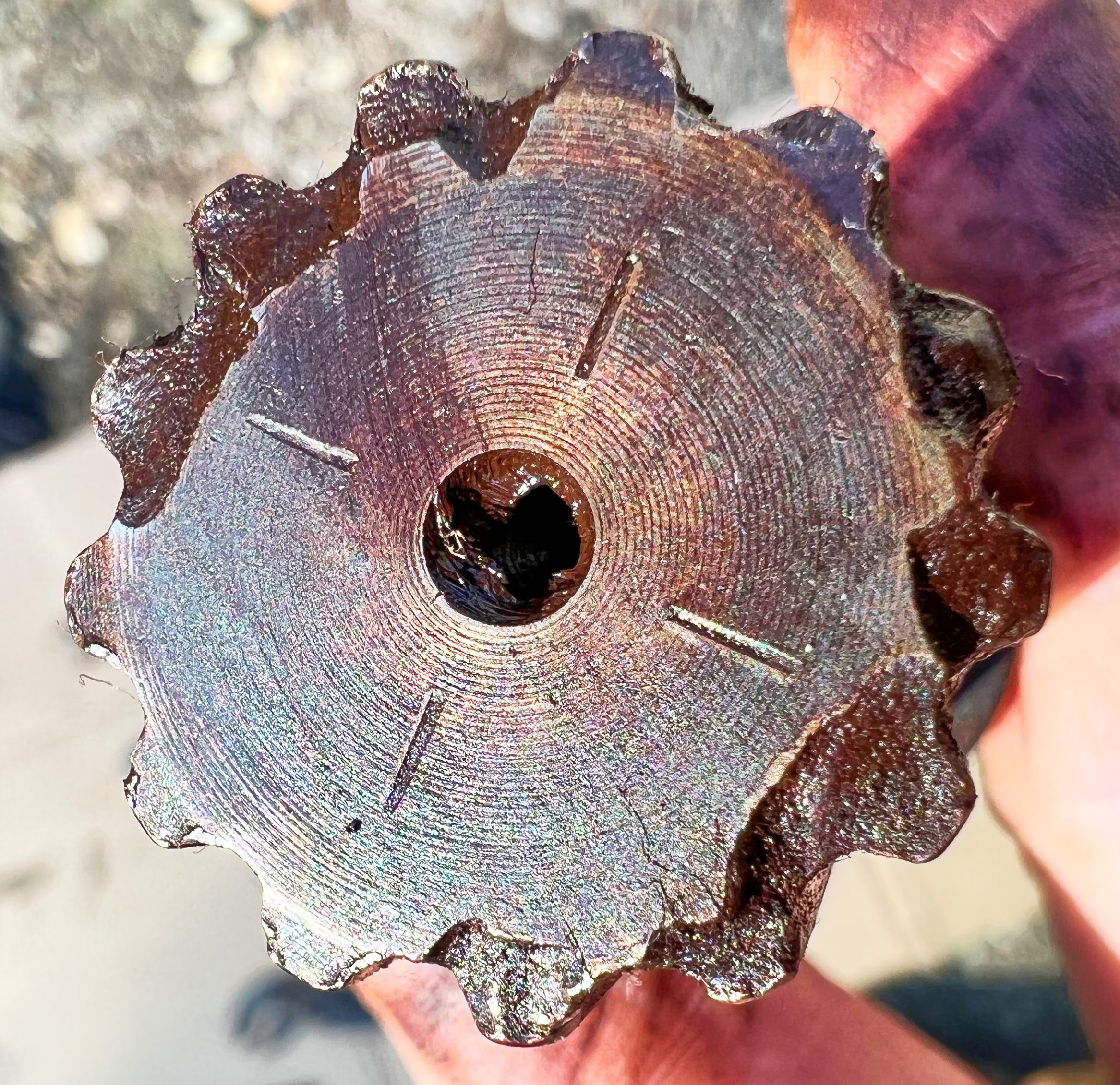

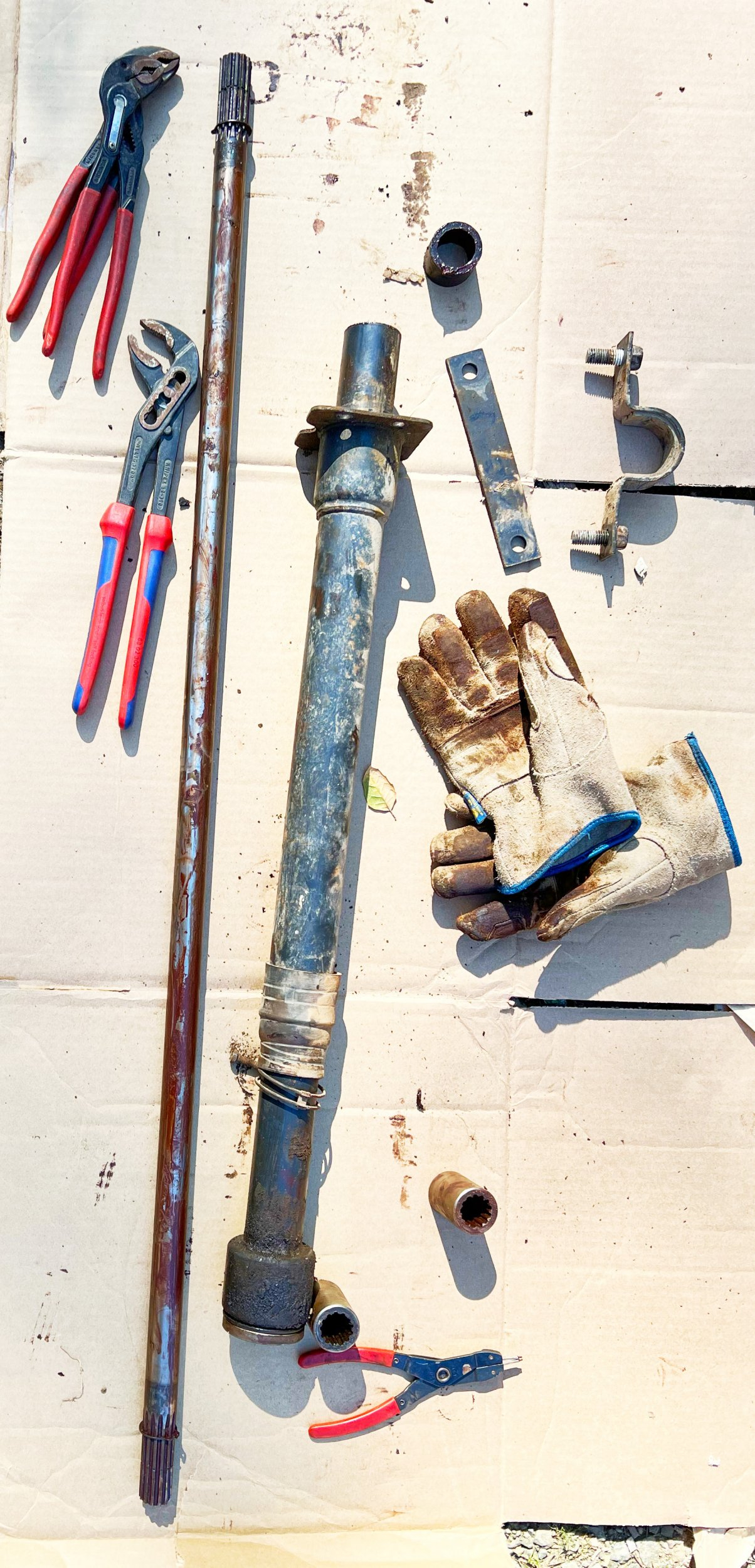

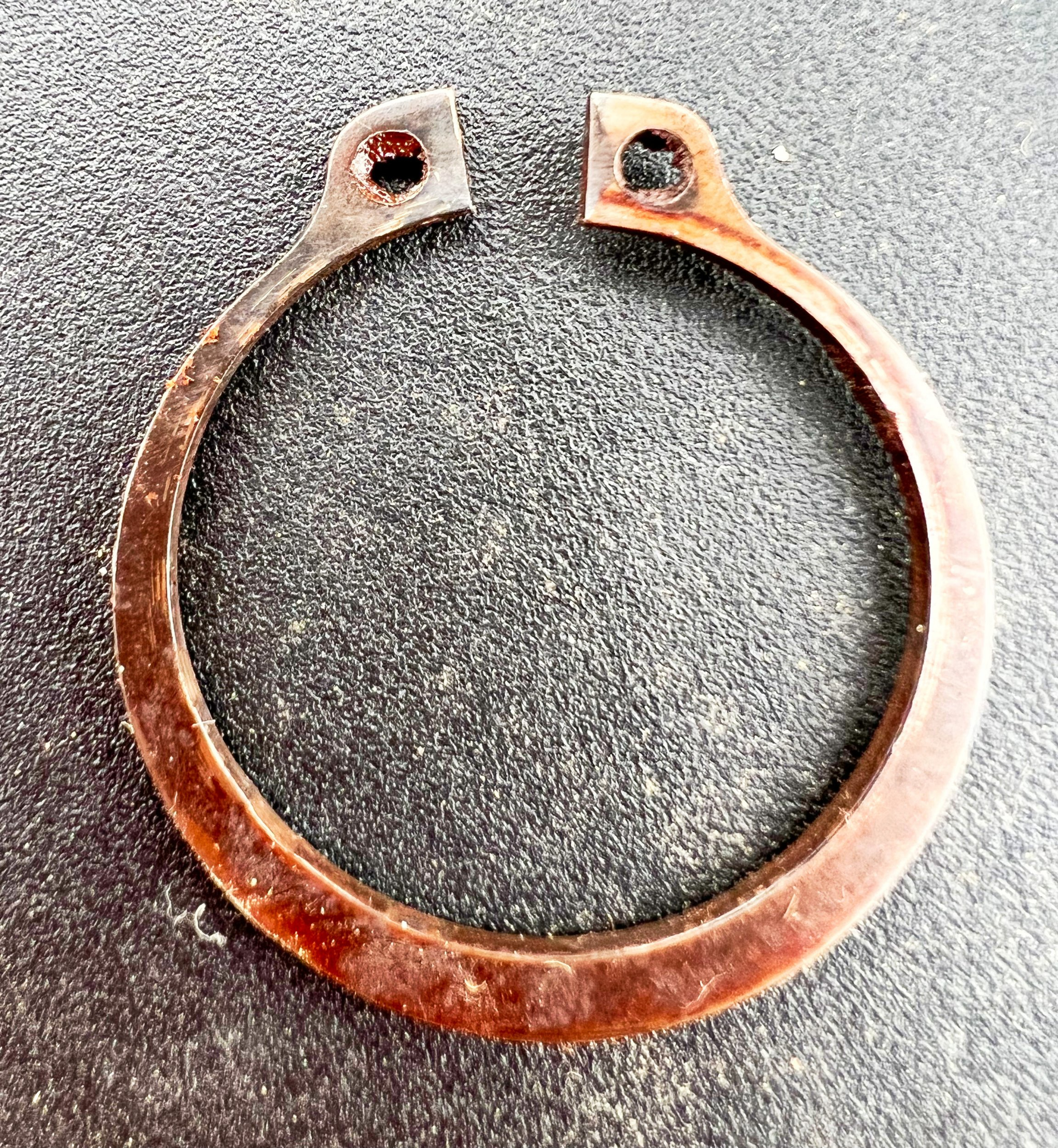

All fixed, and not exactly what the threads said. Yes, it was the prop shaft, but no, there are no balls and no roll pins, and nothing else to act as a torque breaker. Both ends of the prop shaft and both the tranny and front axle are all male splines, mated with female spline couplings. During removal, the snap rings and couplings are slid up the prop shaft. When reinstalling, the couplings are slid onto the tranny and front axle, then the snap rings are placed in the grooves to prevent the couplings from backing out. Apparently someone was in their before me and stretched out one of the snap rings so that it didn't stay seated in its groove on the shaft. This allowed the front coupling to move forward when I came down a short, steep slope and bottomed out on my bucket lip, causing a fast deceleration in addition to gravity, knocking the front snap ring out of the groove. Further work on up slopes caused the front coupling to slide up the prop shaft and out of mesh with the front axle. I re-bent the snap ring and put it back together. If you needed a new snap ring, it looks like it's McMaster p/n 98541A440 in packs of 25 for less than nine bucks. Here are some photos. The snap ring is bent and shows a pattern of uneven contact with the shaft groove shoulder. On one end of the prop shaft, the splines were chipped. These chips are a mystery because the couplings can't slide too far onto either the tranny or the front axle, as both have limited length, so the prop shaft could never get barely engaged with a coupling. The the two ends of the prop shaft itself appear to be identical, so it doesn't matter which way you re-install it. I can't imagine using a non-4WD tractor. Thanks again to ptsg and the thread writers!

Looking at the damage on the end of the shaft, looks like it happened before and in a more violent way than it did with you. At least it was an easy fix. Thanks for the update and conclusion of the issue.

I'd replace the snap ring with a new one. Once bent it'll bend back easier. Besides being bent the old one looks like it's worn on the bent side. The ring has a sharp and a rounded side. The pic looks like the sharp side except it looks beveled on the bent end. When installed the sharp side should face away from where the force comes from.

@ericm979: True. Next time this happens I'll have 25 new snap rings from McMaster in stock!
