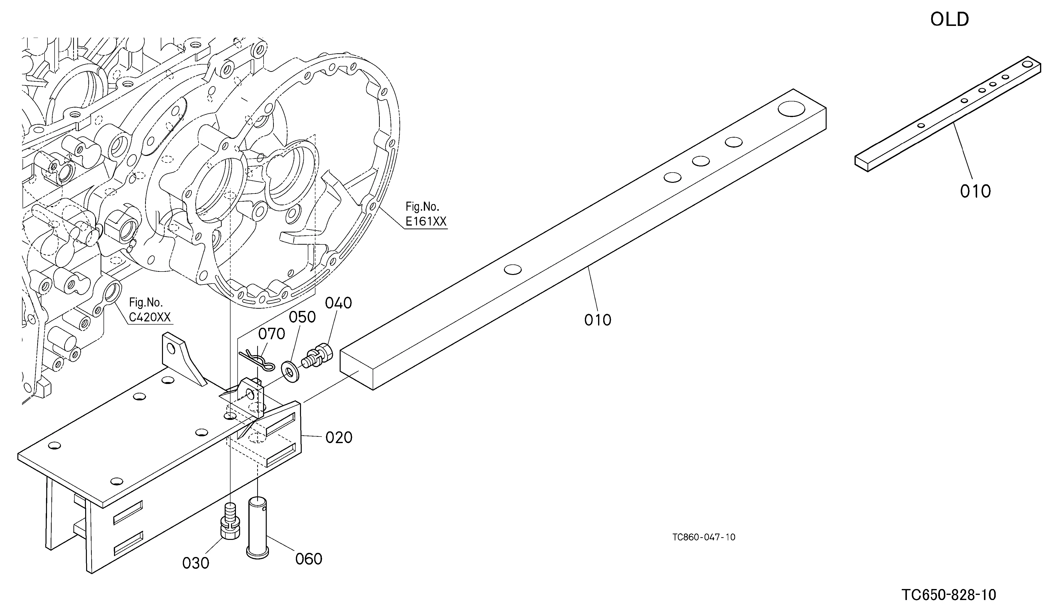

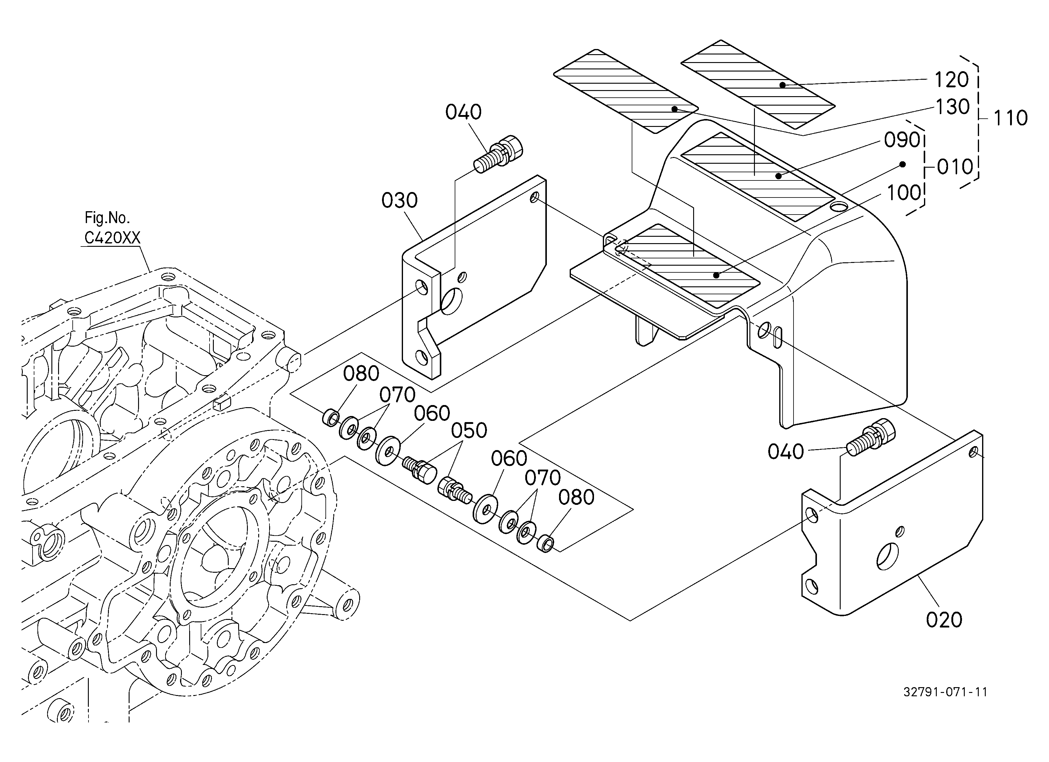

At the pivot in the center of the axle? The M59 has an adjustment for pivot wear at the front of the pivot and two zerks - one in front and one to the rear.
OK, I looked it up and sure enough the MX5800 has basically the same front axle design.
I see what you mean by the front having a vent #120 but not the rear.
And then there is that odd plug #20. What the heck is that?
I don't know quite what is going on there. Maybe we can figure it out.
Here is a link to the exploded diagram:
   / 4WD Rear axle mount grease #3
BTW, here is the M59 front axle. Interesting that on this one I can't see any grease vents on the exploded diagram, but I'll look there tomorrow.
It's a separate venting issue completely, but I see that this diagram shows that the front drive axle of the M59 is vented up to the frame while the MX5800 diagram doesn't show an front axle casting vent. It must have one...

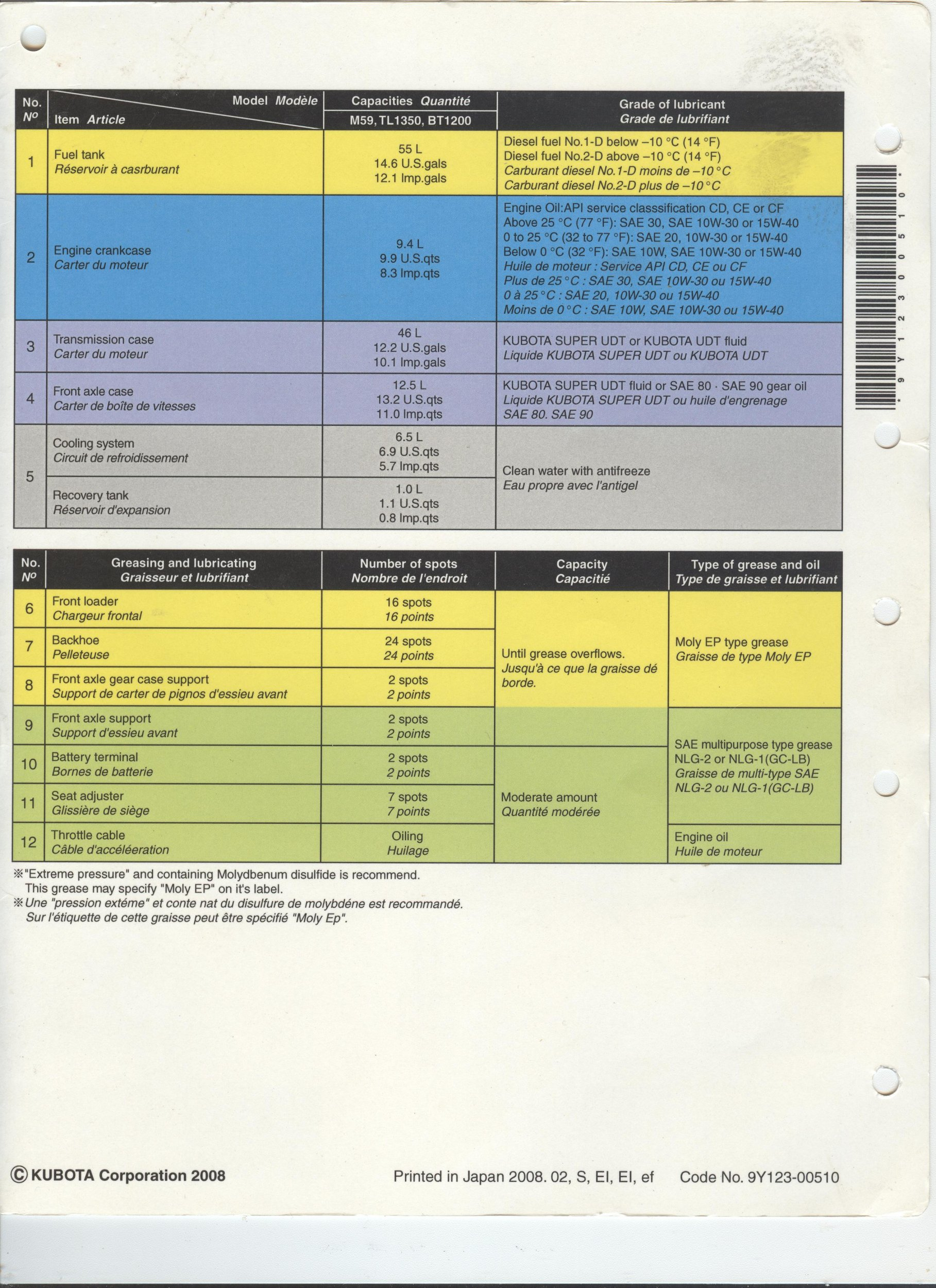

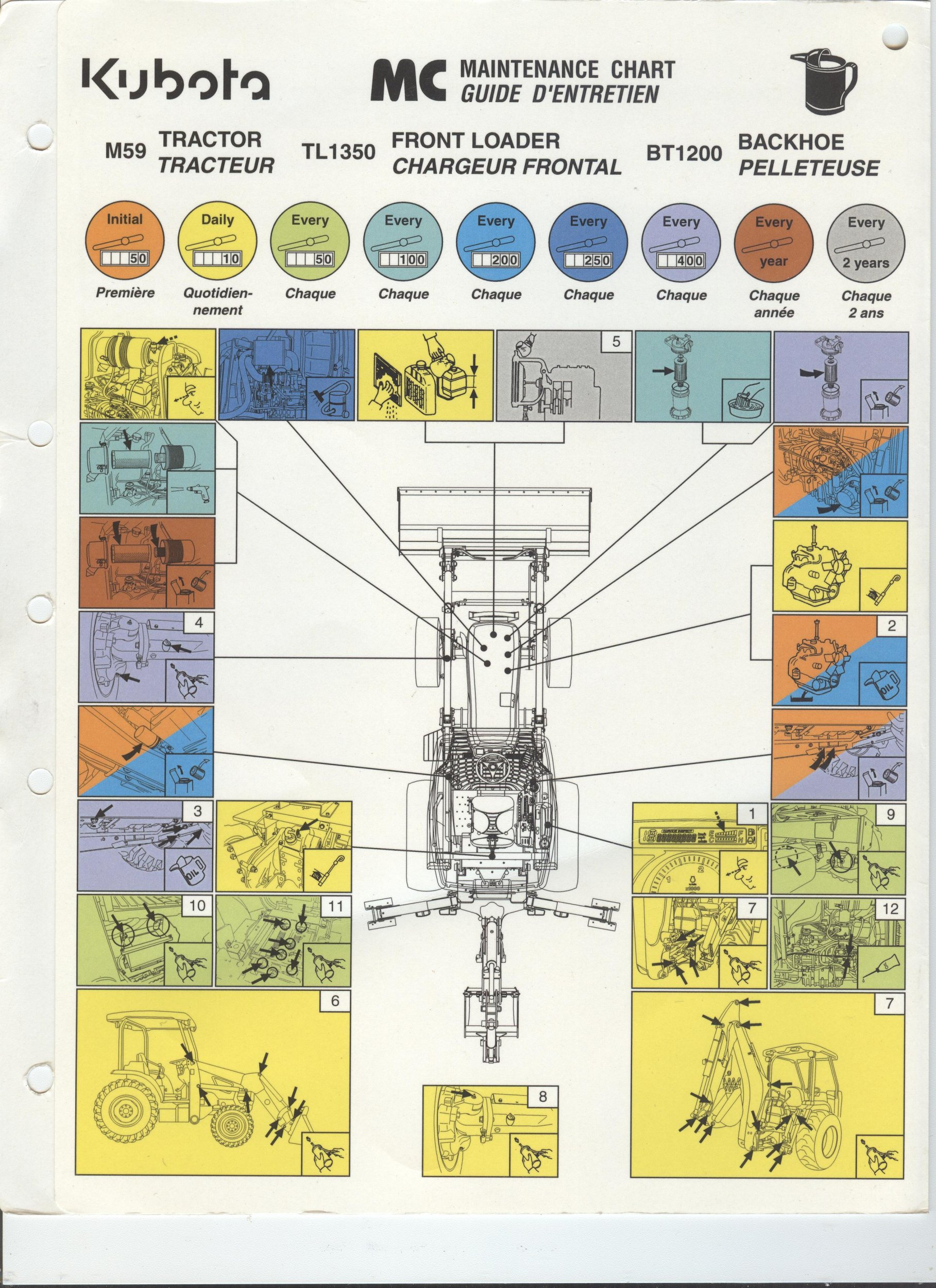

Did you get it to take grease?
Here is that Lubrication diagram and accompanying text notes That I mentioned.
Who would have guessed that there are 7 points under the seat to lube (#11).
I'm going to take a look at the throttle cable tomorrow (#12).
rScotty
