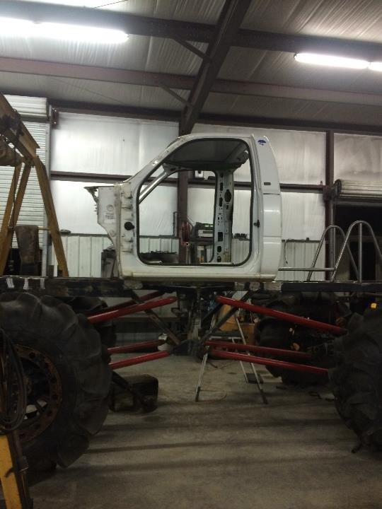

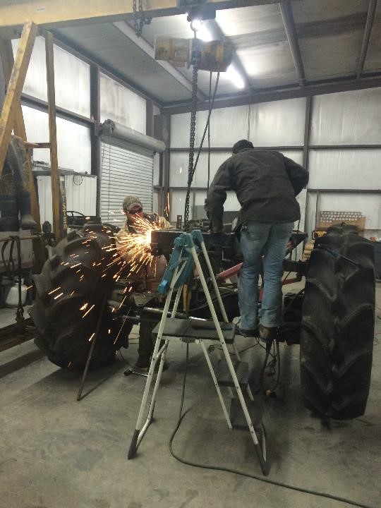

Dieselcrawler, I was finally able to get started on the truck build I mentioned a few weeks ago. Here are a few pictures. Not a lot to see yet, but several hours of work to get to this stage.
Working on the ride height, body placement and stock mounts.

What's the future holds for this build? I noticed that most of the sheet metal has been cut out, for weight savings I'm guessing? Shell only, race car style interior?
   / 4x4 Truck Build

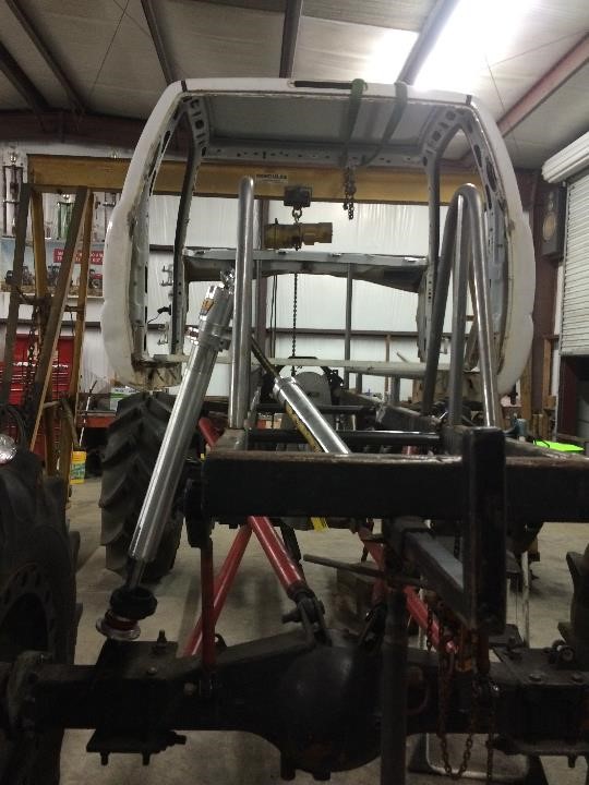

It's only purpose in life is to sling mud LOL. Cutting out the body does save a lot of weight, but in this case the truck will have tube chassis/cage that is separate from the body. The body is basically attached to the outside. If (when) the truck gets rounded, the body can be easily replaced. The bed will be just side skins.

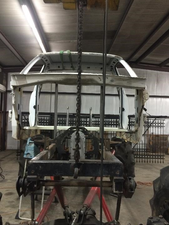

I will try and update it soon. I have been rounding up the rest of the body parts so that I could finalize the cab location and working on the fit up of some other things. I have the firewall and floorboard framing mocked up and I'm welding them in now.
I hope to start bending the tubing for the roll cage next week. Go racing this weekend, so nothing is getting done.
