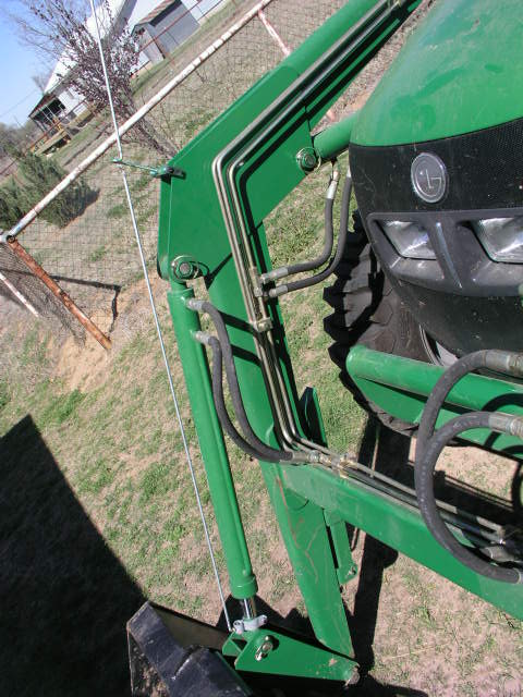

This is a very inexpensive experiment for a bucket level indicator. Had all the pieces except for the 1/4" rod which I procured at the local hardware store for a couple bucks.

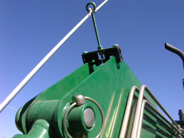

This attachment shows the upper assembly which is just a couple of Conduit I-Beam clamps, a strap secured across the clamps with screws, and a 1/4" eye bolt. The eye bolt will be vulnerable to tree limbs but what the hey, they are only .78 cents at the hardware store.... /forums/images/graemlins/tongue.gif

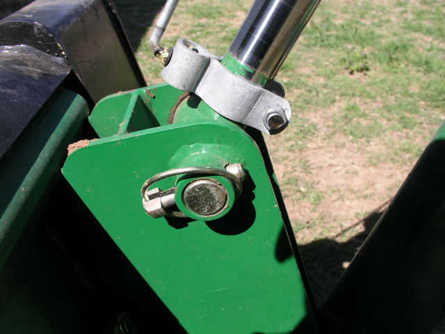

The lower attach point is a 1 3/8" chain link gate hinge. Clamped right to the cylinder with no problem.

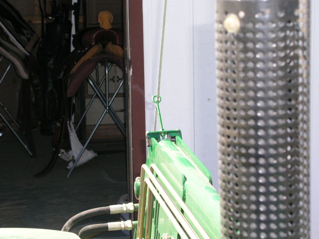

Here is a not to good a pic of the view from drivers seat. Looks kind of fragile but the price was right and it does work like a champ. Time to go do some dirt work... /forums/images/graemlins/cool.gif
