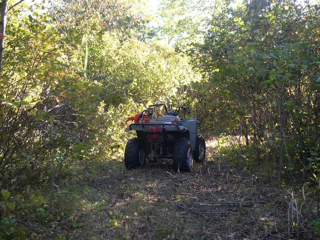

I had a John Deere 850 (24hp Yanmar engine) and it ran a 5' Kingcutter just fine.

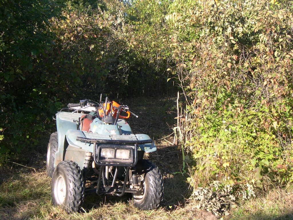

And the 24 hp tractor mowed through the brush in the photo!? If so, whoa! I not even testing my rig... (directed at airbiscuit)

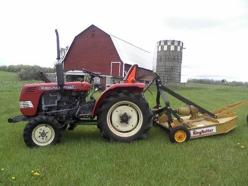

Actually those trails were made with this (15hp Shibaura)!
