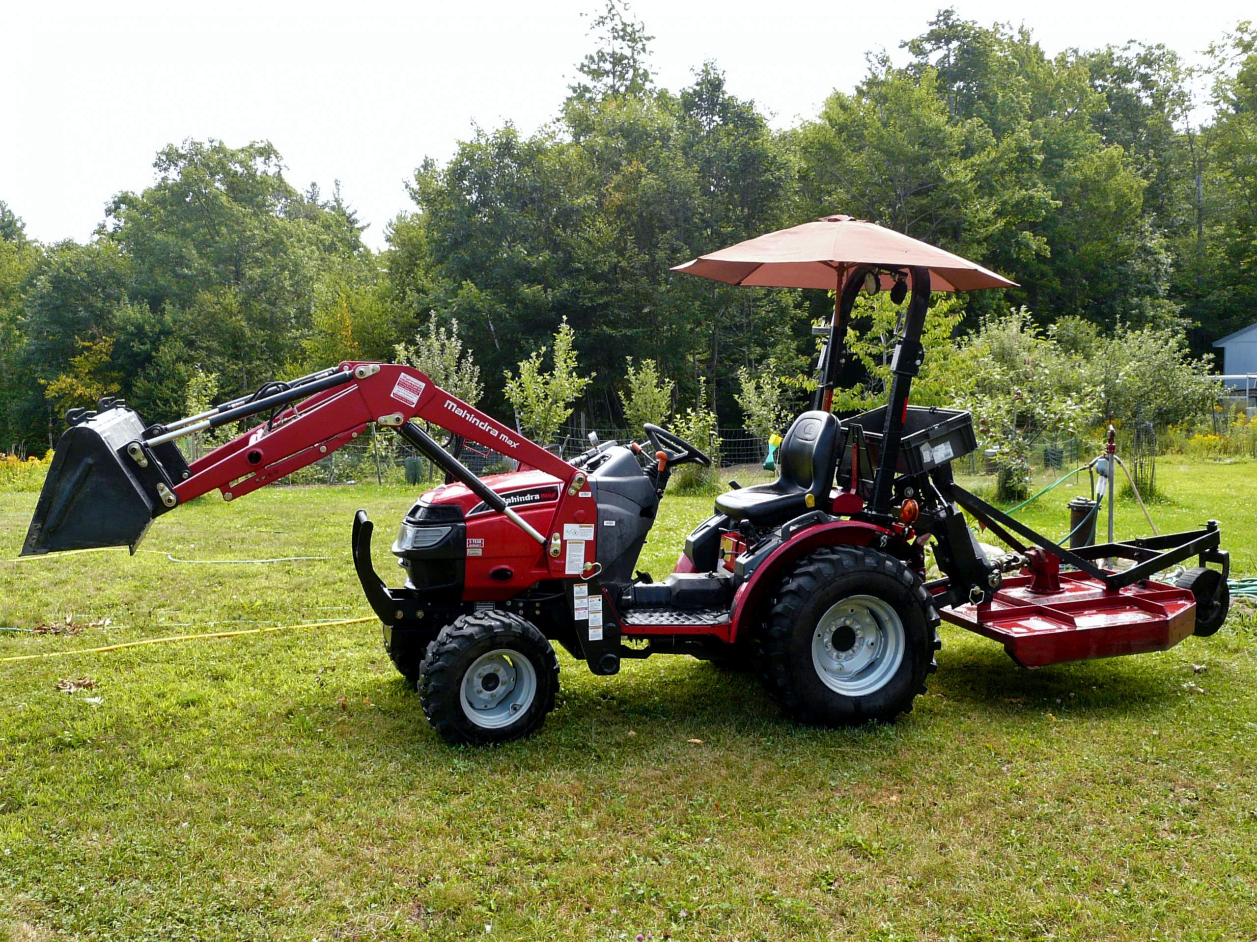

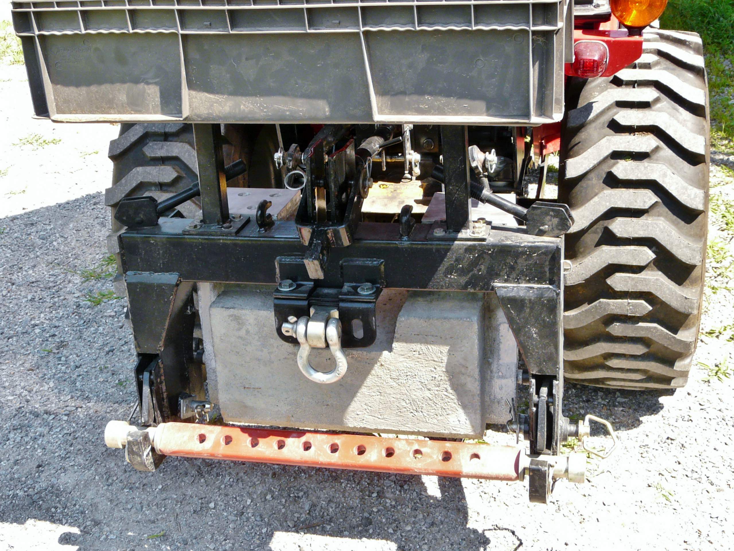

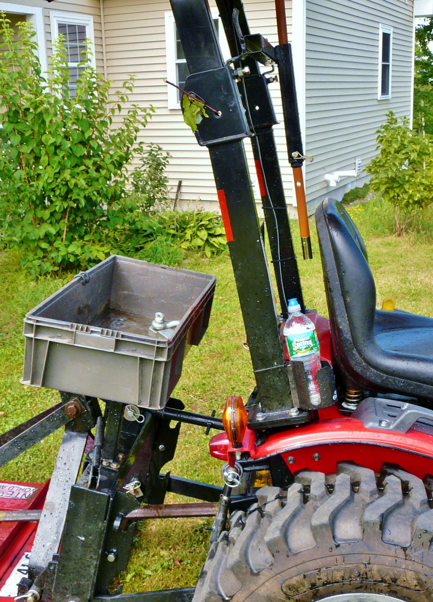

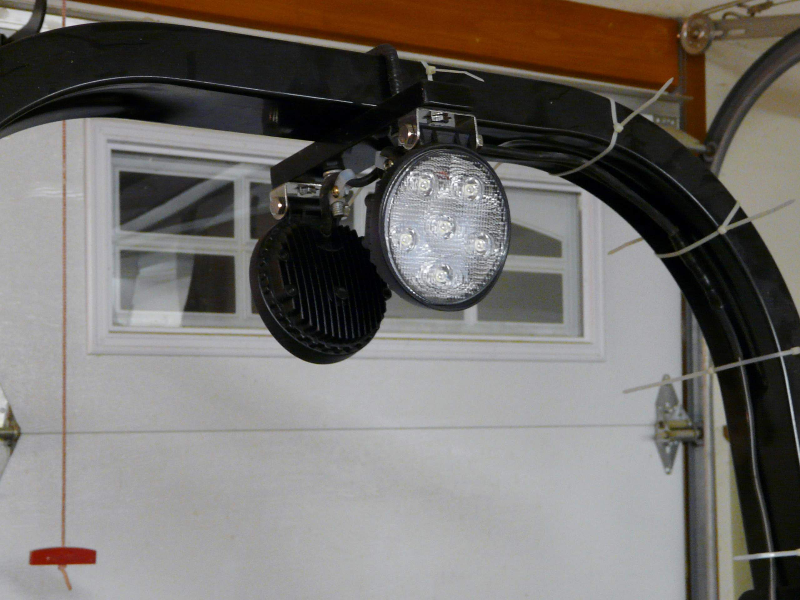

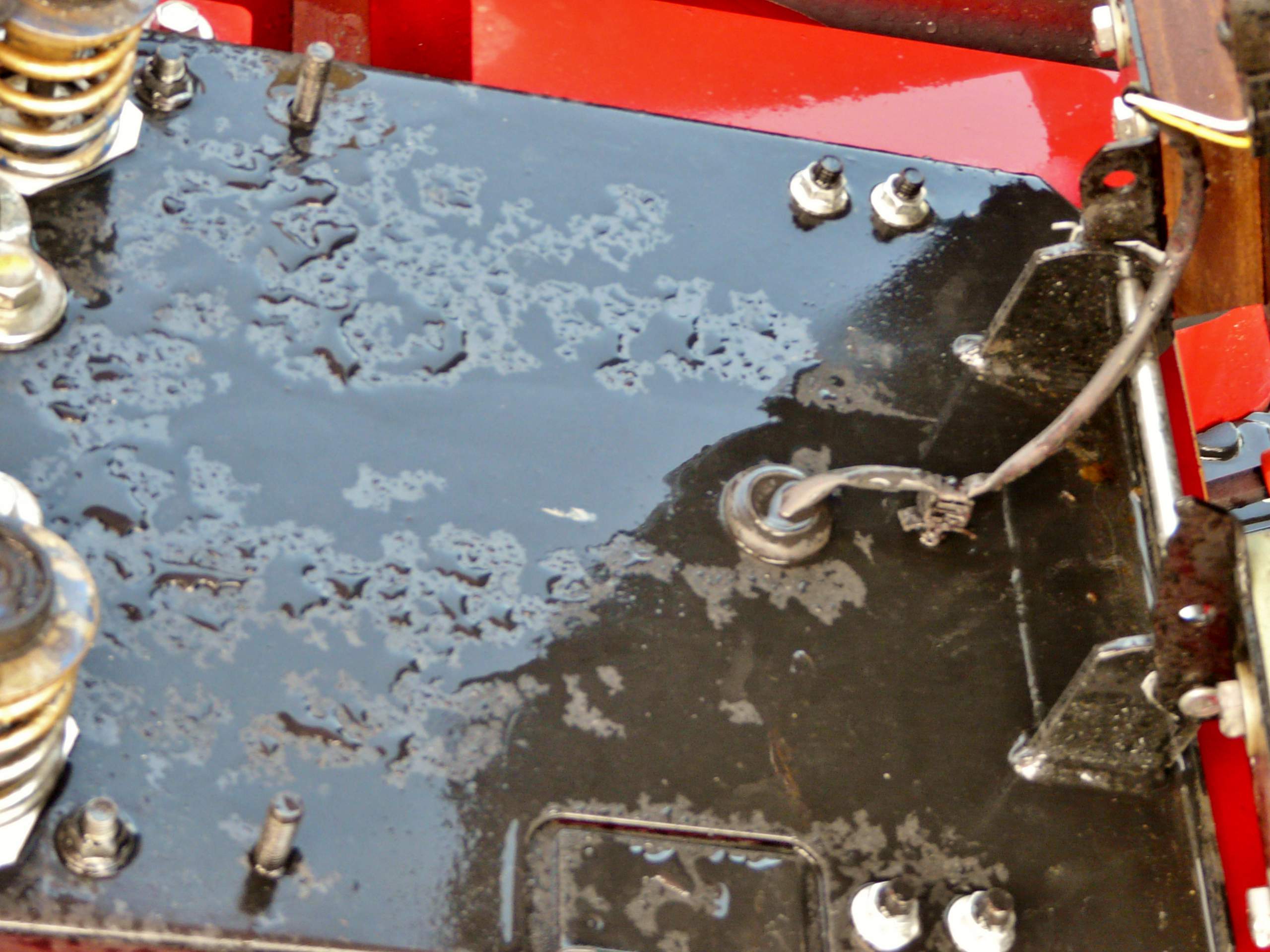

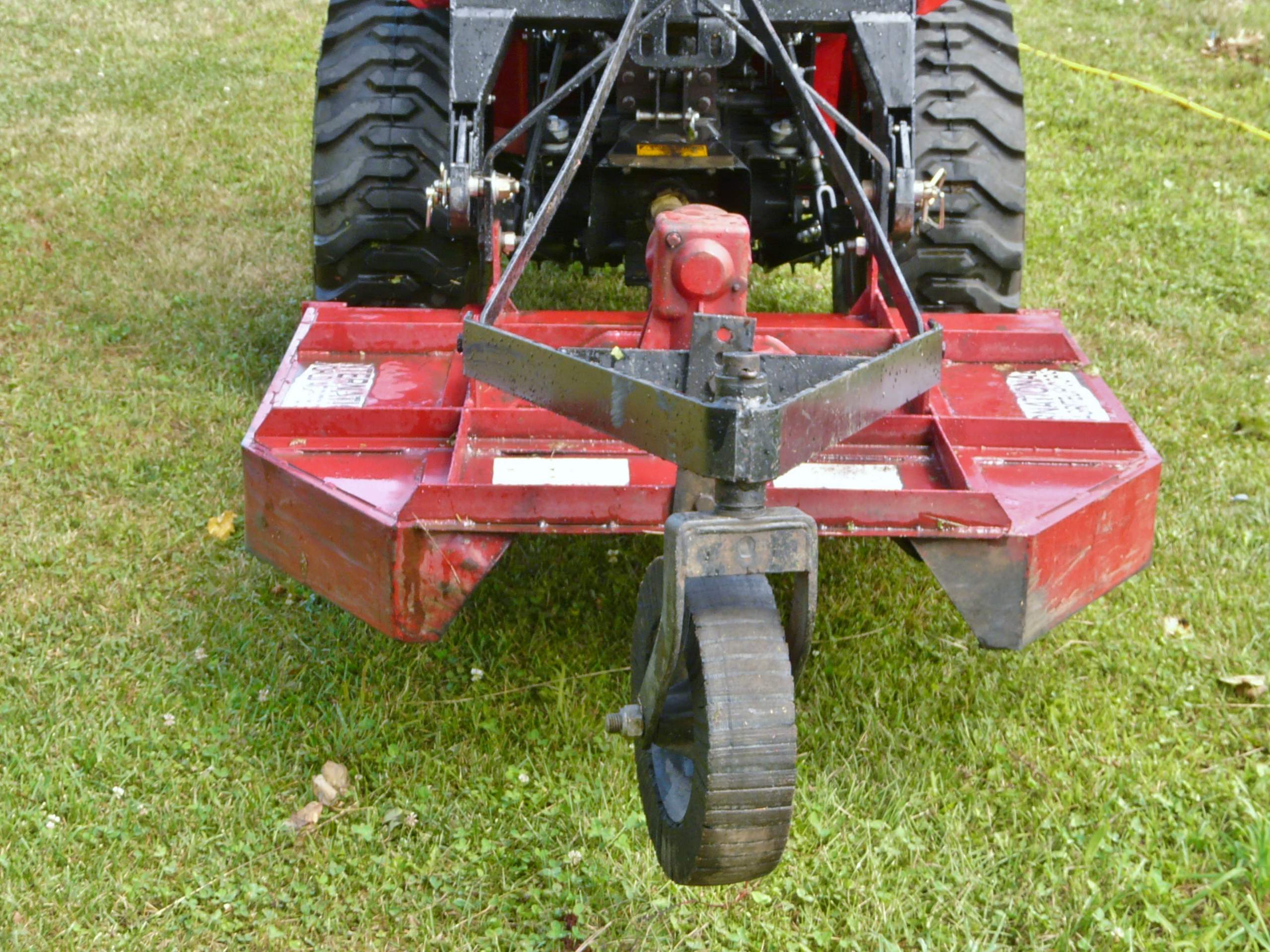

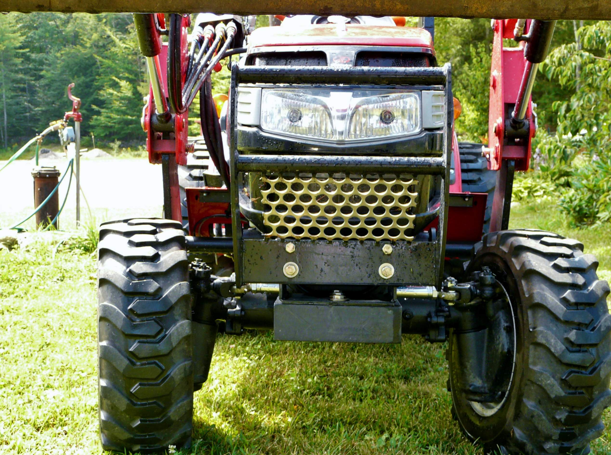

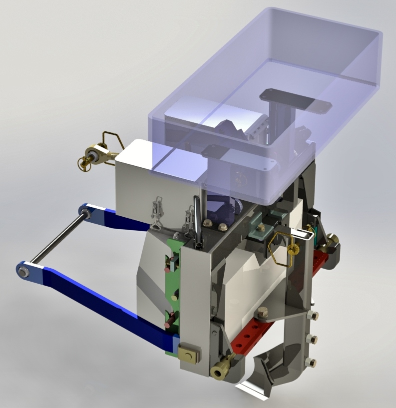

Here are my humble mods, Nothing Crazy.
Pictures attached should explain. The Counter weight has its own thread in Attachments" section.

I haven't had the counter weight issue, however I have a backhoe hanging off of mine most of the time. (additional weight on/in the rear tires however would help with other tasks that don't involve carting around the hoe)
+1 on the cup holder on the 28, that was an extremely narrow-sighted omission. The one from a 26 will probably/likely bolt up to the ROPS if you wanted it, I initially thought the location to be a bit hokey and more of an after-thought, however after some use with the tractor clearing brush in the back 40, I've re-thought that a bit. having it up against the rops cuts down on 'outside incursions to the drinking area' whereas if it were up by the steering wheel or further down on the fender arch by the controls I believe I would've lost many a beverage in the woods.
Speaking of, a skid plate option would be nice, I'll be fabricating one soon assuming the hydraulics and and electronics don't get ripped off the underside before then.
The seat you've got is different from the seat I had on my 28 (backhoe seat is apparently different, at least in the late 2012 models), but it also didn't have a suspension option. The 26 does have some springs in the back and appears to be the same thing as yours, however I find that the seat itself is.. really a giant piece of **** to put it mildly. Don't care for it at all, nor the new(er) mechanism used to articulate the seat to use the backhoe. Relatively small complaint I suppose, but critical to user experience.
I tweaked the bucket on my 28 shortly after I got it, so the 26's got reinforced before it ever saw dirt. the current 26's also have quick attach buckets now. The 26's loader frame seems to be less flexible than the 28's but it's still fairly flexible.
Note my photo with the water bottle on the ROPS.
I've seen many a tractor with a softer underbelly than the Max
Non BH seat is even crappier than the BH seat.
I robbed the suspension off my old Kubota before i sold it
At least it is improved.
what is it about the loader control that you don't like? I've only ever used the one on my old 28 and now my current 26 (they're pretty much the same, although the loader feels faster on the 26 than it did on the 28. could just be perspective after taking a forced 2 month hiatus from tractor work changing), so I have little perspective on that.
Loader control is very abrupt and jerky.
I suspect I'm spoiled by the loader on my L39, and the controls of an excavator, as they have reasonably fine control.
You would much rather have me loading a big dangerous object in the back of your shiny new PU with my excavator or L39. With the Max it would be "Oops, sorry about that"

gotcha. I missed the water bottle whilst looking at the ballast setup on the back
I really like the mods you have made. I will be "stealing" your ideas on a couple.
Thanks!
