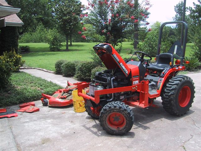

Time for my 50 hr service, changed the engine oil and filter.
I have my Super UDT, HST filter and the hydraulic filter.
The two filters look the same but have different part #s.
Is the HST filter the one next to the transmission strainer?
Thanks Mike
   / 50 hour service B7500 #2
Mike,
Hydr Filter (right when on seat) part#67955-37710 costs 11.11
HST Filter (left when on seat) part#66021-36060 costs $4.42
The 50 hour service is really easy. If you have any other questions just ask. Good luck!
Maxwell ,
You are rite on the price of the filters.
I can now finish the service.
Thanks, Mike
