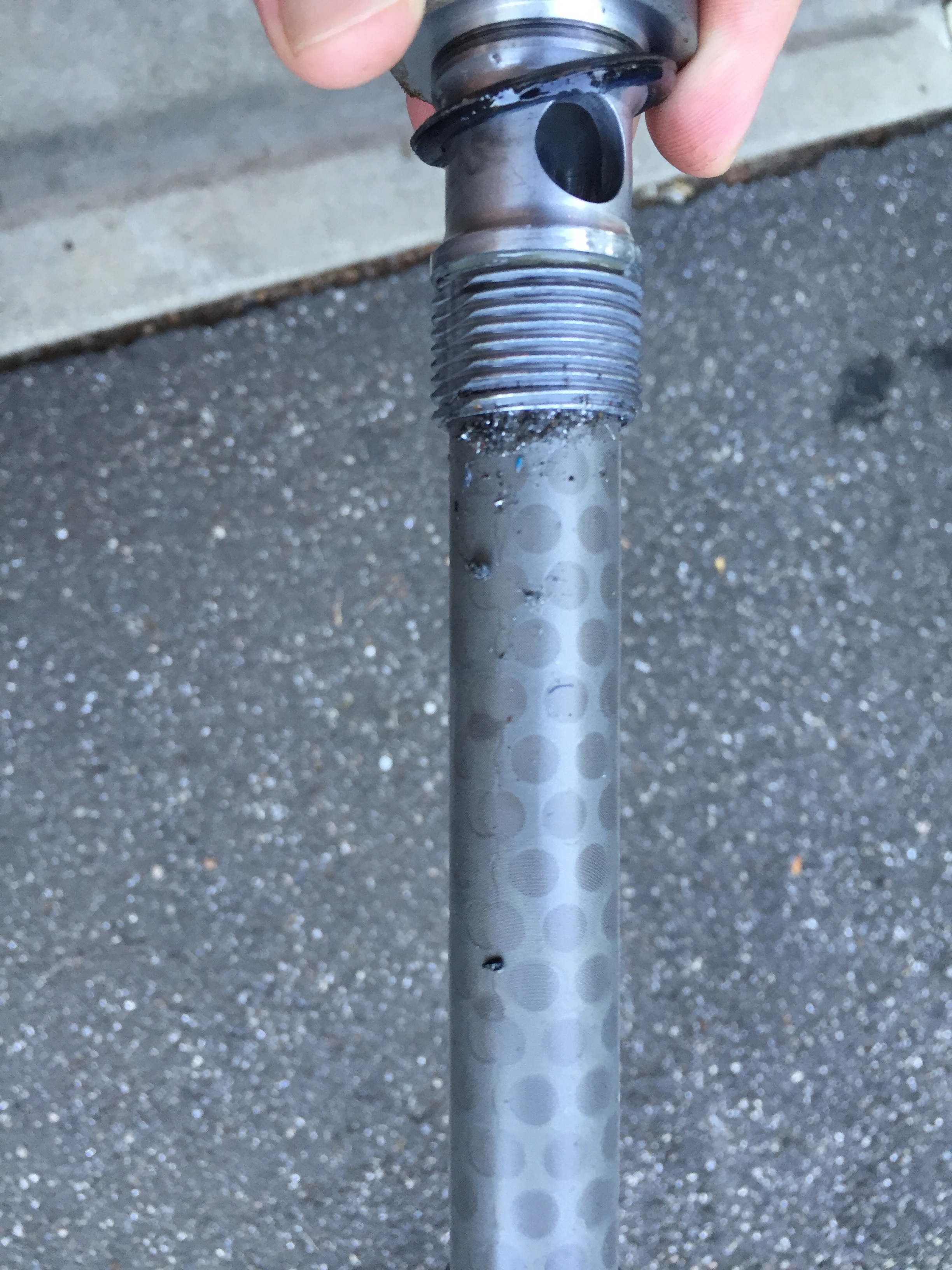

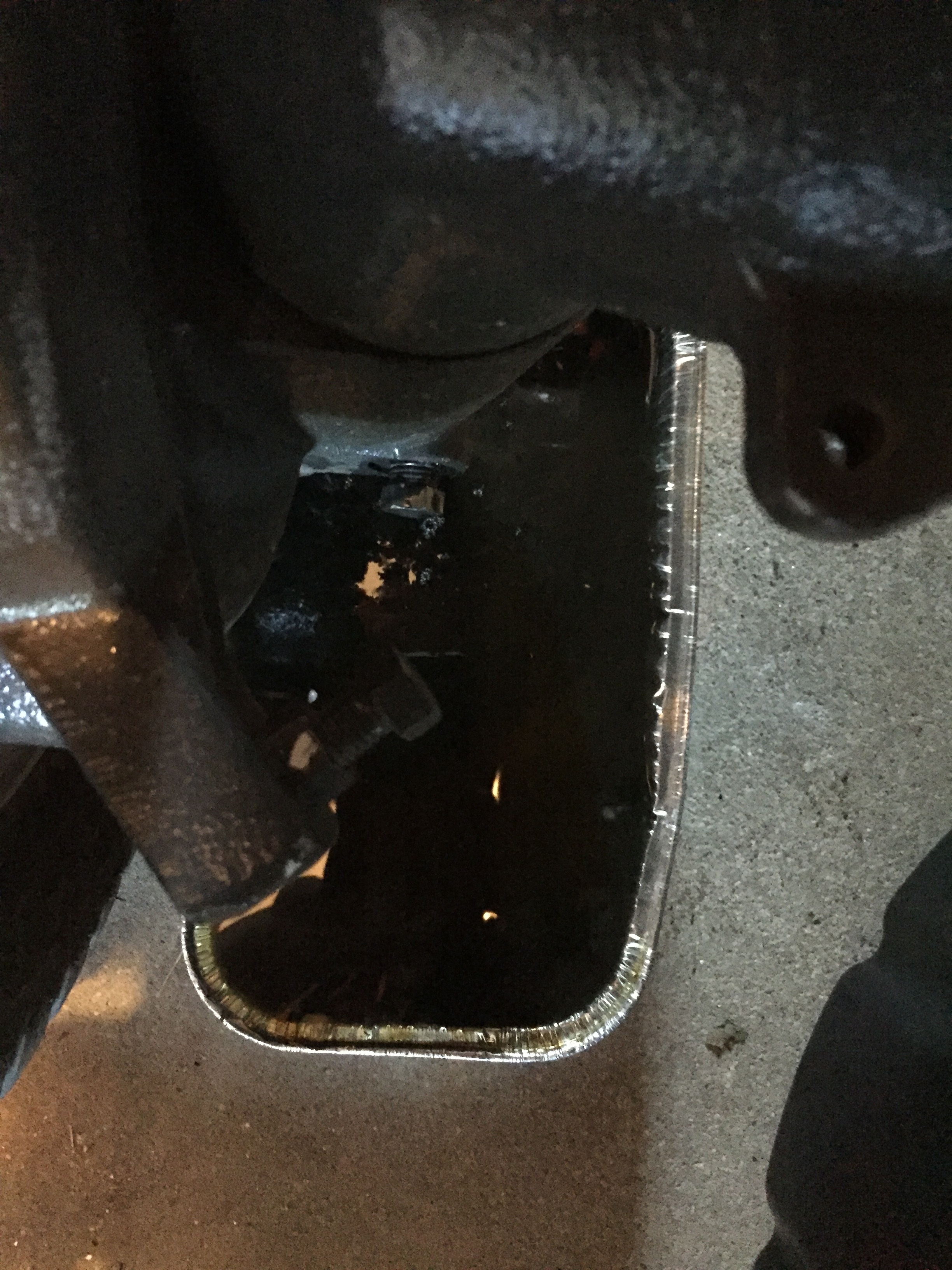

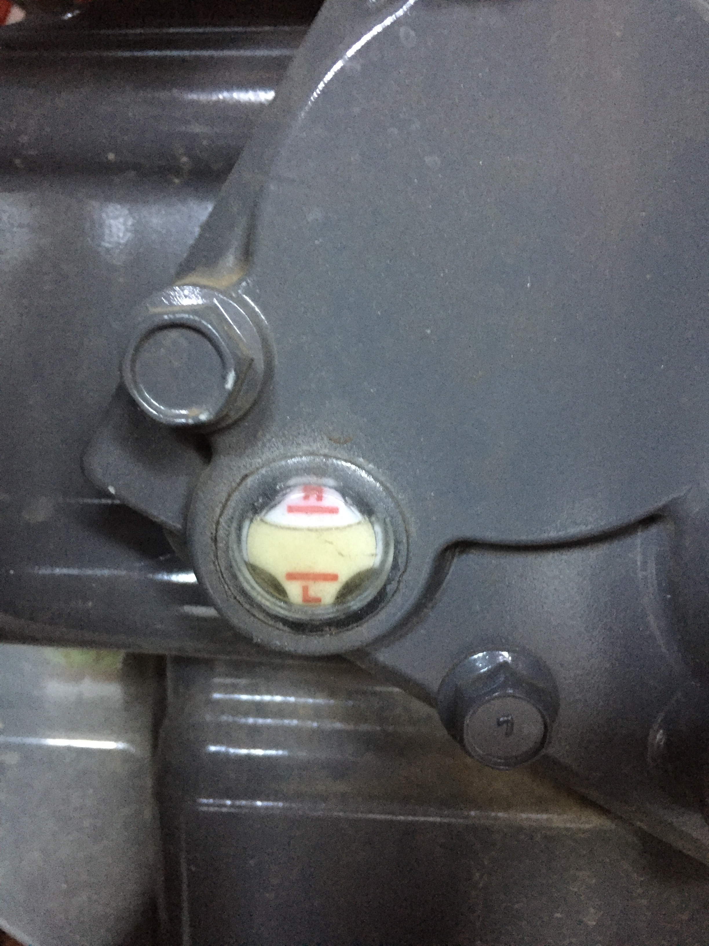

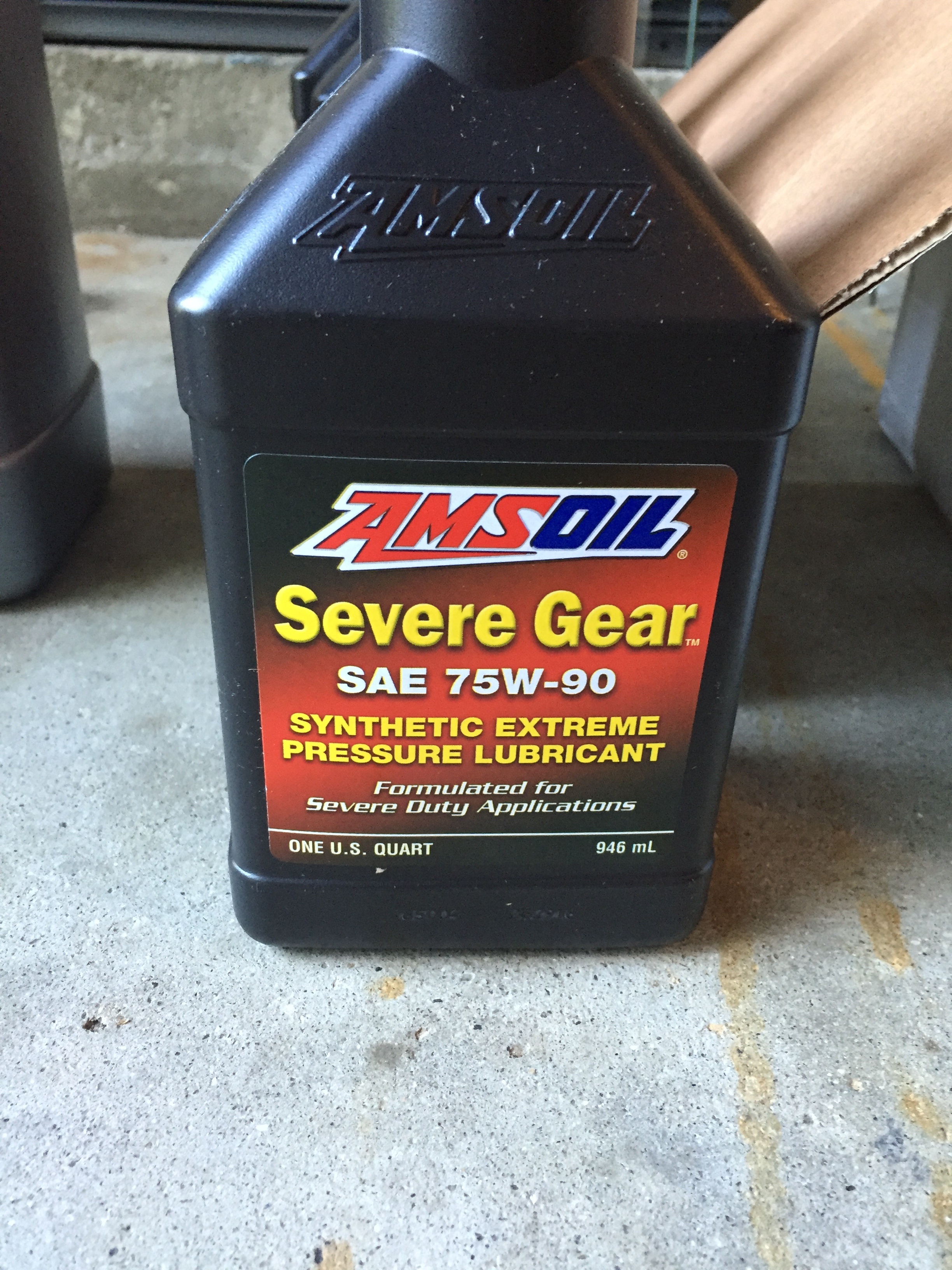

Did the 50 hour service last night, switched over to Amsoil.
ATH int he transmission
SVG in the front axle
ACD in the engine
Bought some grease since I was already placing an order, will probably need to refile my gun in a couple months. Bought an extra quart of SVG which will go into my mower deck gear box at the end of the season.
The only surprise for me was the color of the fluid in the front axle. Was WAY darker than my previous tractor. I think it may just be an indication of how many hours I have been running in 4wd in comparison to the past though. I've been doing quite a lot of the loader and backhoe work.
The hardest part was getting the filled rear tire back on after cleaning out the screen!

I ordered a case (12 quarts) of ATH plus 2 extra single quarts, 5 quarts of SVG, 1 bottle (gallon) of ACD for the engine (smallest it comes in), 2-14oz tubes of GLCCR grease. I signed up for the preferred membership ($10) since I plan on ordering some stuff for my truck as well. Add shipping and tax, and total was $257.01....ouch! I have 2 quarts of ATH and 1 quart of SVG left over, plus about a quart of the engine oil. I used Massey filters from my dealer. I forget the price, but I think they were $30-40 dollars total.
When I didn't the 50 hour service on my GC2400 I used all dealer fluids and filters, and if I recall, the total was about $180. This time is was more like $280...$290. Was it worth it...I don't know...but it makes me fell good...
