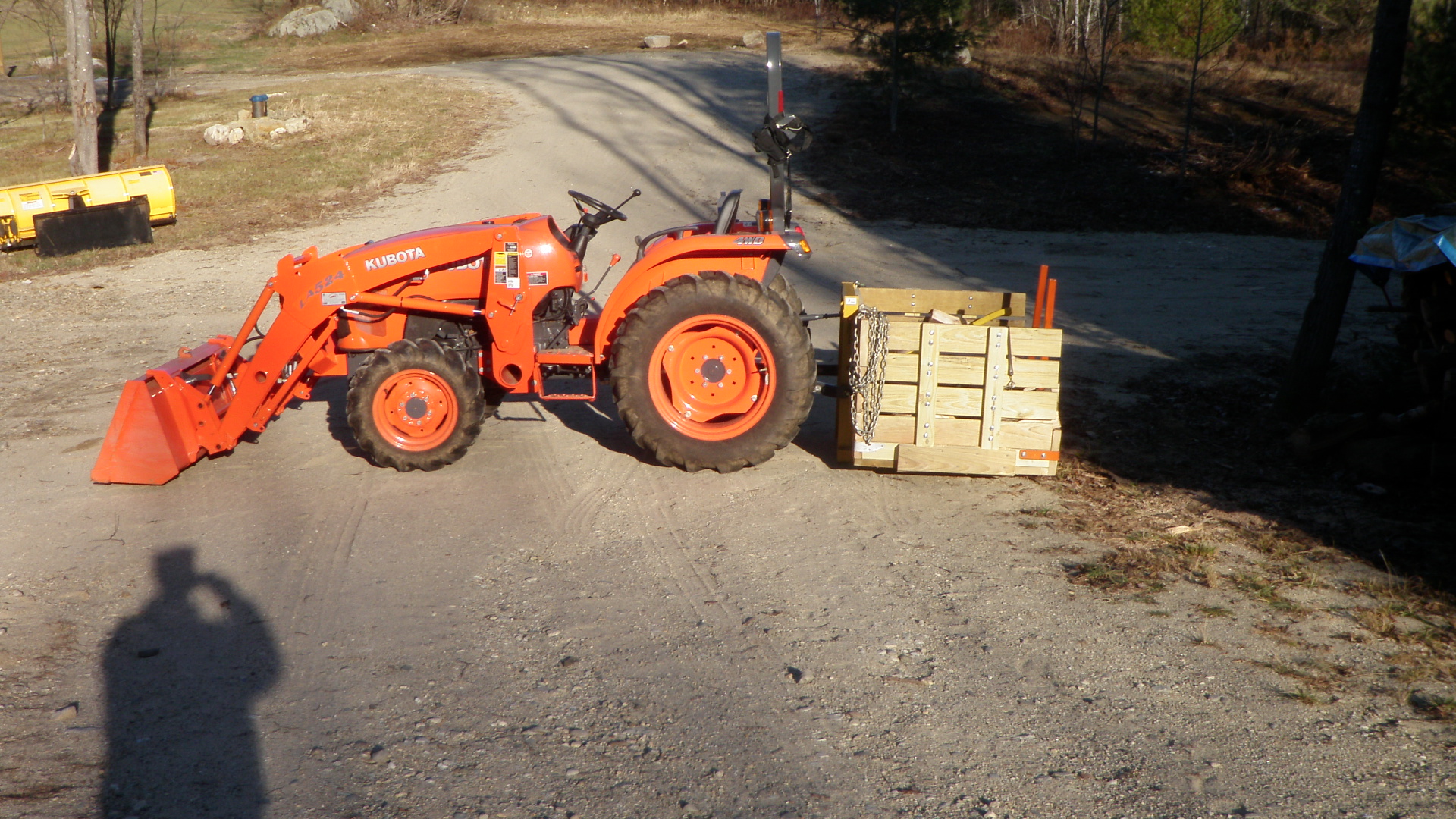

I finally serviced my new L3200 for the 50 hour required components. The oil change was straight forward, although it would have done me justice to let the oil warm a bit as instructed by the boss. The DT manual tranny only requires a hydraulic filter change, so that is what I did, albeit some fluid leaked out as I was changing it, but I was able to pull it off at about a 3 qt loss. I also changed out the fuel line filter(not on schedule), it needed it, pinched the line as instructed by service and reused the 2 "O" rings. The little one was a bear to remove though. I greased all the fitting as per the manual guide, 12 on the loader, 4 on the hind end, 2 on the front pivot bearing, 4 on the tie rods, I think I got them all, but will recheck once again. Did a tire pressure check, (they were all very low) I would say it took about 2.5 hours taking my time, but well worth getting more familiar with my tractor. Noticed that the Hydraulic hoses wore the paint off on the right side, have to look into getting that off the hood. Can't wait too get it back into plowing again when the weather gets colder. I use my tractor more than I use my truck now, but it sure is fun.

Cool! I've always enjoyed taking care of my own stuff... Nice rig ya have there!
