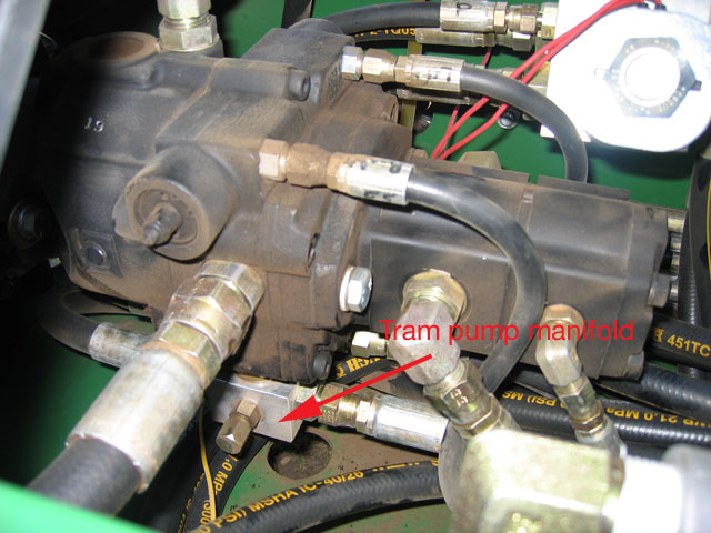

Did you get a bleed hose with your PT? If so, look at the fitting on the end of it. Then look for a cap on an opposite sex fitting on the tram pump. It is there, you just have to find it. /forums/images/graemlins/crazy.gif

Yup. Have the hose. Still can't find a fitting with a cap! I'll post some pix as soon as I move everything back in the garage.
Edit: Let me rephrase that. I can find TWO fittings with brass caps. They are located under the tram pump in each of TWO machined alum. blocks that PT calls "Tram Pump Manifold." This is completely (as in 1000%) different from what PT indicates in my manual. I'll scan that page and attach it so you can better understand my confusion.
Edit: Added photo of tram pump manifold.

YIKES! Not the same pump in both pictures. My pump has the brass cap onthe side of the pump, not on a manifold. Yours is different in that the hydraulic hoses on top appear to control the variable volume pump, while mine has a lever run by a cable. Sounds like your only hope is to call Power Trac and have them talk you through it. /forums/images/graemlins/crazy.gif
