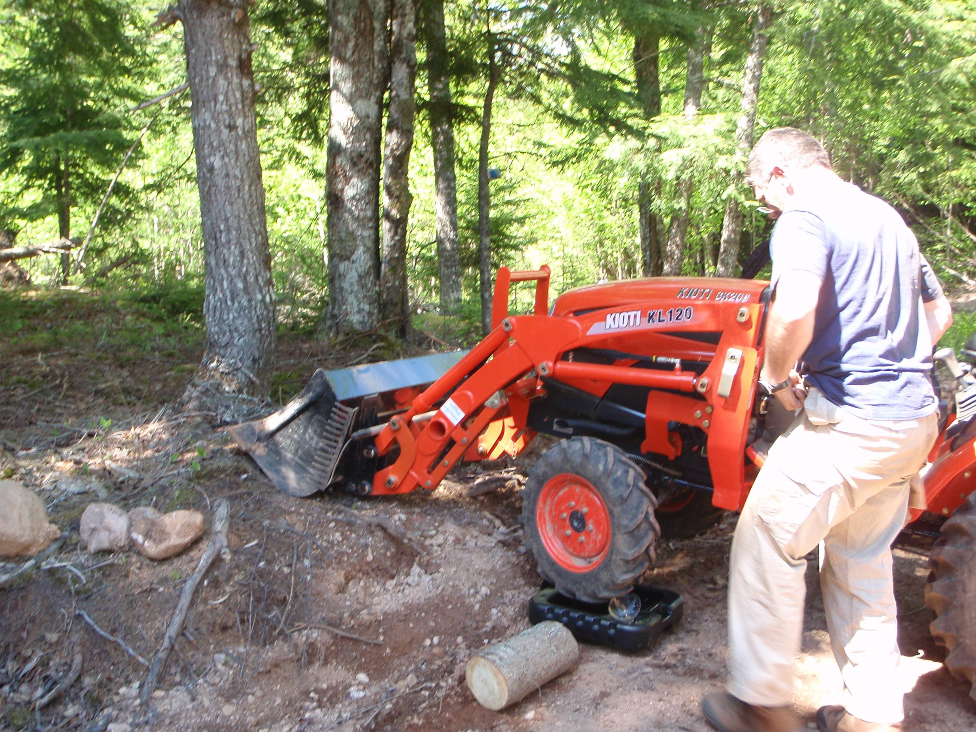

I tackled the 50 hr service this weekend, weather was good, bugs were bad and I had everything I needed. Things went great until the tran oil filter. What fricking hamfisted gorilla put that thing on? I wrecked a strap wrench and several layers of valuable finger skin trying. Then I tried the time tested hammer a screwdriver thru it....bent the driver. Finally, after an hour or so of cursing, thinking and damning the person who installed it I tried a 3/8 18" rachet extension with a pipe on it....it moved...I'd won..without going for a hammer.
I had to be a little creative with the front axle part. I didn't want a 3 l puddle of oil messing up my Eden so I had to figure a way to (reasonably) safely lift the front up enough to get a pan under the front tires. I'm sure there are a bunch of better ways to do this but this worked.

Yeah those front axle drains aren't in the best of locations. I just did the 400 hour service on my tractor. For the front axle, I just lifted it with loader.
The problem for me is the tranny oil (manual). It comes out so fast my drain pans can't keep up with their tiny little holes. Next time, I'm going to find another way.
