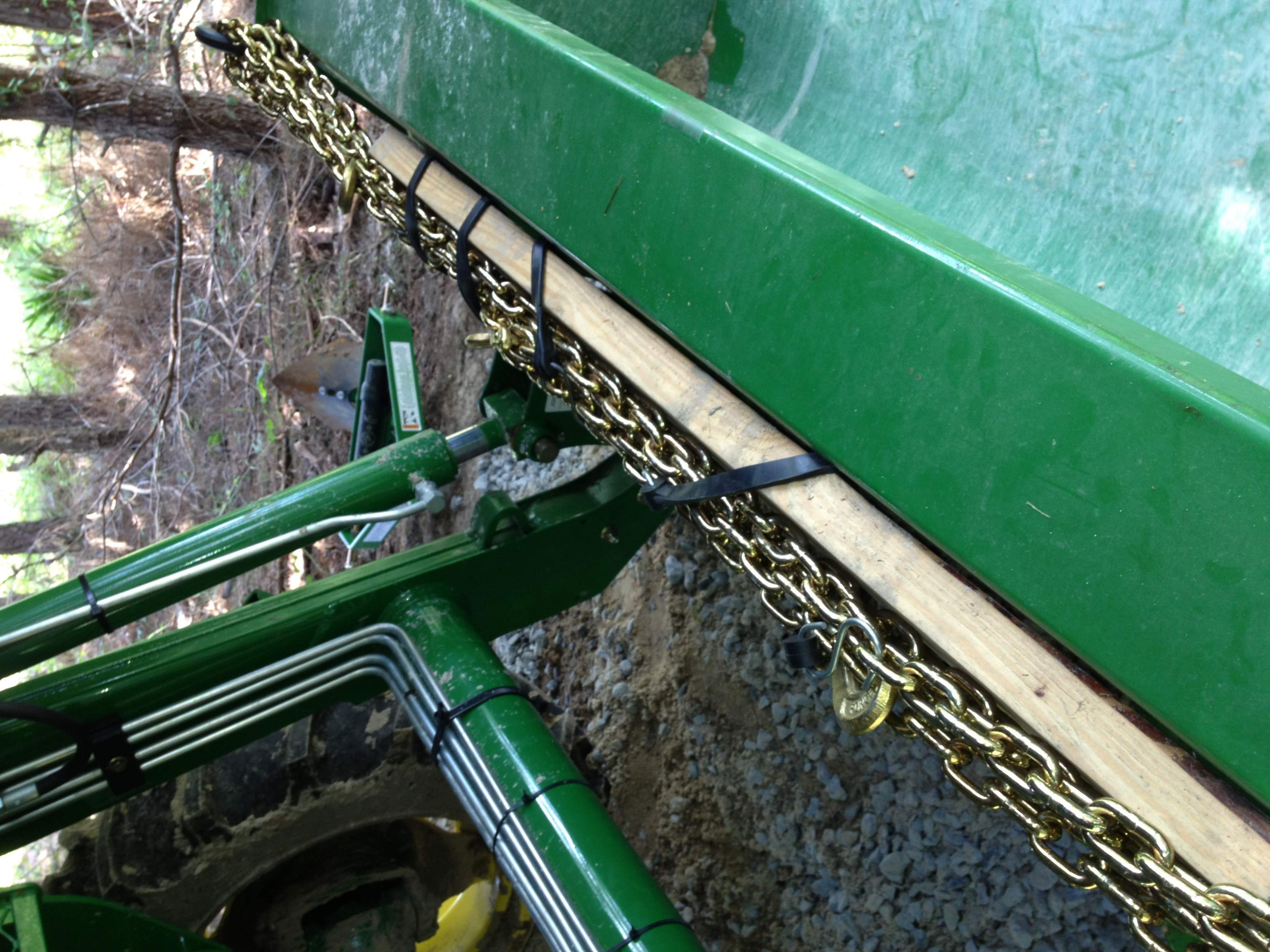

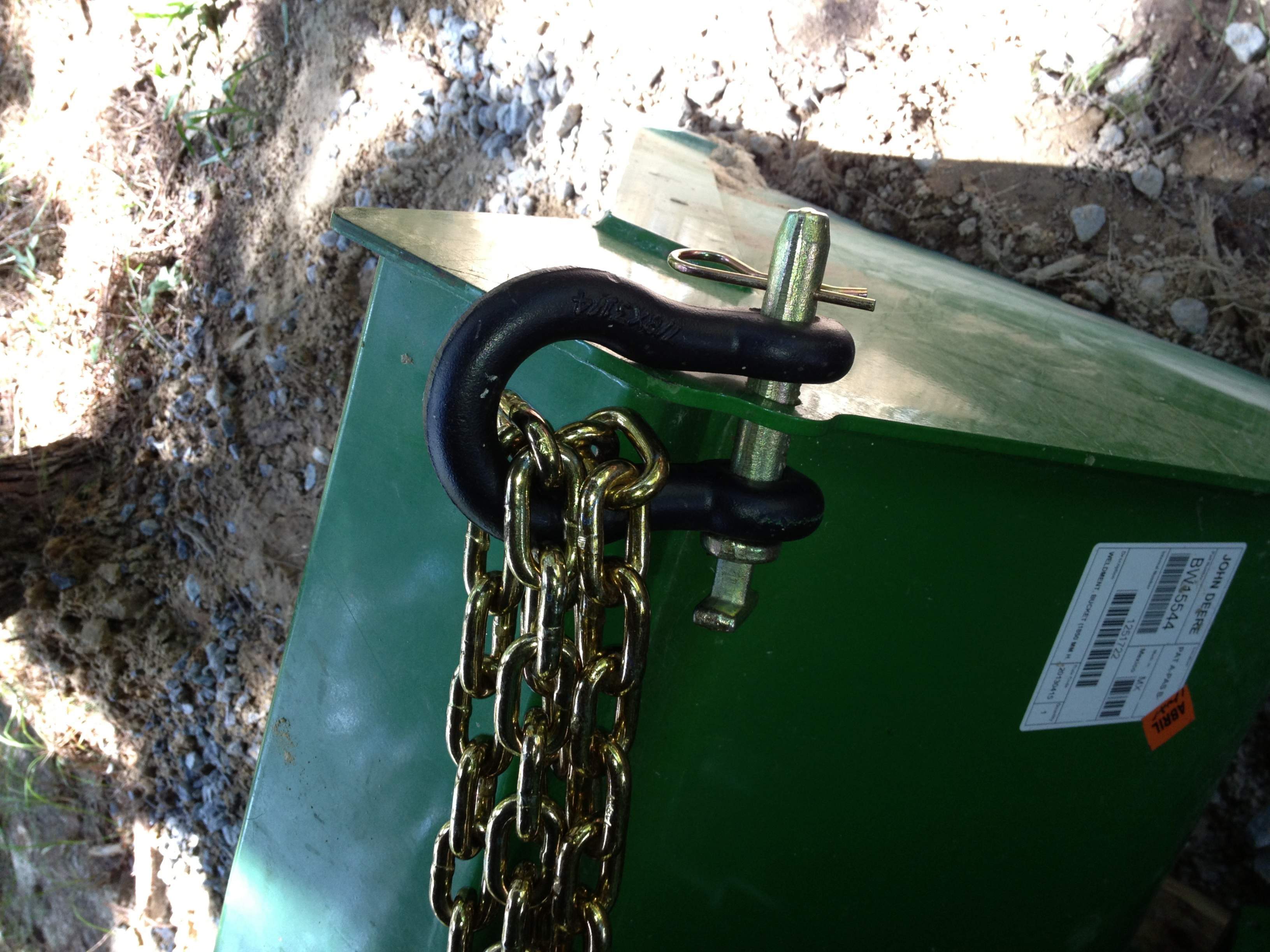

I attached 2, 14 ft long (5/16", Gr 70) chains to the top of my HD bucket. I used 2, 3/4" diameter clevis inserted thru the holes intended for a grapple, which I do not currently have. It is a handy location and they will always be with machine.
   / 5065e- tow chain storage
#2
I put a 2x4 behind the chains and secured with bungee cords so the chains would not rattle

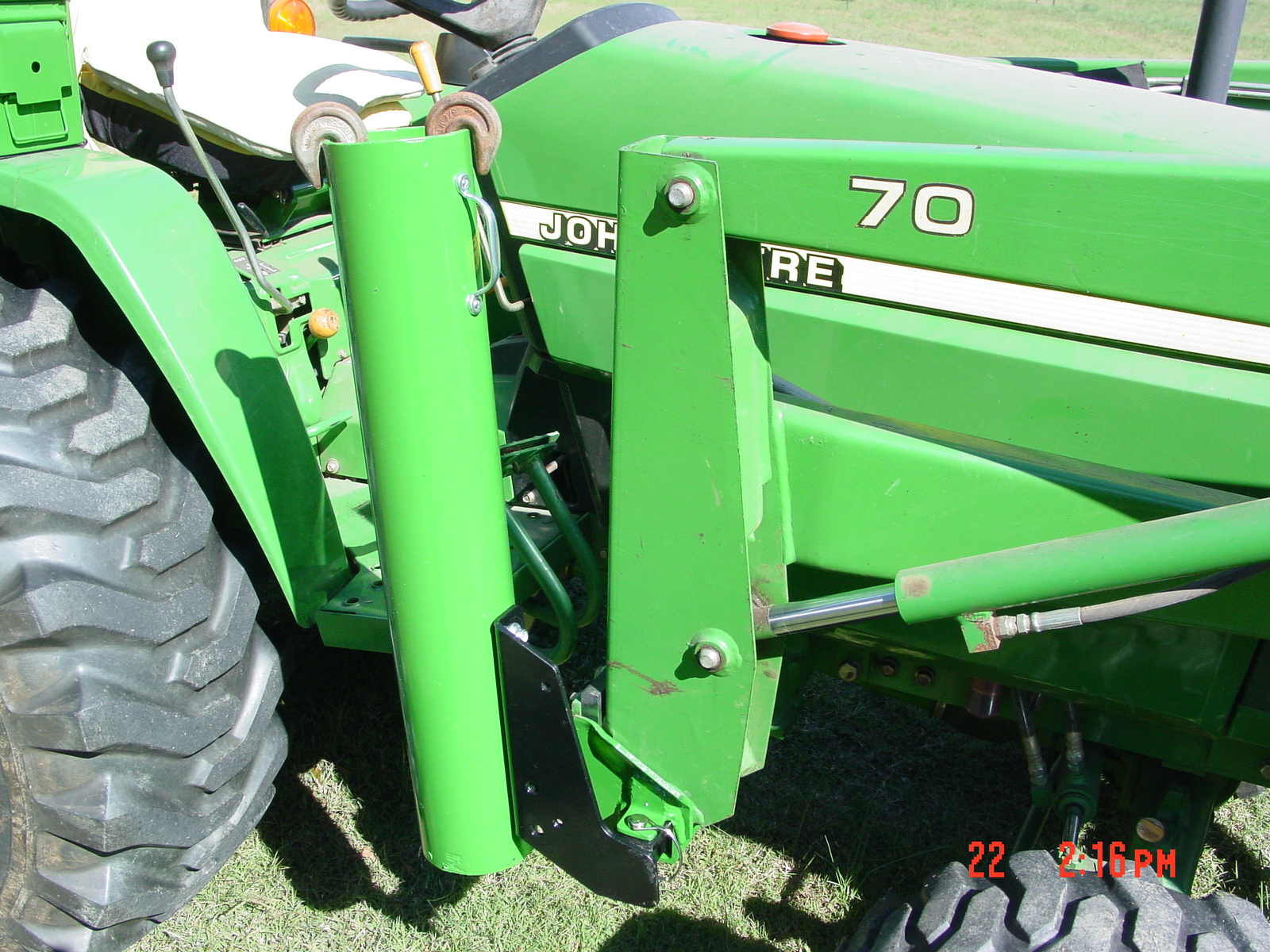

I fabbed up a "chain bucket" which is made of a piece of 4" dia PVC that was bolted to a mounting bracket for a 2" reese hitch. This bracket slides into a mating bracket that is part of what the FEL mounts to the tractor with. This way, I can remove it whenever I need to.
Maybe you could come up with a similar design that attaches to your loader mast or maybe somewhere on the tractor? Your idea works, but like fatslob indicated, it seems to be a lot of effort every time you want to use it.
