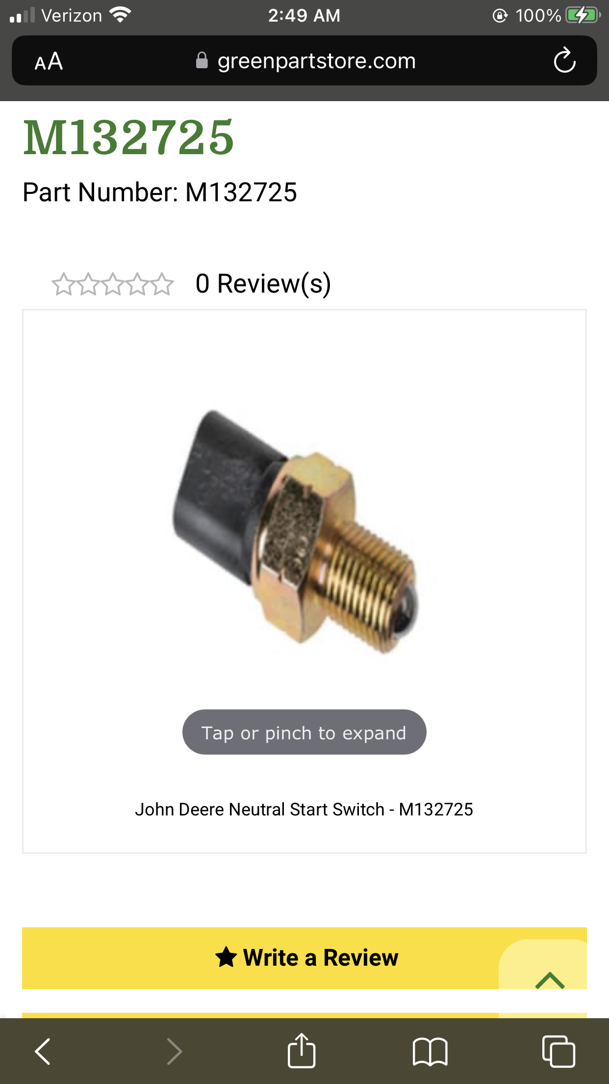

Update in case anyone ever comes across this problem, the fix was to replace the neutral sensor, M132725

Items Needed: M132725 Neutral Safety Switch (test before opening package!)
R26448 Switch Sealing O-Ring
RE45864 Hydraulic Filter
1 gallon John Deere Hy-Tran Hydraulic Fluid

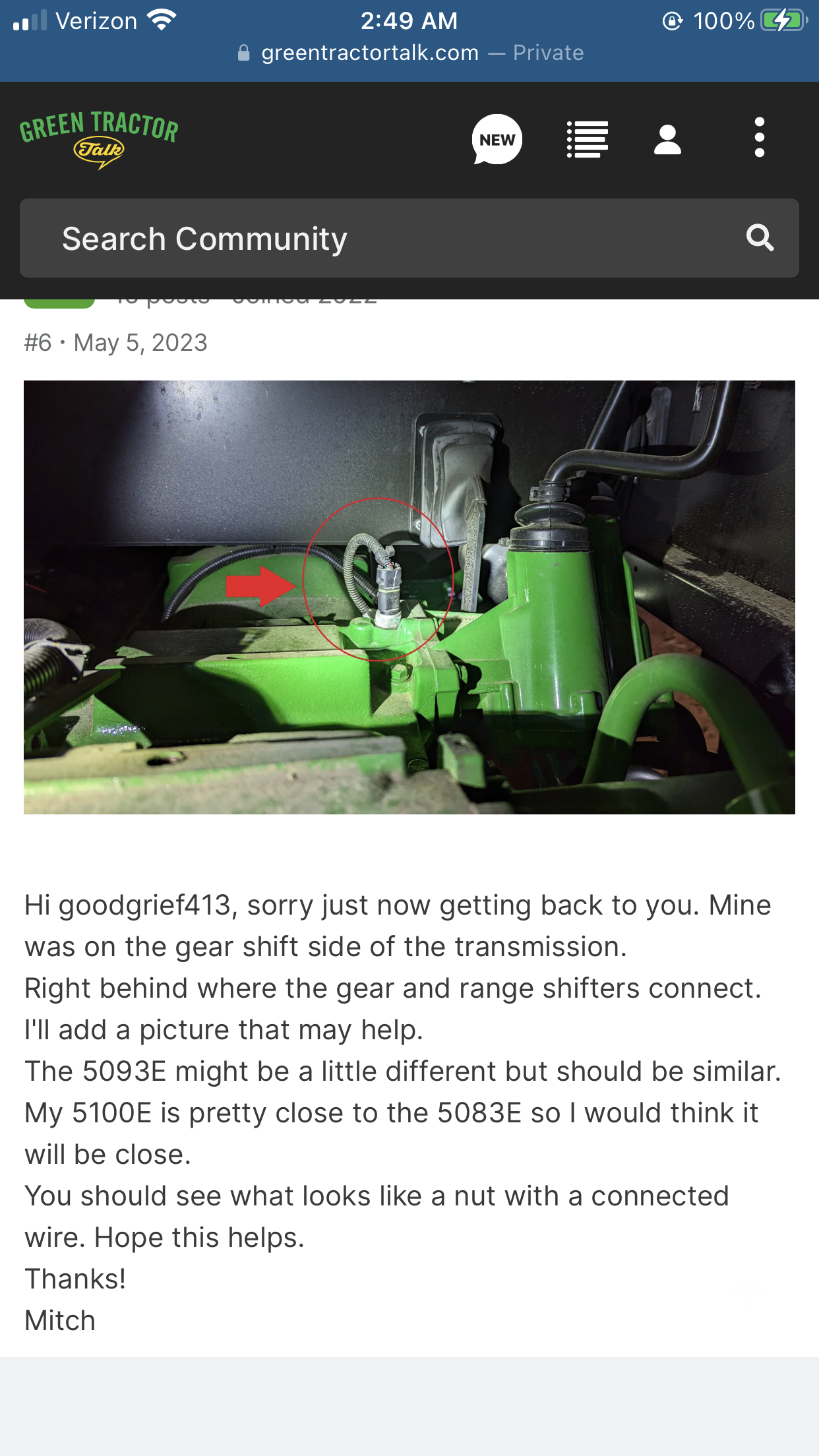

Where was this neutral safety switch located on your 5085E ?
   / 5085E not wanting to move when first starting. #5
I have the diagram from the dealer but I'm struggling to find the location. Did you ever find it?
   / 5085E not wanting to move when first starting. #6
   / 5085E not wanting to move when first starting. #7
No personal knowledge, but a google search showed these two pics, if they are any help.
