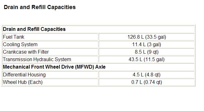

Interesting. But worth looking into ASAP. Surely it takes more oil than what you put in.
The manual on line for the 5093e shows 9 qt of engine oil, if filter is changed.

I reread my post and see I made a mistake. I put in 10 quarts. Going by the manual on line 9 quarts might be right. I still would like to hear from anyone that has changed thier oil in a 2012e.
   / 5093e oil change #6
I just changed mine and it took a little less then 10L.
